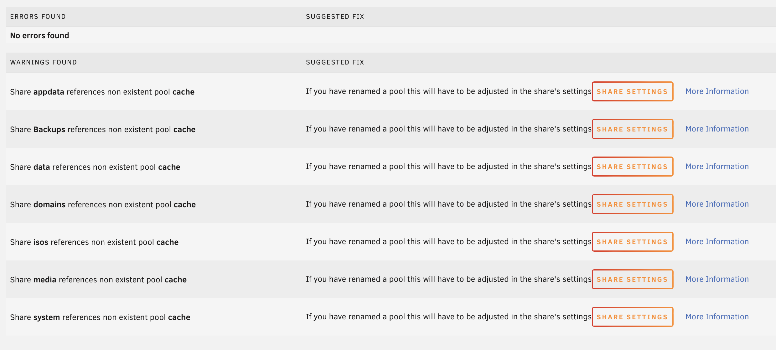

Fix Common Problems is reporting a "Cache unmountable: wrong or no filesystem" warning for all of my shares. Attaching diagnostics
I am running the latest stable build of unRAID (6.11.5). I'm not sure what do do/check. My cache drive is an NVME SSD, about 2 or 3 years old. For the past few months I've been getting errors every few weeks saying that the cache was full or read-only, but neither was the case so I'd reboot and that seemed to solve the issue. Today I did the same and now getting the below warnings.

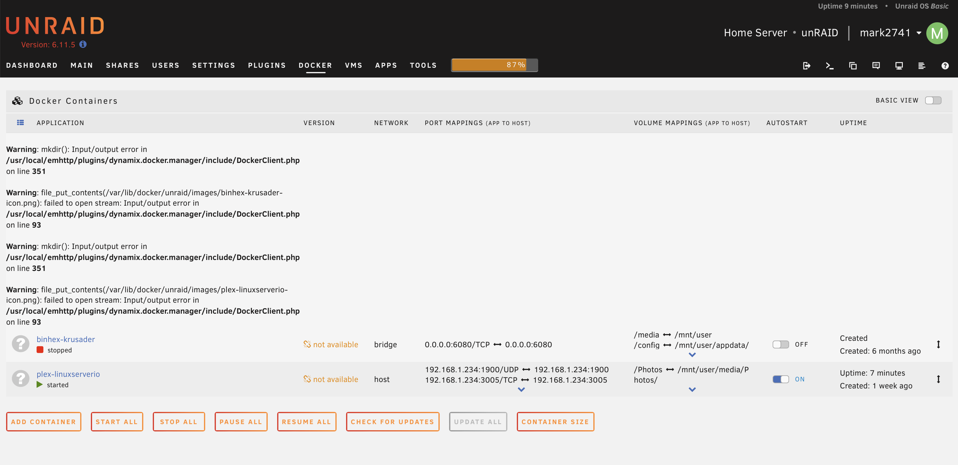

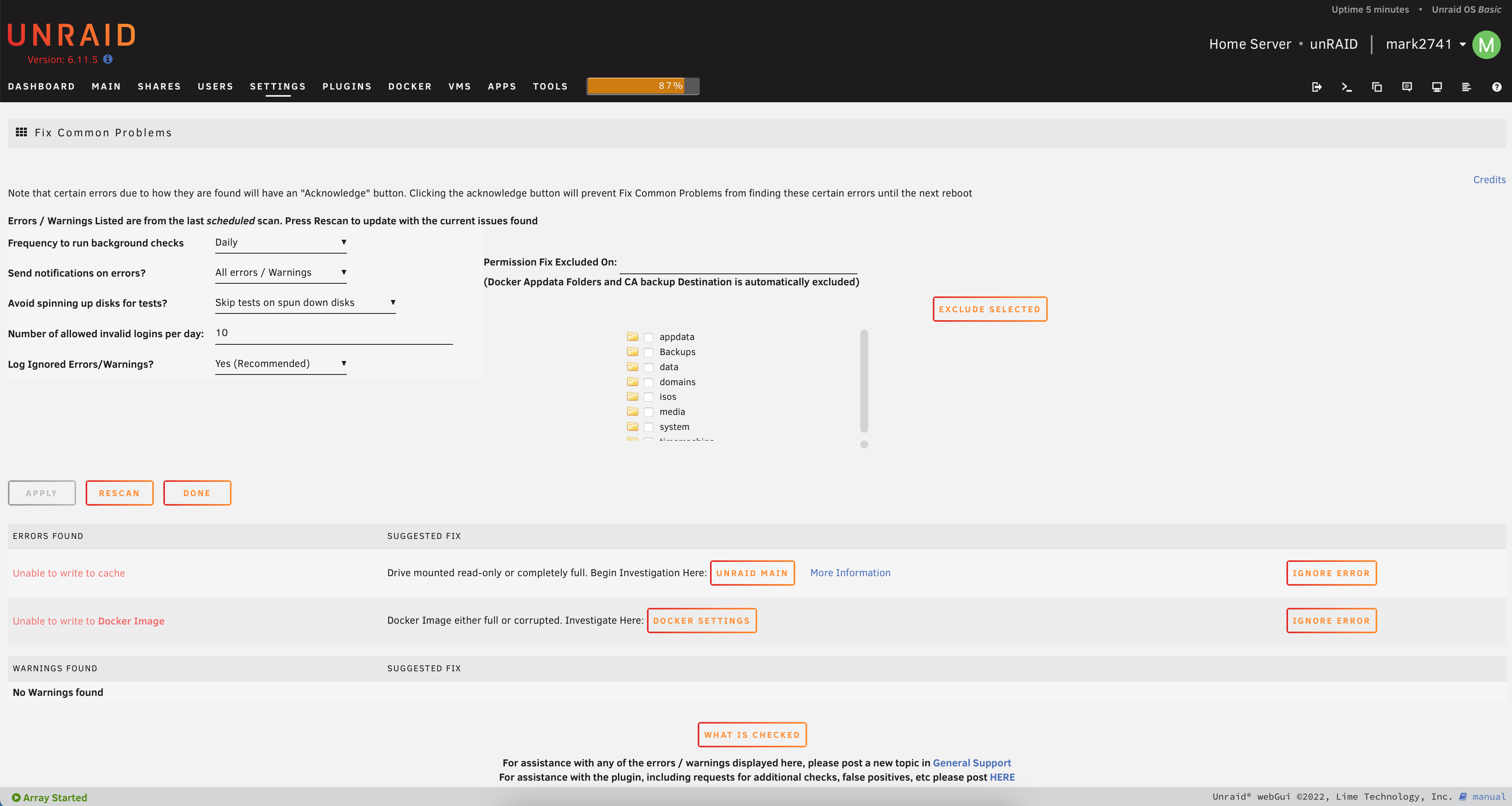

Thank you @JorgeB. I ran that command and then did a reboot and it seems to have cleared the prior warnings. But now am seeing the errors below again when I run FCP. This is what I saw before a couple or few times over the last few months, but a reboot would (temporarily) seem to fix it.
338450952_CleanShot2023-05-30at08_49_49@2x.thumb.png.cfce02600da1329010b395b737c5b22b.png
Looking at the Docker page I see these:
853461615_CleanShot2023-05-30at08_52.47@2x.thumb.png.cf4ab8fda86d95eb6a0b0c569ee0d48e.png

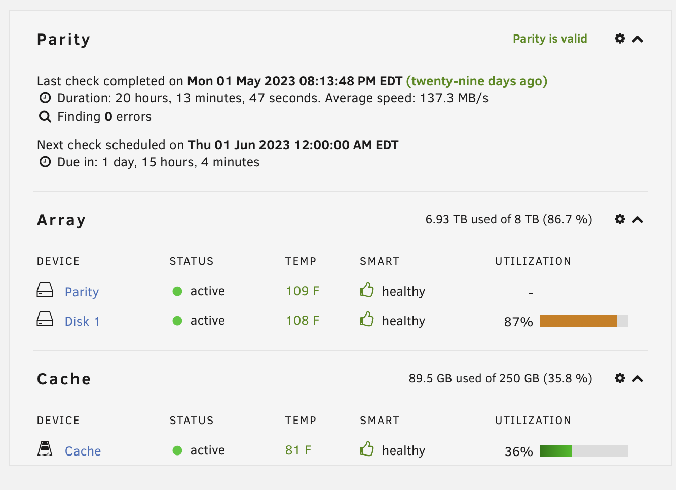

The cache has plenty of spare space:
1949338036_CleanShot2023-05-30at08_55.41@2x.thumb.png.07b5abc7bd2aef4dd4920fb86f7a27bb.png

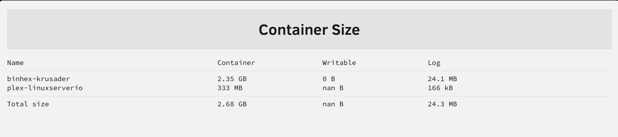

When I click the Container Size button I see these, which doesn't look right to my unskilled eye:
805632877_CleanShot2023-05-30at08_55.08@2x.thumb.png.5587a8c63be06e29ce42353b7b7be2cb.png
