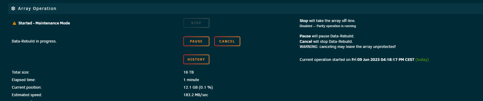

It's rebuilding now.
I'll give an update tomorrow when it's done.
Many thanks for the great help!
The rebuild has succesfully completed!
