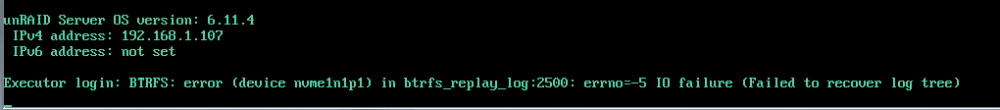

My Unraid server was non-responsive so I had to force reboot via IPMI. Upon reboot, I am getting the following error and the docker tab is showing no docker containers installed:
BTRFS: error (device nvme1n1p1) in btrfs_replay_log:2500: errno=-5 IO failure (Failed to recover log tree)

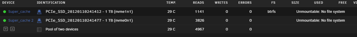

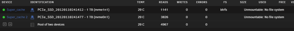

EDIT: Here is another clue. The cache pool on which docker.img lives is showing unmountable:

If the log tree is the only issue this may help:
btrfs rescue zero-log /dev/nvme1n1p1
Then re-start array.
Should I stop the array first before running this command?
You can run with the array running since the pool in not mounted.
That did it. Thank you @JorgeB. :D
Do you recommend running a scrub on the cache pool?
You can run a scrub, also take the opportunity to make sure backups are up to date.
