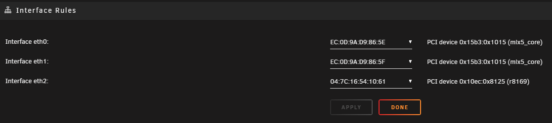

Hi I added a Mellanox 10gb card with 2 ports 2 my server and connected it to my router and thought it would be a simple swap. However after changing the interface rules to make eth0 the 10gb connection. WAN speeds are super slow I have 1gb down but only getting around 100mbps

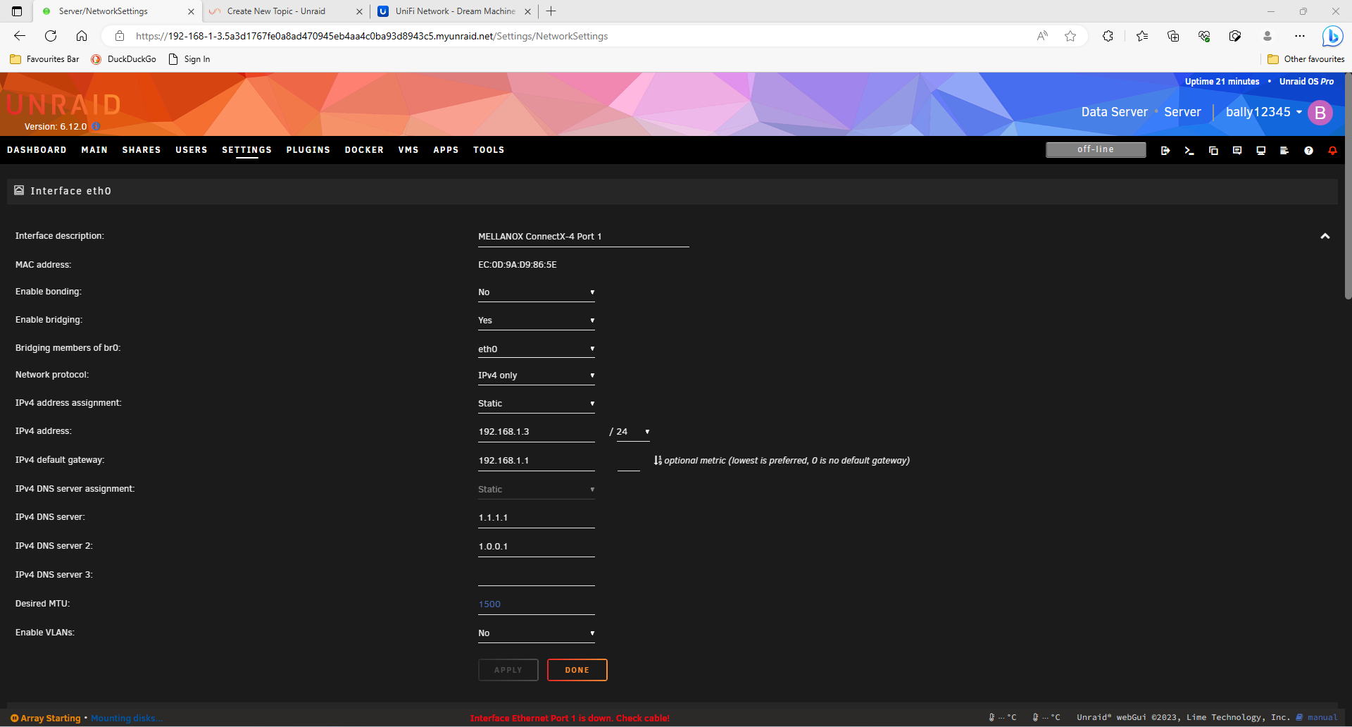

This is what my Network settings page looks like
Am I setting this up wrong? Dont know if it makes a difference but I updated the firmware using Mellanox plugin. DIdnt see any change.

Silly mistake, was running speedtest cli without array started, once started got full speed I was expecting. My 2nd server is not setup yet to test between 2 10gb links
