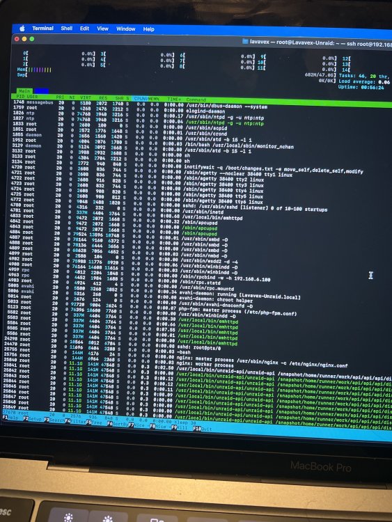

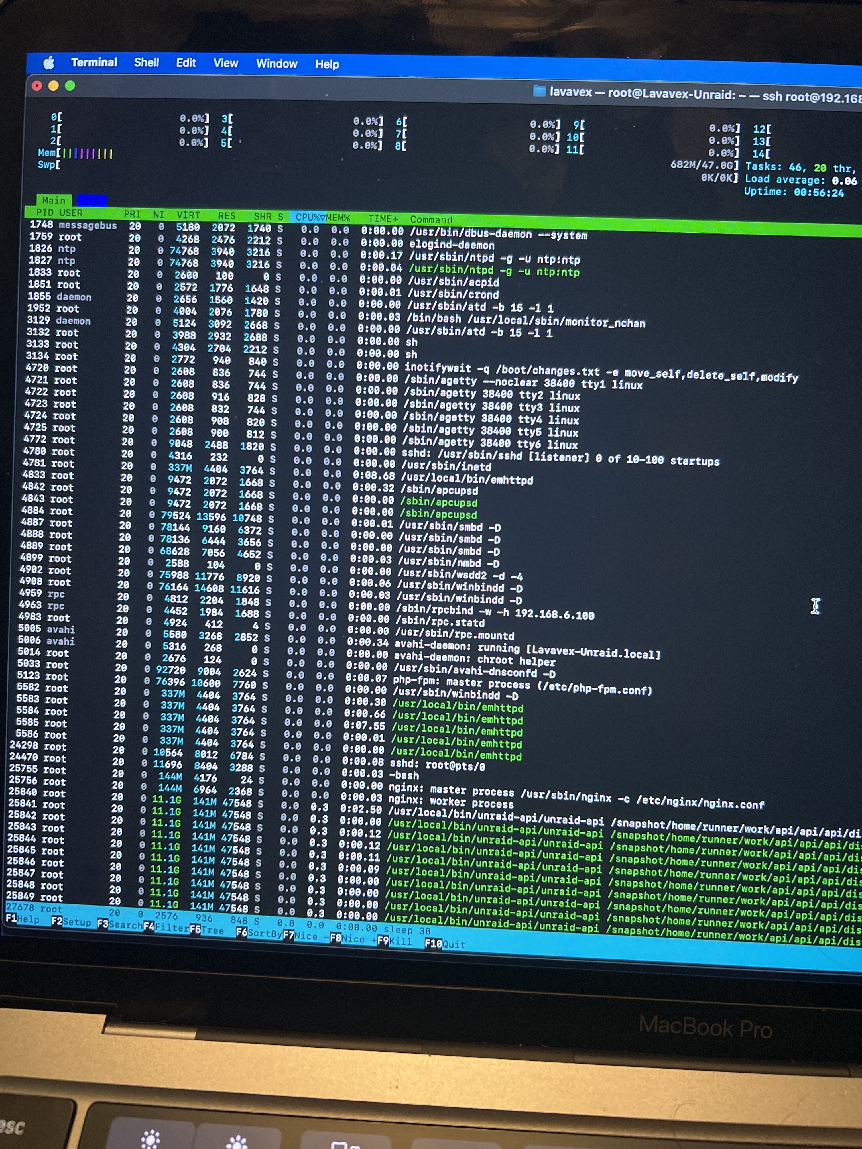

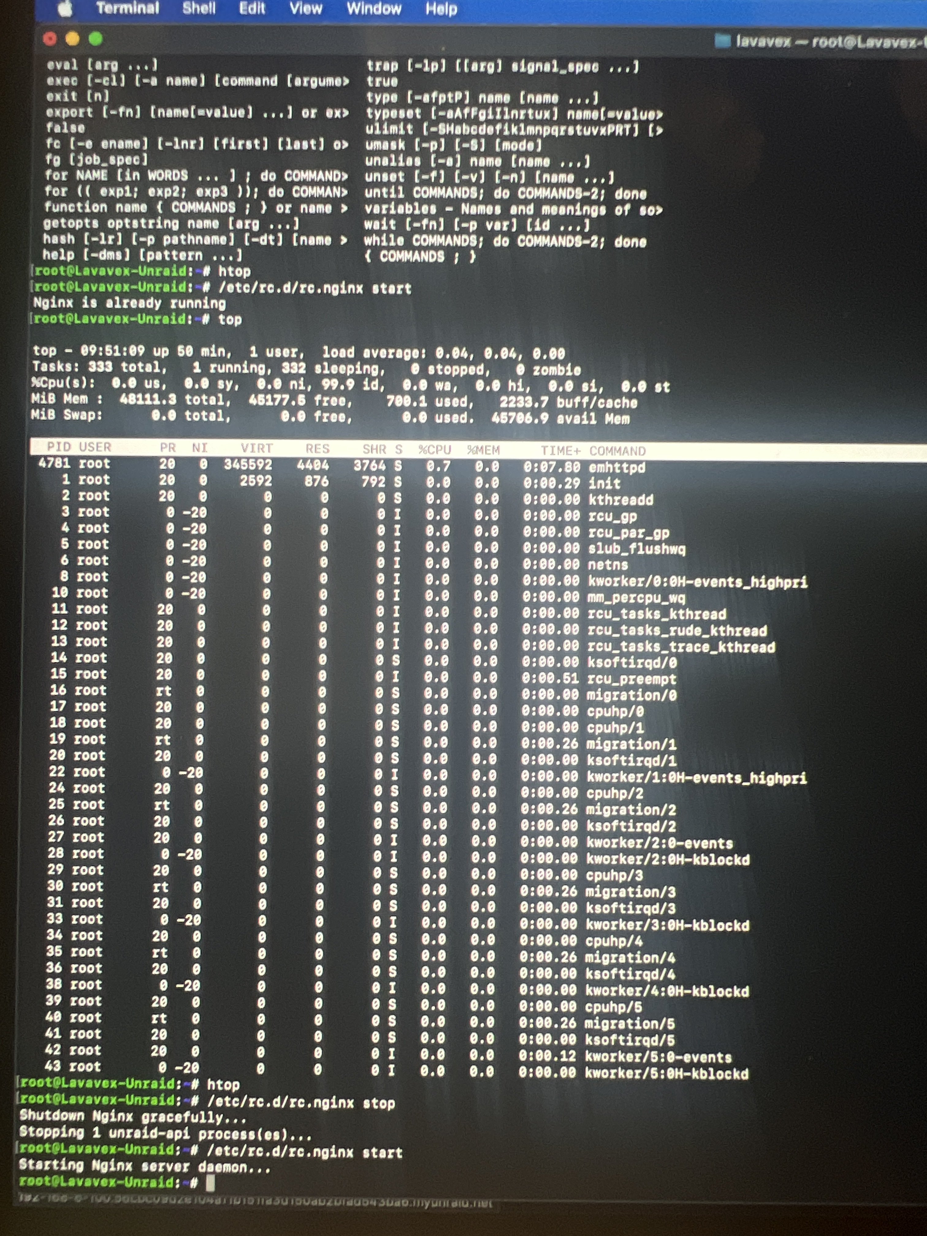

I’m having same issue on 6.12.2, running the command says Nginx is already started and stopping the service then starting again does not work. Let me know if anything else is needed.image.thumb.jpg.ac3b94bf9fdbf4ada8925d36ca190396.jpg
