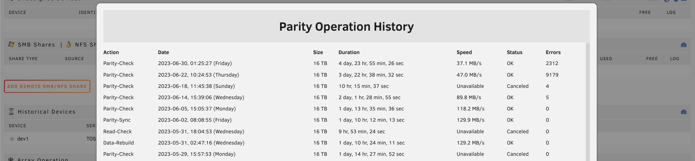

I have my server set up to do a weekly parity check. The last two have been incredibly slow(it barely finishes before the next scheduled parity check starts). In particular when reading my 4TB drives. On top of that, it is finding thousands of errors.
I am writing a lot to the array while the check is running, but this was never an issue in the past.
The issues seem to have started after having a power cut during a parity check a couple of weeks ago.
All disks pass smart checks and everything else seems to work normal on the server.
When you look at the log, please ignore the high temperature warnings. I have new fans waiting to be installed, but I am working abroad and wont be home for another two months(operating the server through Wireguard).
I have not been able to make a full diagnostics file, as my VPN tunnel somehow glitches while it is making the file, every time. But i have attached a system log and a photo of the recent parity check history.

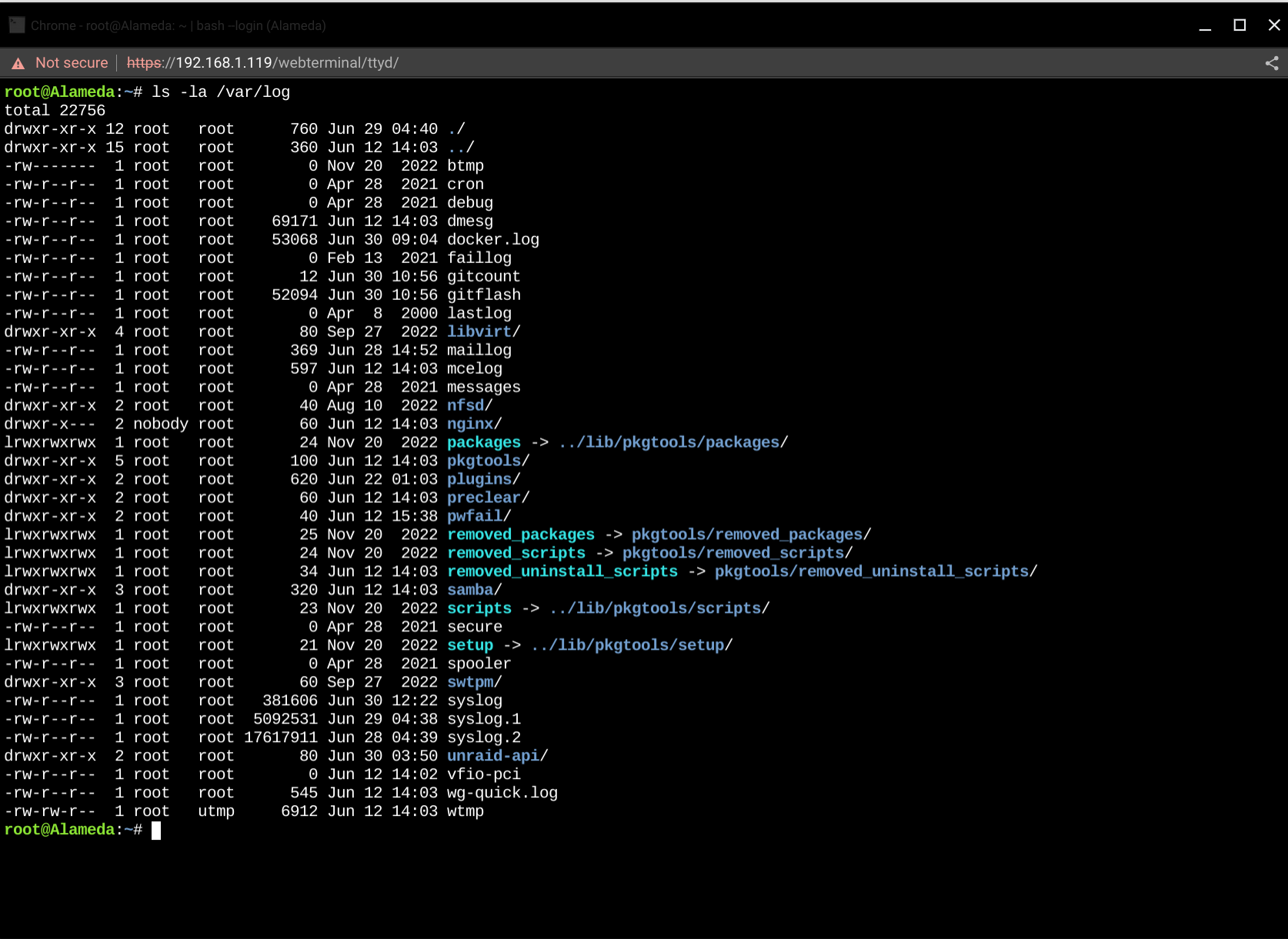

Post the output of:
ls -la /var/log
15 minutes ago, JorgeB said:
Post the output of:
ls -la /var/log
Sorry, I am a total noob when it comes to command line. I see the two syslog files, but i have no idea how to download them for you.
cp /var/log/syslog.1 /boot/syslog1.txt
cp /var/log/syslog.2 /boot/syslog2.txt
Then you can get them from the flash drive.

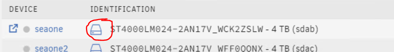

Click this for each device:
It will open the log just for that device, look for the one that mentions ATA4 repeatedly.
