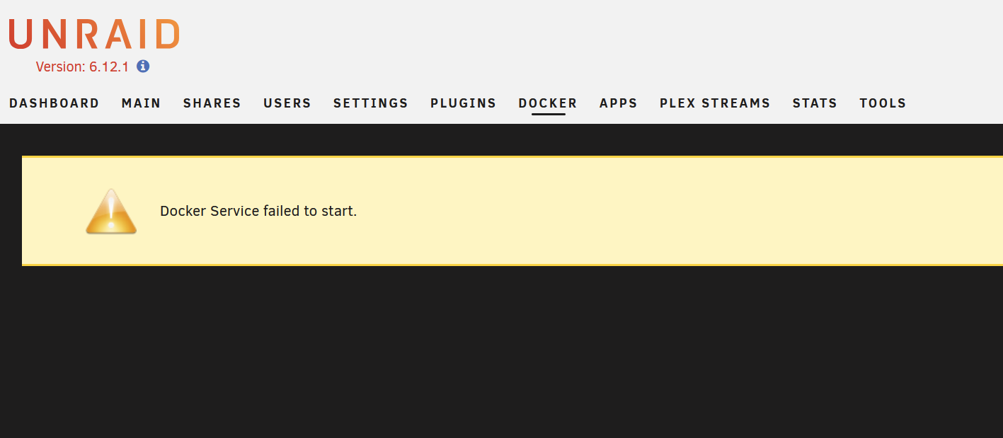

I try to enable docker and notice that's an error Docker Fail to Start.

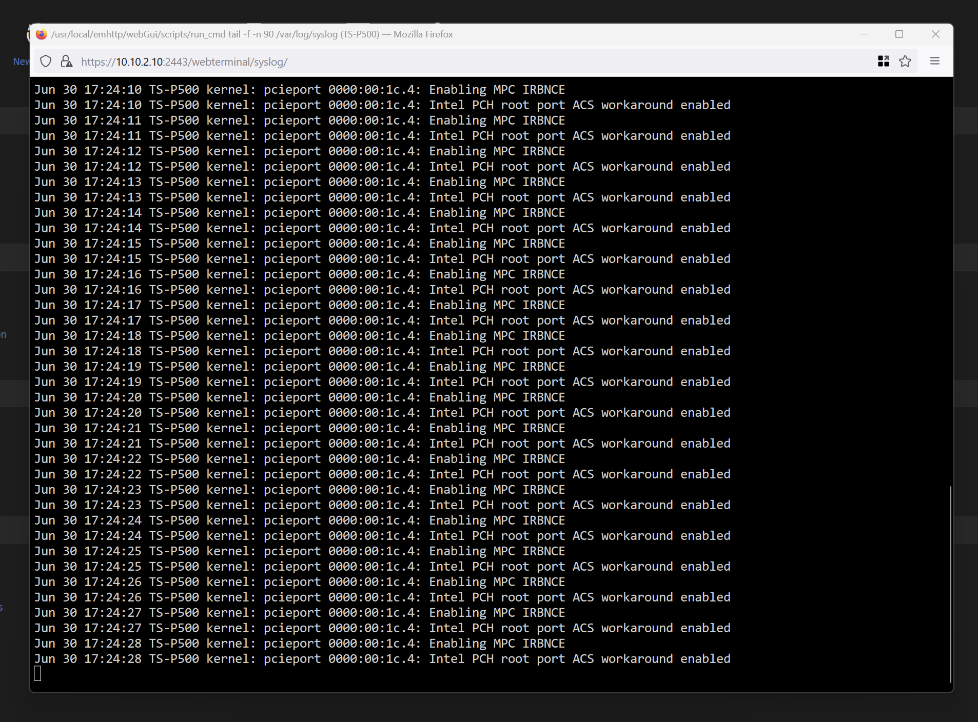

Also when i open the syslog i notice its full of error Intel PCH root port ACS workaround enabled.

With all that log spam cannot see anything about why docker is failing, is this a new error? Also look for a BIOS update.
No new bios update last update was Dec 2021.
Seems 1st time I’ve encounter this error.

Ive move the appdata, domain and system share back to the Cache and reboot the server and the system are bootup and the docker are up and running.
