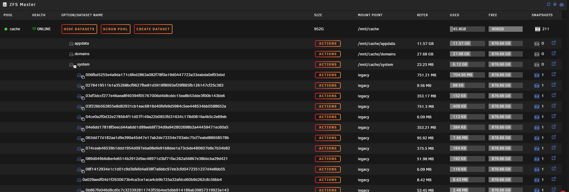

August 24, 20233 yr Oh, sorry. I was not in a good condition yesterday. On the Cache drive (like in the video from Spaceinvader) All Shares are Datasets and every docker is its own dataset to make individual snapshots. But this is not the case on the ARRAY There is nothing, except for this one Share, but the Data from this share are on disk 1, 3, 4, and 6
August 24, 20233 yr Community Expert How did you move the data to the array? IIRC unbalance won't create datasets.

August 25, 20233 yr I used the mover. Move everything to the array (change all shares to Cache -> Array) -> convert pool to zfs -> move everything back. But mine looks also way different.
