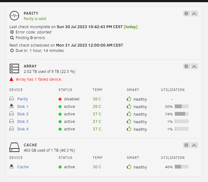

Parity device disabled
I added some new extra drives today, my new drives were bigger than what i had so i had to make a new array and make my new drive the parity drive. I did i parity check which completed successfully
Yet my drive is still disabled. Why is that?

Initial thought is to take array offline.  Remove the parity drive.  Add it back and be sure it has the format disk option button/warning when you enable the array.  It should begin building it.

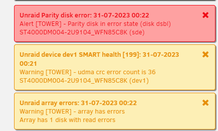

Following your steps,
Once unassigned parity disk i do not get this message (i expect this is because my disk is already disabled)
I start array with unassigned parity disk, stop it again and assign the parity disk. start it again. it shows this next to the start button: (Start will Parity-Sync and/or Data-Rebuild)
I get these notifications:
And it does not start any rebuild process nor a parity-sync process.
Once again new diagnostics:
tower-diagnostics-20230731-0025.zip

The diagnostics show resets on the parity disk followed by write errors which is why it was disabled.
Are you sure your PSU is up to handling the drives?   The resets looked like they could be cabling errors (SATA or power) so. Heck that carefully.   You could run an extended SMART test on the drive to test its health.
I see CRC errors on Device Model:     ST4000DM004-2U9104
Serial Number:    WFN85C8K
That is your parity drive.  It looks like a new drive is in your future.
I literally bought it today
Was just looking at the drive log more... 12 power on hours and
199 UDMA_CRC_Error_Count    -OSRCK   197   193   000    -    40;
you might have a lemon.  I dont think drives bounce back from cyclic redundancy check errors, but maybe I'm wrong.
If you still have your receipt, I'd say its worth taking it back even if it is working based on that error.
