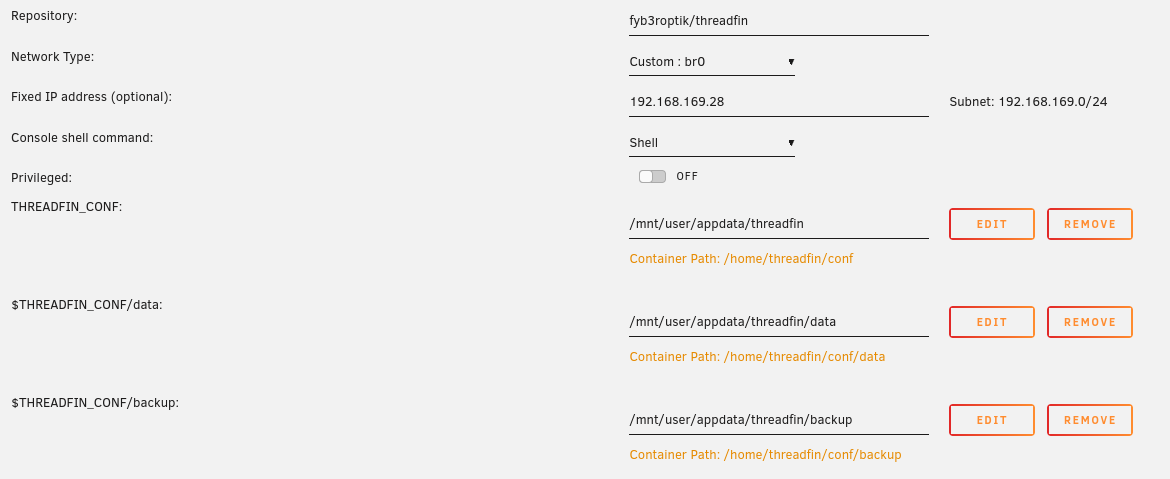

September 18, 20233 yr I created a Docker using the Docker hub. I added the path variables and it seems to work. I don't know if I need the dollar signs or not! I have stopped and started it a few times and the config saves. I also changed the advanced parameters WebUI to ipaddress:34400/web/

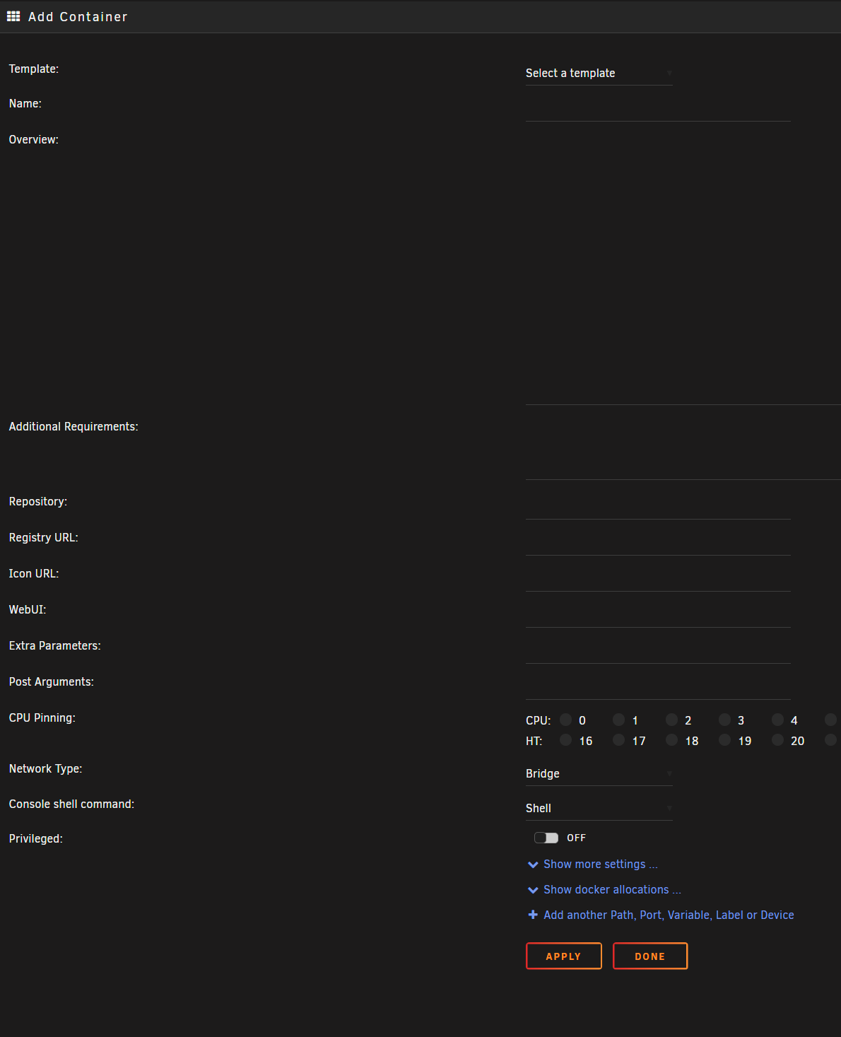

September 21, 20233 yr On 9/13/2023 at 5:47 PM, kri kri said: MIght be some options here > Can we get a docker for unraid? · Issue #122 · Threadfin/Threadfin (github.com) I've successfully installed Threadfin by downloading the .xml template listed in that link, placing it in my Docker templates folder and installing by clicking Add Container on the Docker tab in UnRAID.

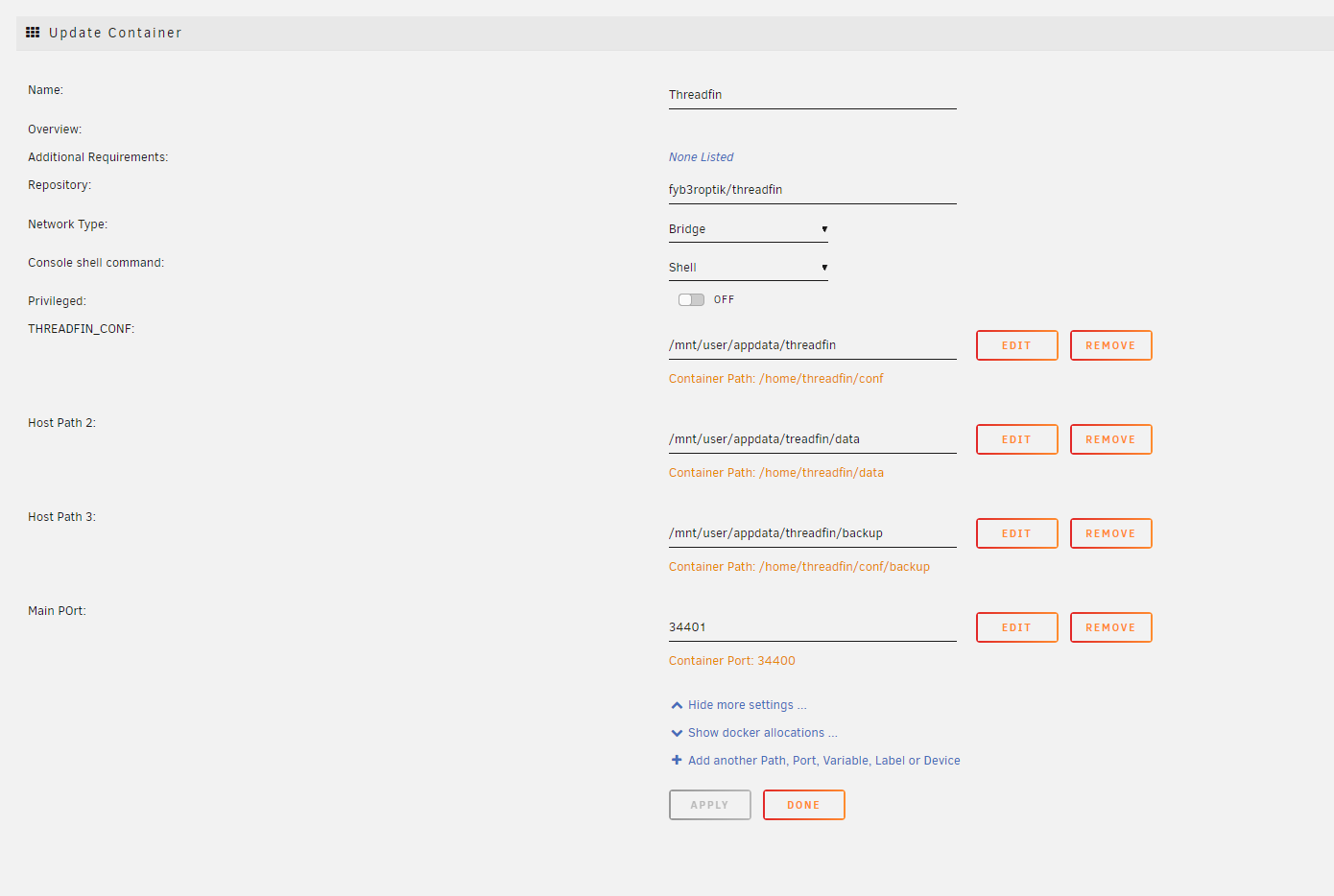

January 20, 20242 yr I only changed the port to 34401 as I still had Xteve running so I could copy paste the old settings over.

October 12, 20242 yr On 9/17/2023 at 7:41 PM, scott2020 said: I created a Docker using the Docker hub. I added the path variables and it seems to work. I don't know if I need the dollar signs or not! I have stopped and started it a few times and the config saves. I also changed the advanced parameters WebUI to ipaddress:34400/web/ This post is what will fix anyone's inability to connect to the webui interface. You need to do a minor edit to (enable advanced view while editing threadfin) WebUI as follows: http://[IP]:[PORT:34400]/web The key is adding /web at the end. Threadfin is fully functional after that. Thank-you to Scott2020 for this simple fix.
