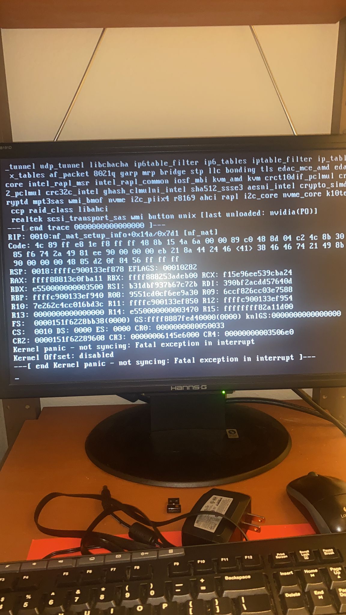

August 10, 20233 yr Hello, I had a recent crash that I am trying to troubleshoot. Server was up and running fine, then it was not accessible any longer. I had my fiance take a photo of what was on the screen and then reboot. After the reboot I downloaded the diagnostic logs. Hoping someone here can help me out! galaxy-diagnostics-20230810-1844.zip Thank you all in advance!

August 13, 20233 yr Community Expert Solution Aug 11 10:49:32 GALAXY kernel: macvlan_broadcast+0x10a/0x150 [macvlan] Aug 11 10:49:32 GALAXY kernel: ? _raw_spin_unlock+0x14/0x29 Aug 11 10:49:32 GALAXY kernel: macvlan_process_broadcast+0xbc/0x12f [macvlan] Try switching to ipvlan (Settings -> Docker Settings -> Docker custom network type -> ipvlan (advanced view must be enabled, top right)).
August 13, 20233 yr Author Would this be something that could cause the crashes that I'm seeing? I did a little research into that and it seemed that a lot of people ended up with more problems after switch that than before. But I'll give anything a shot at this point!
August 14, 20233 yr Community Expert 19 hours ago, Rhuarc said: Would this be something that could cause the crashes that I'm seeing? Yes, it's known to end up crashing the server after 1 or 2 days usually.
August 15, 20233 yr Author Well, 2 and a half days in and so far no crashes! It's crazy that something as simple as that can be make the difference in stability that I'm seeing!
