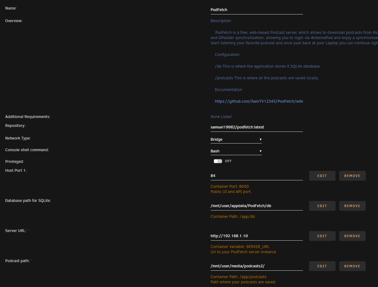

I cannot for the life of me get this to install on unraid.
I have looked at the wiki, which states to create a linux user with 1000, however that's not possible on unraid, and the container will not stay up long enough to create the user within the container. I tried to chmod -R 777 on the database and still recieve the following error:
12/18/2023
10:49:17 AM
Debug file located at /home/rust/src/target/x86_64-unknown-linux-musl/release/build/podfetch-ab12b285b16ce73b/out/built.rs
12/18/2023
10:49:17 AM
thread 'main' panicked at src/service/environment_service.rs:62:54:
12/18/2023
10:49:17 AM
called `Option::unwrap()` on a `None` value
12/18/2023
10:49:17 AM
note: run with `RUST_BACKTRACE=1` environment variable to display a backtrace
My setup is as follows is attached in the screenshot.
I'm sure it's something stupid I've done but I cannot figure out what it is, or what I need to change. If someone can help me, I'd greatly appreciate it.

I got a similar error and found this thread. Alas, the thread was of little help, but I managed to get it working anyway.
Turns out that Server URL (SERVER_URL variable) has to begin with "http://" or "https://". No need for port here (it seemed to not care either way).
Hope that helps.

Yeah, it worked just fine with this configuration:
As far as I can tell, everything under "More settings" is empty except for "OIDC scope", which doesn't matter since OIDC wasn't used in my configuration.

If you can give me a bit more information on your setup I could try it. It should work as mentioned afterwards.
@ansgaros : Thank you ! It's works with your information !!! Cool.
But, this program handles podcasts strangely. Changing the sort order does not seem possible: Sort by publication day for example.
@SamTV12345 : It's ok now.
I really didn't understand how to fill out the configuration in unraid.  With ansgaros's pict it's really clear now !

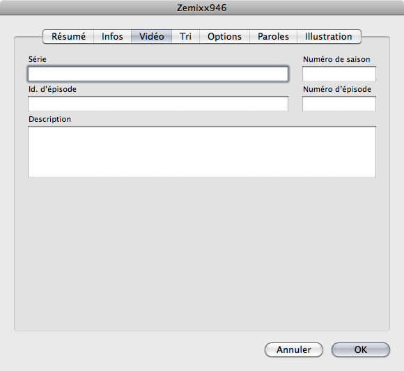

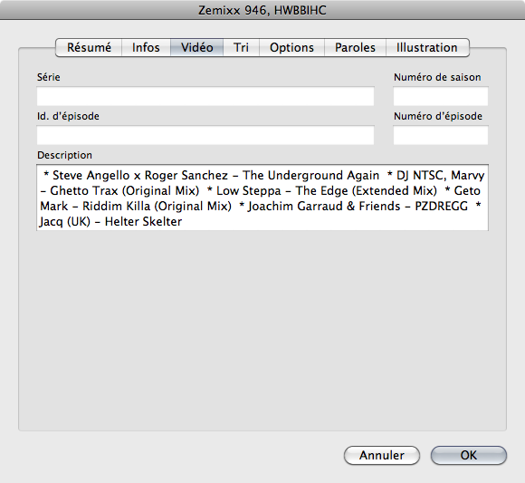

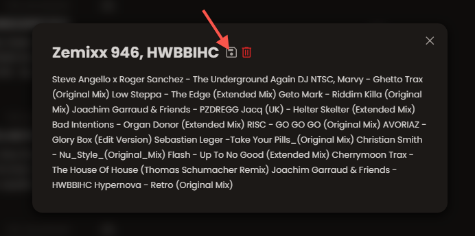

There is another problem: if I download the podcast, it ends up broken and I don't understand why.
On top of that, if I go into the details of the episode and I decide to download it to the computer, the file will only be 4 KB!817378259_Podfetch2.png.e78ffe24766eb60ebb72e27ba4d02c4a.png
I tried several programs that recover podcasts and they all have the same problem:
In general, it's a shame, they don't recover the information from the RSS feed in the audio file like iTunes does.
Here is the difference between:
-A podcast downloaded from iTunes:
-A podcast downloaded with software other than iTunes:
Only iTunes imports RSS data correctly. I don't understand why other software doesn't include this data.
We could download the file directly via the web and it would be the same. If we move the podcast file to another machine we will no longer have the data on the podcast episode. (Click on it to see the difference on podcasts tags)

This is fixed. Writing the id3 tags failed and corrupted the m4v files.

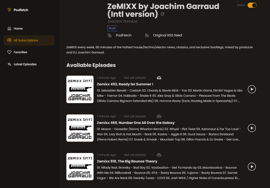

When you add a podcast there's no sort :
You see :
-ZeMixx 453,
-ZeMixx 469,
-ZeMixx 510,
-ZeMixx 532,
Everything is mixed without any logic.
