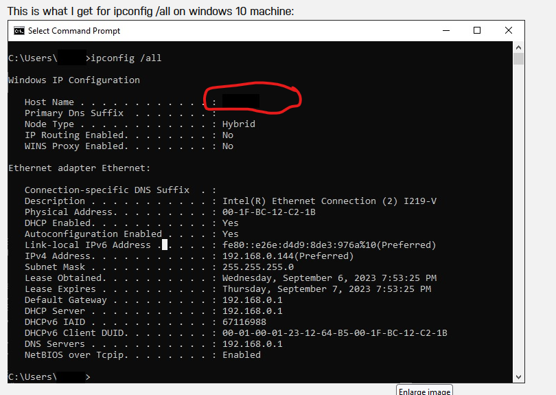

On 9/5/2023 at 7:35 AM, dboonthego said:
In addition to Frank's comments, what does "ipconfig /all" show for both windows 10/11 machines?
This is what I get for ipconfig /all on windows 10 machine:
and windows 11 machine:

I power cycled my modem + router as well as the windows 10 machine. When my PC booted up I was able to get to the WebGUI login screen for the first time in awhile, but when I went to log in I got the "This site can’t be reached. *IP address* took too long to respond." error
Not really sure what that means (if anything) but I guess it feels like progress?
You re missing what is called a 'Host Name' on this computer.  This is a requirement for SMB in its internal processing.  (Once you successfully log in, SMB/Samba will assign you as       <Host_Name>\<SMB_User_Name>        for its internal processing.)   I am not sure what the GUI requires...
You can set this by going to   Settings    >>>  System    >>>    About
That name (obliviously) has to be unique on your system.  Most of the time, The Manufacturer will give each computer a random generated name to prevent issues...

I am embarrassed to say that a Host Name is actually displayed when I type ipconfig /all, I just edited the image for privacy reasons (perhaps misguidedly).
