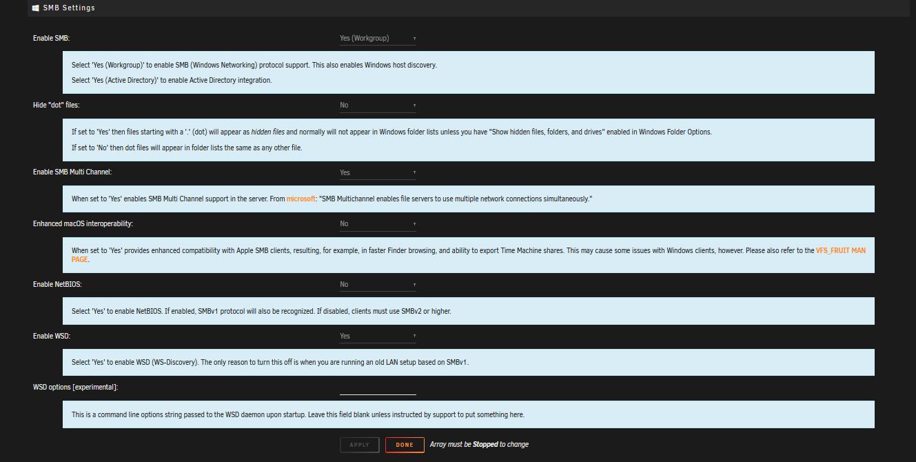

Under SMB Setting in Unraid 6.12.4 (and some previous versions) more control over SMB and WSD is possible.  I personally have disabled NetBIOS/SMB1 all together and rely on WSD as much as possible.  I have also disabled SMB1 from the Windows side (all my Windows clients are now running Windows 11) This has resulted in more reliable Unraid visibility in Windows. Here are my settings:
