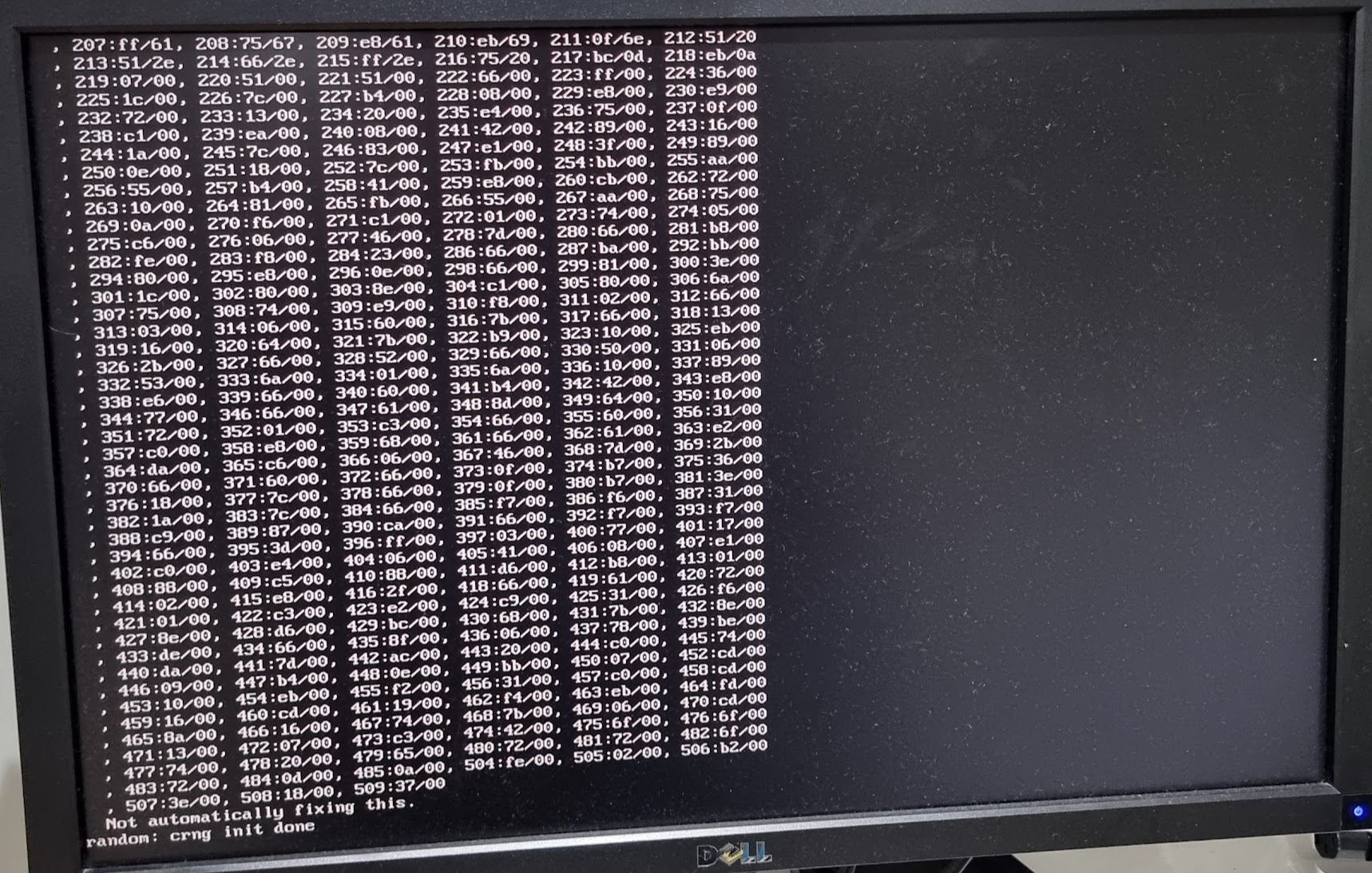

Error messages on boot "Not automatically fixing this"."
Getting a strange fullscreen set of syntax coming up during boot. Boot completes and nothing seems to be untoward during operation? Any ideas if I have anything to worry about?

Run chkdsk on the flash drive in Windows.

I too have run into this issue. I didn't want to open a new thread, so I'll just post to this one.
I pulled the USB drive out and ran chkdsk on it in Win11. No errors. Stuck it back in and "not automatically fixing this" popped up again. Is this because it's a USB3.0 drive? I don't even know if I have any USB2.0 drives anymore.
UnRaid is working fine, but I'm just a stickler for errors.

I just did as instructed. I tried first on Windows, but the UnRaid USB creator app gave me an "incompatible" marker on the drive. So, I plugged the flash drive into my Mac and ran the creator app there to completion. No errors. Moved the config folder back over and plugged the drive into my USB 2.0 port on the server. Still getting "not automatically fixing this" during boot up. Again, the server seems to be running fine, but that error kind of niggles the back of my mind.
I'm also getting these "errors" and the last 2 youtube videos I watched on unraid also showed these error scrolling by. I'm not experiencing any issues, but it seems this particular type of warning is pretty prevalent. Both drives and ports are USB 2.0.

Sorry to necro this. Using a SAMSUNG BAR Plus 128GB USB 3.0 in a USB 2.0 port. (I know it is overkill for Unraid but it's all I had available!)
I have been getting the same EXACT same error codes and message for months. System has been running fine so didn't prioritize fixing this, until now. Could not find a solution. Were you able to find a solution to this?

It doesn't seem to matter. I created a brand new flash drive with the creator tool and it has these "mostly harmless" warnings.
