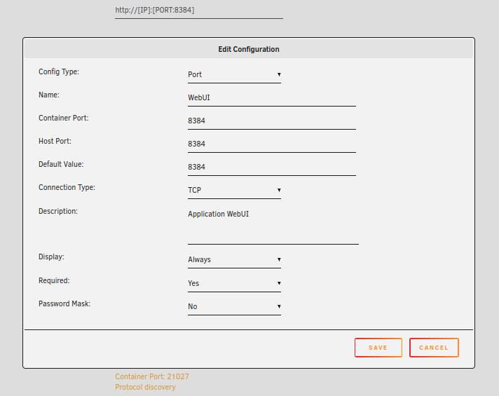

Since Syncthing isn't multi-user, I'm thinking I need to create two Syncthing Docker containers (one for each user), and give each a different port number.  Correct?
For port numbers, I could use the Linux User ID.  Ideally, I'd like Syncthing to run and be accessed using that ID as the port, but I'm unsure what I'm doing wrong.  When I change the port to something other than 8384, Syncthing can't be reached.  So, for example, if Joe was user 1234, I'd like the docker instance to run on port 1234, and Joe to access the Server_IP:1234 to see his files, and set up sync for his stuff.  User Stacy's Docker could be running on port 4321, and access her files from Server_IP:4321.

1.  Does that sound reasonable, and which do I change to the variable port I want?
You would change the host port.
