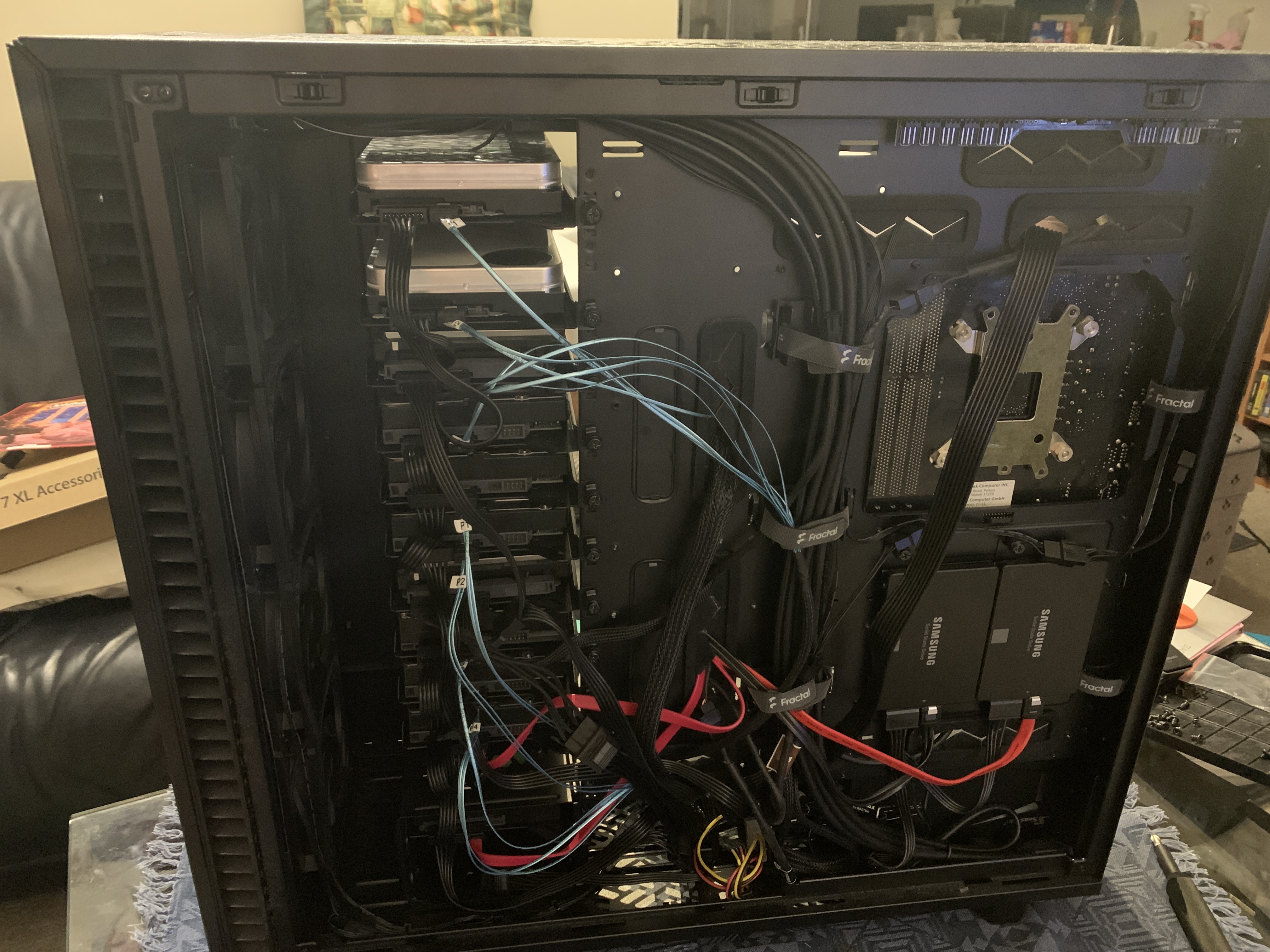

I have this exact same case and I maxed out the number of drives that you could place in it... I ended up going with a 1200 Watt Corsair PSU only difference being that I had a GPU in it...
Mine might have been overkill though, but I am building a new system with it. 2x Epyc CPUs 6900xt GPU and water cooling...
The cables that came with it were long enough
