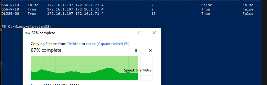

Big issue, unraid limited to write speed of a single SSD compared to Windows Server?

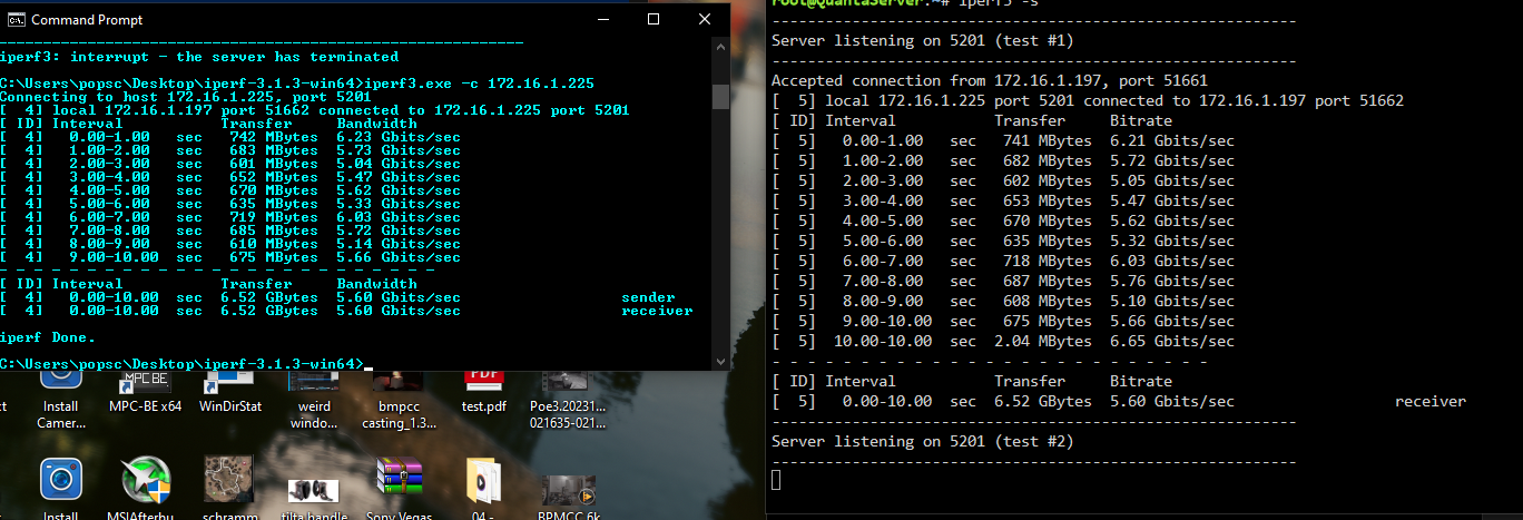

1 hour ago, JunctionRunner said:
But it can saturate it on iperf
Not with a single stream, and that's what matters for a single file transfer.
But windows on this machine shows similar single stream iperf results in the same direction as unraid, yet it transfers fine...
And would SMB multichannel not use multiple streams? Also this is not one giant file, it's multiple.

Yes, I did enable it, what would be the way to test that it's actually working and enabled in unraid?
If enabling it doesn't actually turn it on, then I guess that would explain why the performance is so much worse.
There is that "SMB Extras" section, maybe that needs some stuff added too, but you'd think the yes/no toggle would yknow, work. And I have done multiple reboots since enabling it.
There was a Samba status command that would show it was enable or not, same for Windows with a different command, but it's been a while since I tested that, at the time it was with multiple NICs, should not be difficult to find with Google.

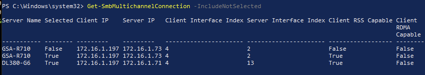

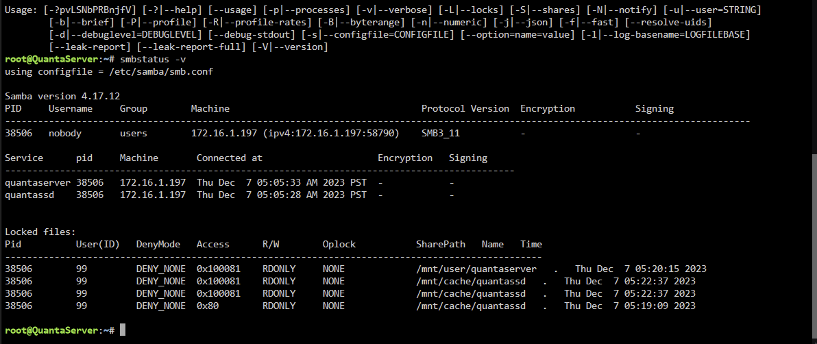

Well, support pointed me towards the sbmstatus command but I can't seem to find a multichannel option like this example here.
I enabled jumbo frames on my router, switch and workstation, set them all to maximum, and I saw single stream performance jump up quite a lot, but it's inconsistent.
These two tests were done, then a few minutes later, slow again in one direction.
Still better, but slow.
With a direct disk share I've now seem it peak to near 800MB/s but then it drops quite a lot, often ending back down around 500MB/s, and if I use the unrad array share with the cache enabled, I get basically 500 max reading and writing...

If I'm reading the Samba status correctly SMB multichannel is not working, that could be the difference you see compared with Windows, where probably multichannel is working, Unraid should get you similar speeds if a single stream iperf test consistently got you close to line speed.
Guess I did post my prior reply but it does seem like multichannel isn't enabled.
Here are the diagnostics. I just ran another copy test to the SSD disk share and I actually hit 1GB/s briefly but then it dropped off very fast. For the standard share with cache enabled, same cap as before.

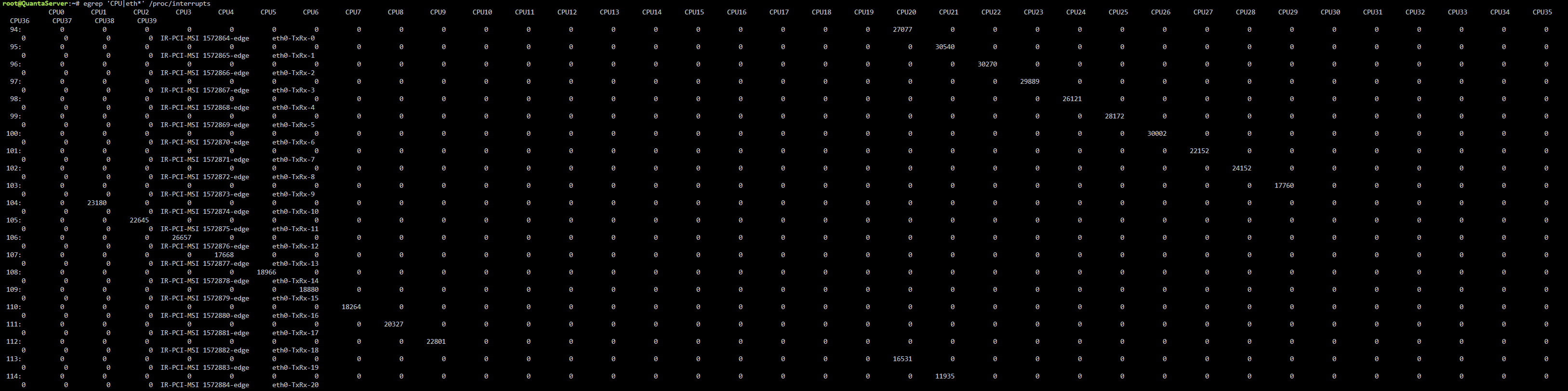

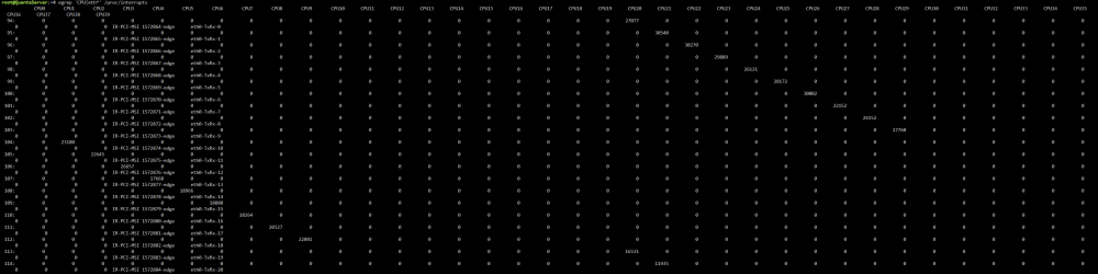

This thread should help to verify if RSS is enabled for your NIC with Unraid, that (or RDMA) is needed for multichannel support with a single NIC:
Well, I've followed the steps in that guide, and unfortunately it seems to be a no-go.
On the unraid box it only shows these two for my machine
On windows, for some reason the unraid box doesn't show up at all in my list...
My card does support RSS though.
I've rebooted multiple times, both machines with no luck.
My egrep output looks messier than the example but probably because I have more cores/threads.
I am wondering why the unraid server doesn't show up in there... I have drives mapped and I have checked again while running a file transfer.

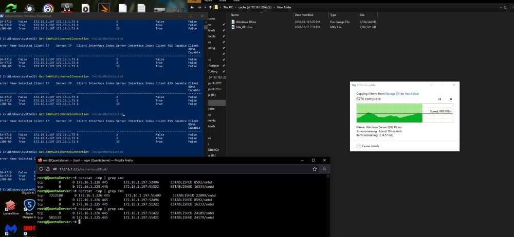

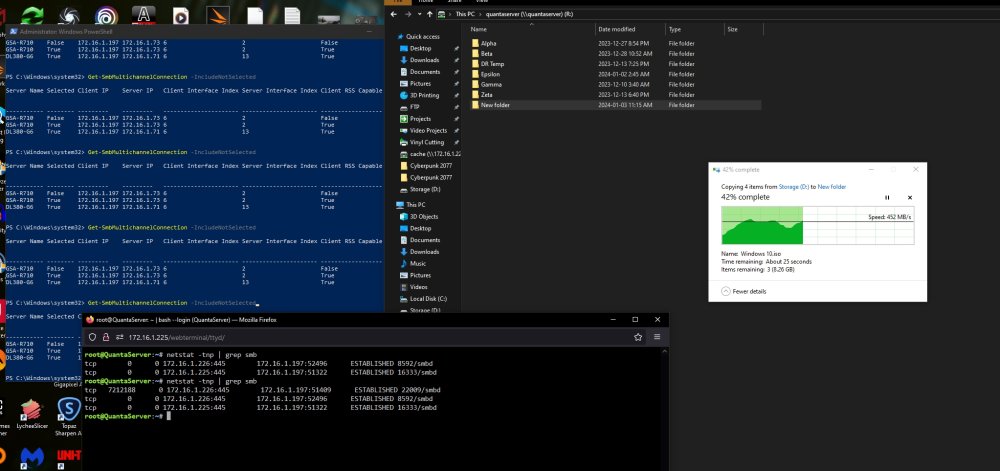

Well, transceivers arrived so that's good, though this weekend I have to leave to visit family to make them happy instead of working on projects lol, uhg. Testing with the direct share still.
Enabled bonding, active backup, ~700 with dips to mid 400s with the smb extras thing cleared out.
Added back in the smb extras I had before, and rebooted my client and I still see no multichannel connection and speeds varied wildly, getting up to 900 briefly.
Read speeds look fantastic though
Unfortunately after poking at this for a little bit, no luck getting smb multichannel to enable and show in powershell, getting similar results with it turned off completely in unraid both copying to and from the server so once it actually turns on it should work great.

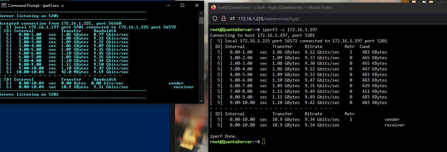

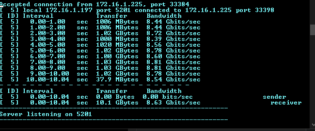

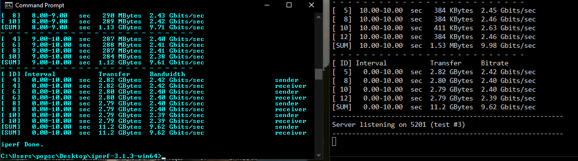

Updated iperf as well.
still slow in that one direction with single stream which annoys me
but good with multiple.
