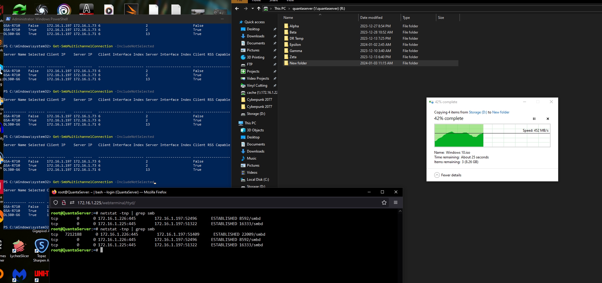

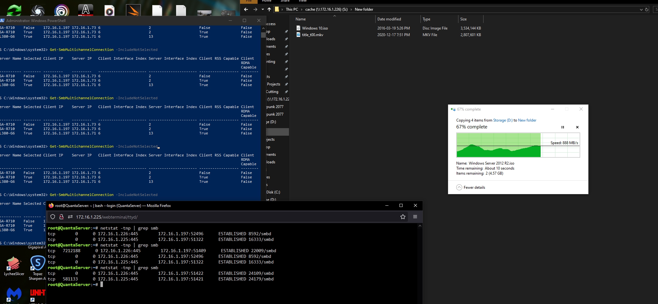

Tiny half update, trying a couple things from a support request thread, but this just happened and not too sure what's going in.
This is really, really weird but it seems like briefly I got an smb multichannel connection but not.. fully?
I set my two 10gbe connections to x.x.1.225 and x.x.1.226 (so same subnet), and added the interfaces capability rss line from smb performance tuning. Then, I wasn't able to connect by using the hostname, but I was able to connect through the ip directly and to the cache I got over 1GB/s, a couple times, I mapped the drive using the ip address, and got a much slower speed.
I still couldn't see it in powershell but in terminal I did see a third connection during that transfer, and now it won't establish that again, so it's like it kicked on for a second somehow...
screenshot_1548.thumb.jpg.49476287b637b4b294b421feb66ba3be.jpgscreenshot_1549.thumb.jpg.163a3eaef1041385b1fe49f636b77846.jpg
anyways, that just gave me a massive migrane confusing the hell out of me but I wanted to share this.
I think at least maybe I'm kind of closer today? Testing with different subnets did not work
