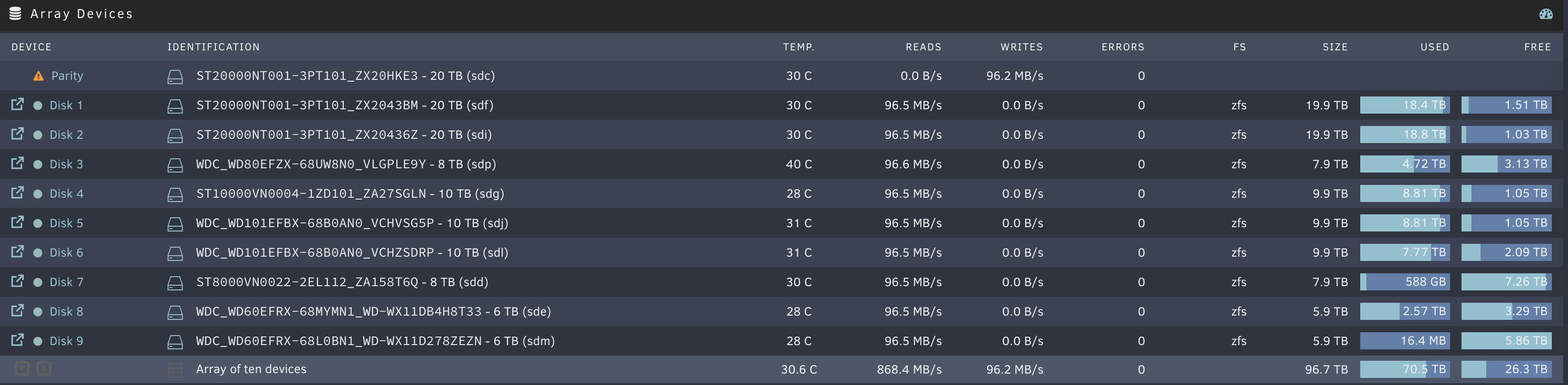

Parity calculation on going, all data present!

27 minutes ago, skler said:
ps. is it possible to backup the actually config when I create a new config?
Your configuration is on the boot flash in the config folder. This includes your disk assignments, and everything else configured in the webUI. You must always have a current backup of your configuration.
But after New Config and starting the array to rebuild parity, not clear what point there would be in going back to a previous disk assignment configuration.
Some critical information is clipped at right in your screenshot.
The Errors column would show if there were I/O errors going on during rebuild.
More importantly, FS, Size, Used, and Free columns. If all disks are mounting correctly these will show you that information and hopefully it is as expected. But, if a disk is unmountable, those columns would show that instead, and the filesystem of the disk would need repair. Any disk that hasn't been formatted yet is also unmountable, so in that case it would be expected to display as unmountable.

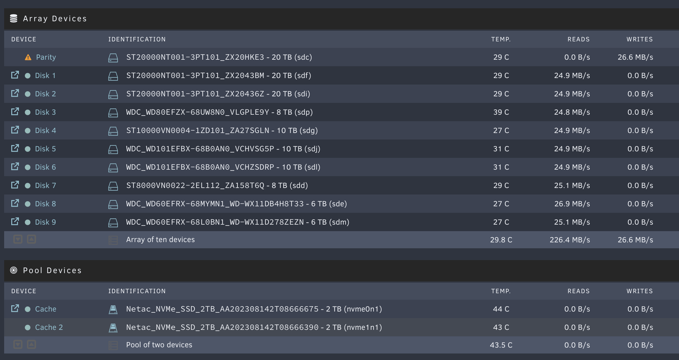

ok, atm is all fine but I've started a couple of minutes ago

4 minutes ago, trurl said:
Post new diagnostics if things don't seem to be going well, or if you just want us to take a look.
Things seems good, btw diagnostic is attached (I did a reboot before creating a new config)
