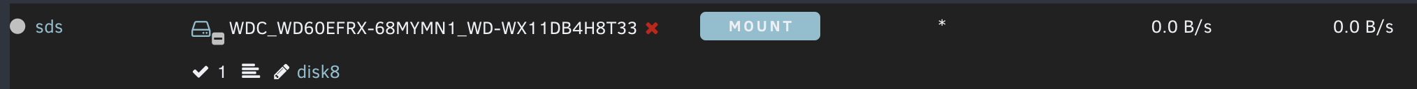

the compromised disk is: disk8, actually is no more included into the array:
and recognized as sds:
2035977264_Screenshot2024-01-07at13_32_17.thumb.png.9e7c63c0170db00d0fb01c211b04f9ef.png
if I stop the array and change the disk8 from sde to sds is a good practice? or I should reboot everything?

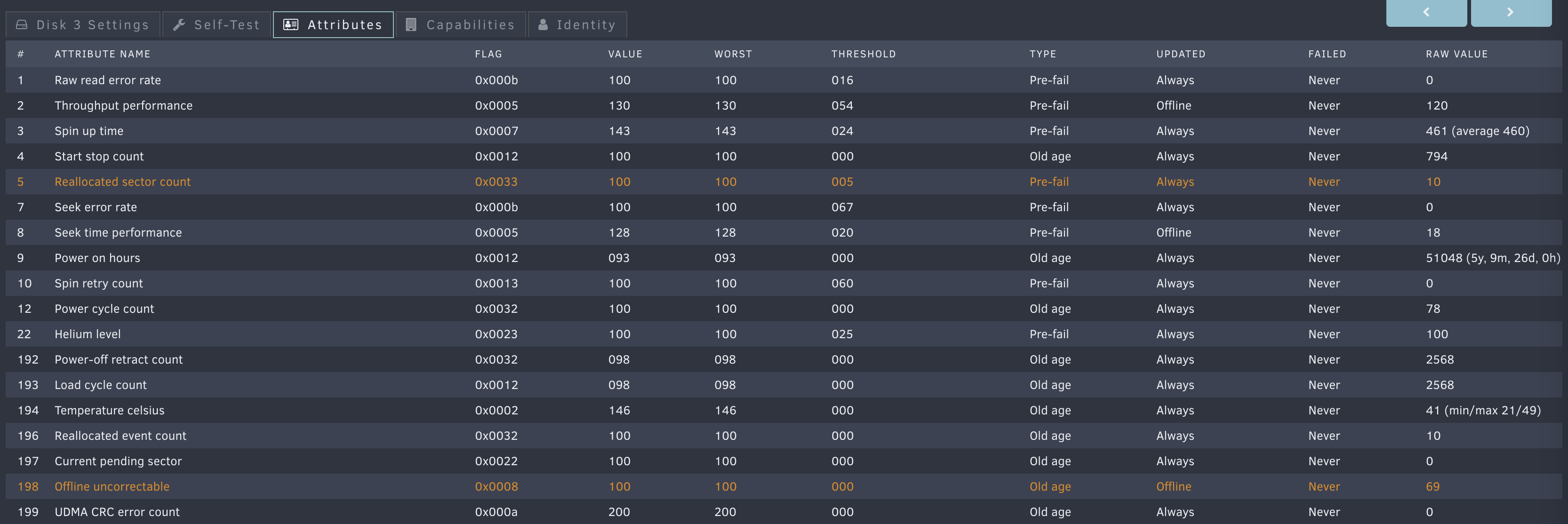

18063030_Screenshot2024-01-07at14_24_11.thumb.png.96e6b311b8f078bfda421a26a21eede9.png
errors btw are not "so bad" I guess, just few sector relocation (for ex. disk3):
1795287130_Screenshot2024-01-07at14_26_32.thumb.png.bdb0647e9adc88c5ba2942abbbc10e81.png

Disk 3 has this:
# 1  Extended offline    Completed: read failure       90%     49686         5011200
so it needs replacing

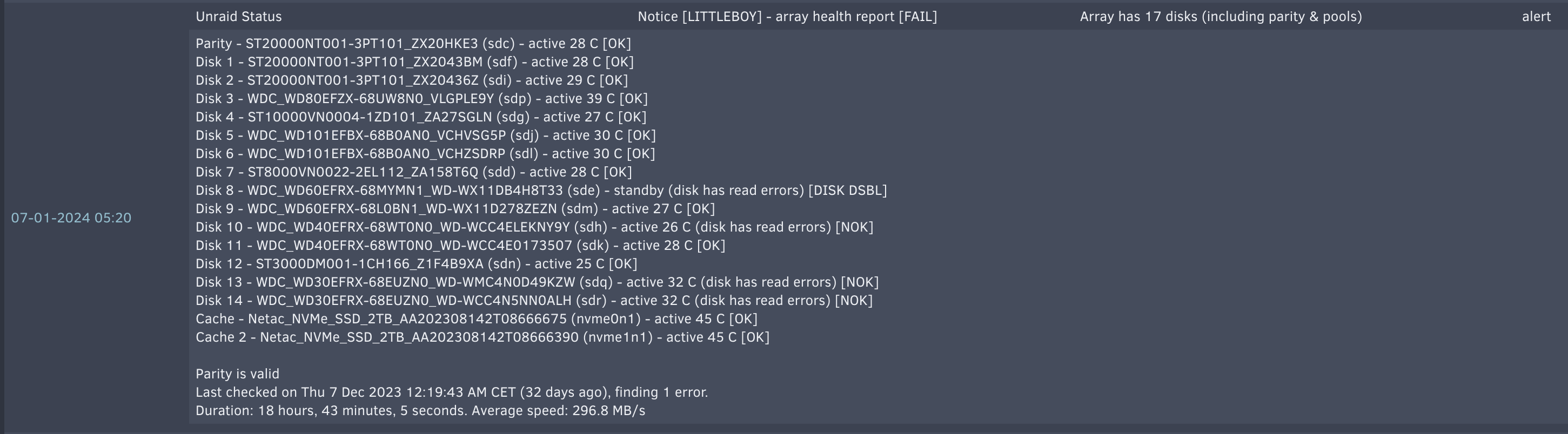

Jan  7 16:05:11 littleboy nginx: 2024/01/07 16:05:11 [error] 61578#61578: *16713838 connect() to unix:/var/run/emhttpd.socket failed (11: Resource temporarily unavailable) while connecting to upstream, client: 192.168.3.3, server: , request: "POST /update.htm HTTP/2.0", upstream: "http://unix:/var/run/emhttpd.socket:/update.htm", host: "10.1.10.191", referrer: "https://10.1.10.191/Settings/DiskSettings"

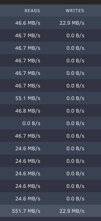

Moreover at the moment the system is running a read check I guess (I didn't anything) :
82130029_Screenshot2024-01-07at15_55_14.thumb.png.dd0a8b964a31fc473a39a2d04b6fc7e2.png

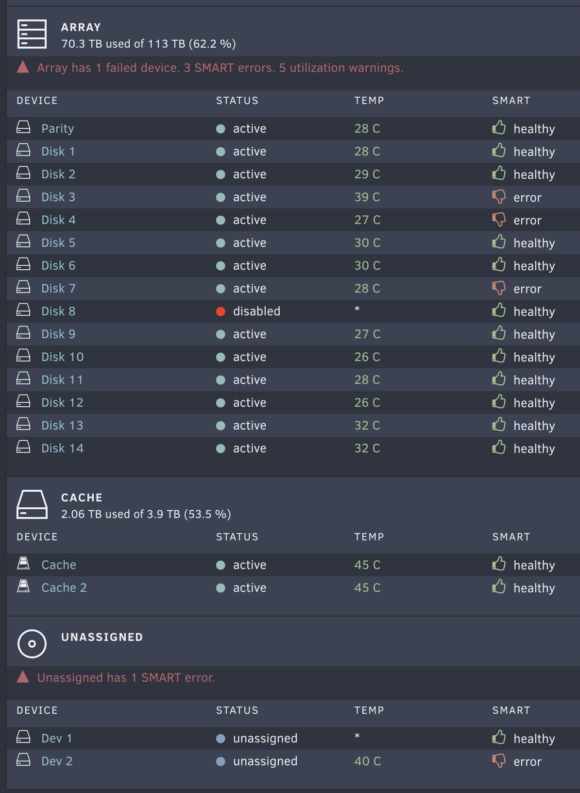

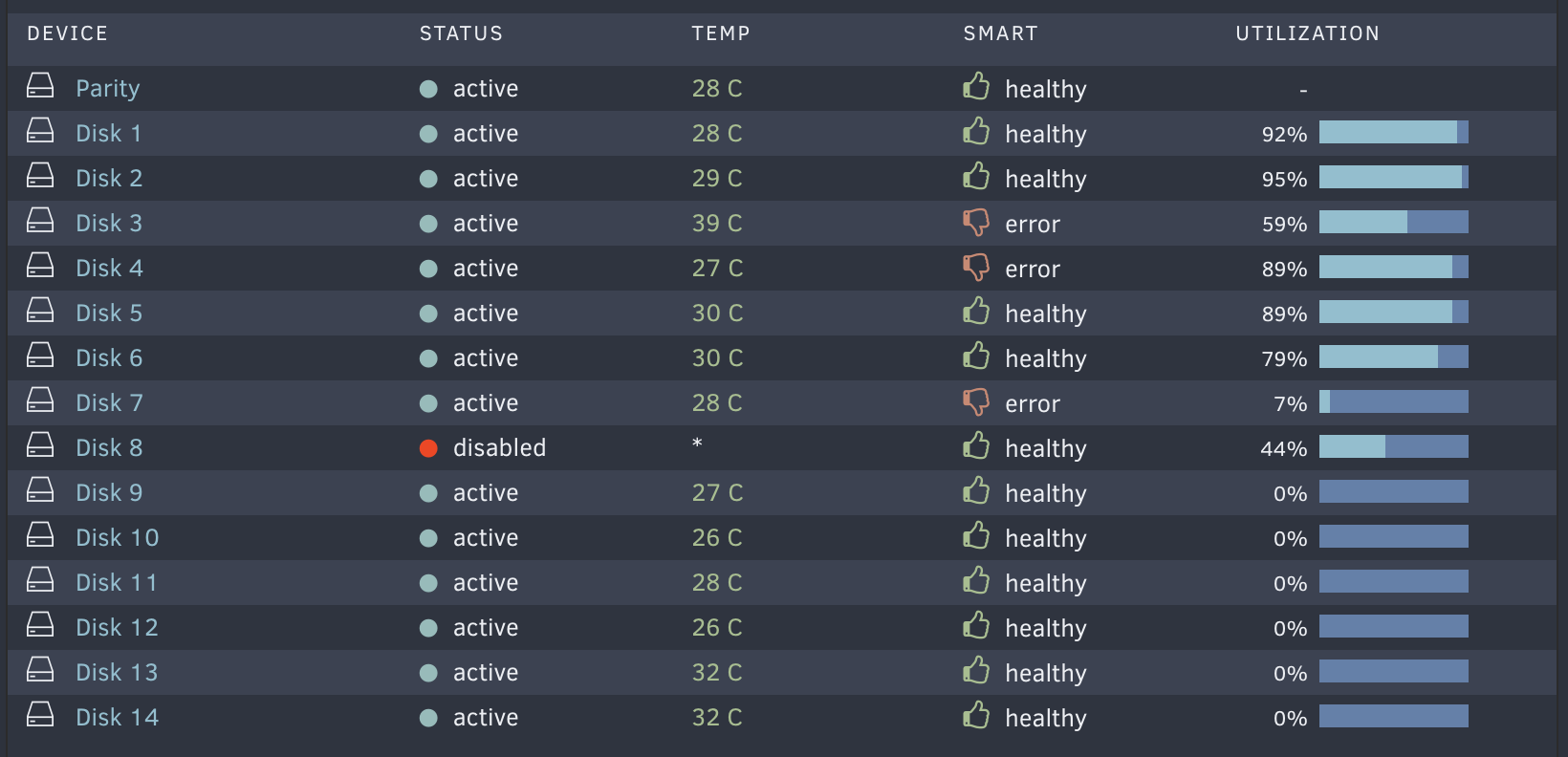

Disks with smart errors in array are: Disk3, Disk4, Disk7
Disk8 is disabled.
1514077905_Screenshot2024-01-07at16_10_02.thumb.png.08709f5dcd6e9b9ab1eed49f2e6059eb.png
Disk7 is not included in the shares, is a TimeMachine backup. I can lose this data, are not so relevant.
Disk8 have some backups, I have a backup of it as a zfs snapshot on Disk3 (that have smart errors)
Disk3, Disk4 have some data, if I can preserve them is very good, I can't backup them, but if lost maybe I can recover them in some way.

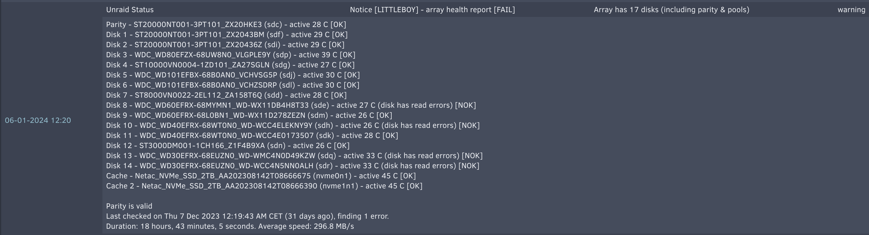

To be honest I receive tons of notification and I don't understand what are the most relevant, but I didn't received anything that tells me to change some disks. Only this morning I had a report on Disk8 error:
985173648_Screenshot2024-01-07at16_29_01.thumb.png.b826c8777310b172225435fd054d7eea.png
(Disk3 and Disk4 are reported as "OK" btw)
I had some warning on read errors (but it says that the sector was reallocated without problems)
2048387285_Screenshot2024-01-07at16_24_52.thumb.png.f54f1af9bc353a0cba04bf33ddd96412.png

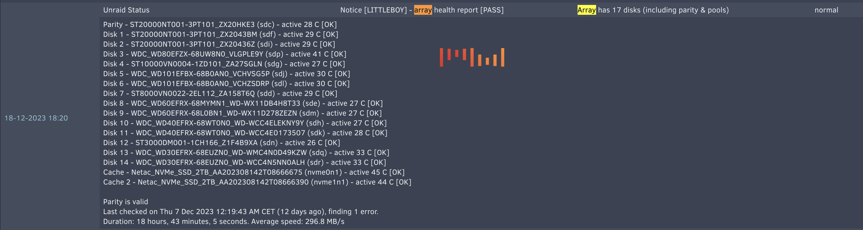

And few days ago some normal state:
1191117595_Screenshot2024-01-07at16_23_54.thumb.png.283d39320da2866ea29c5088b62ee6c8.png

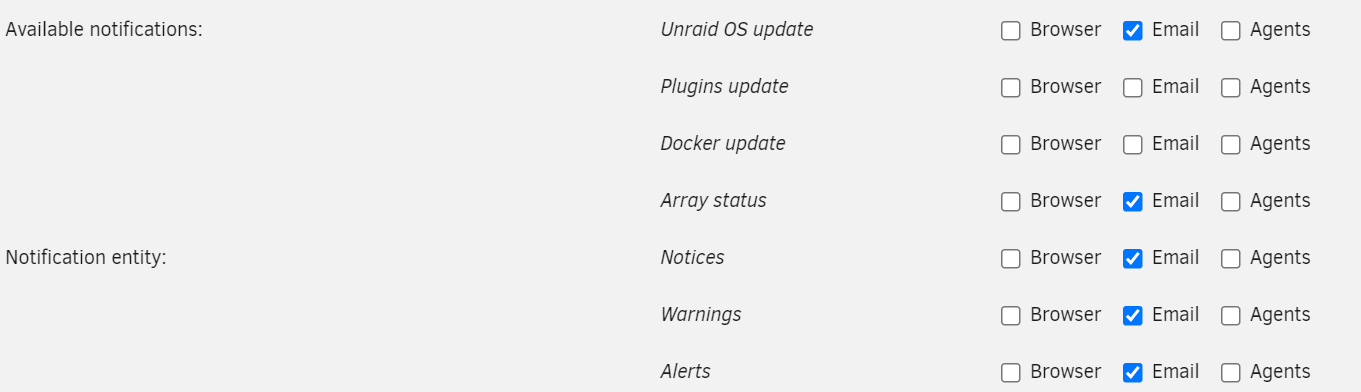

Maybe I have to activate some notifications on smart results?
Edited by skler
This is how I have Notifications setup.
I get all my notifications by email so I don't have to check the webUI to know about them.

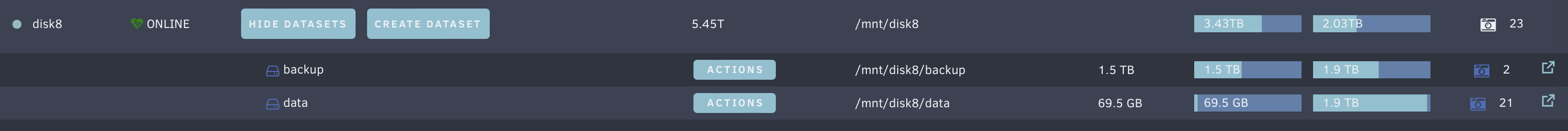

yes, if I mount it all works. It is on zfs, manual mounting it I have all data and snapshots:

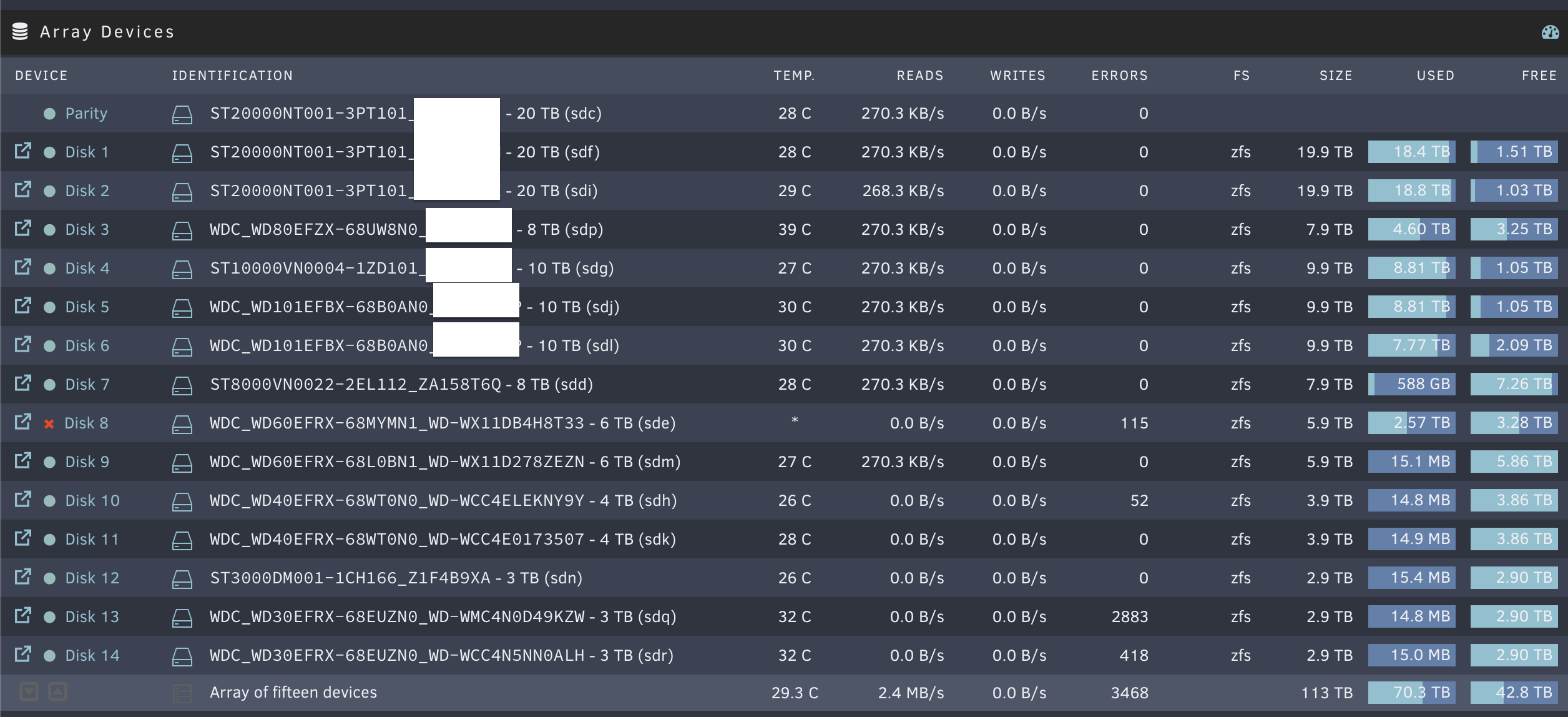

My actually load is this:
1166948709_Screenshot2024-01-08at05_17_59.thumb.png.f706259187fa1630df4d74995b6026f9.png
I've everything full except:
disk7: is the TimeMachine not included in shares
disks: 8-11  my "backup" share, I'm loading data in these days.
disks: 12-14 (not planned to be used at the moment, I can remove them if adding them back will not be a process that will require a week or more)
