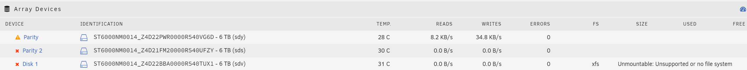

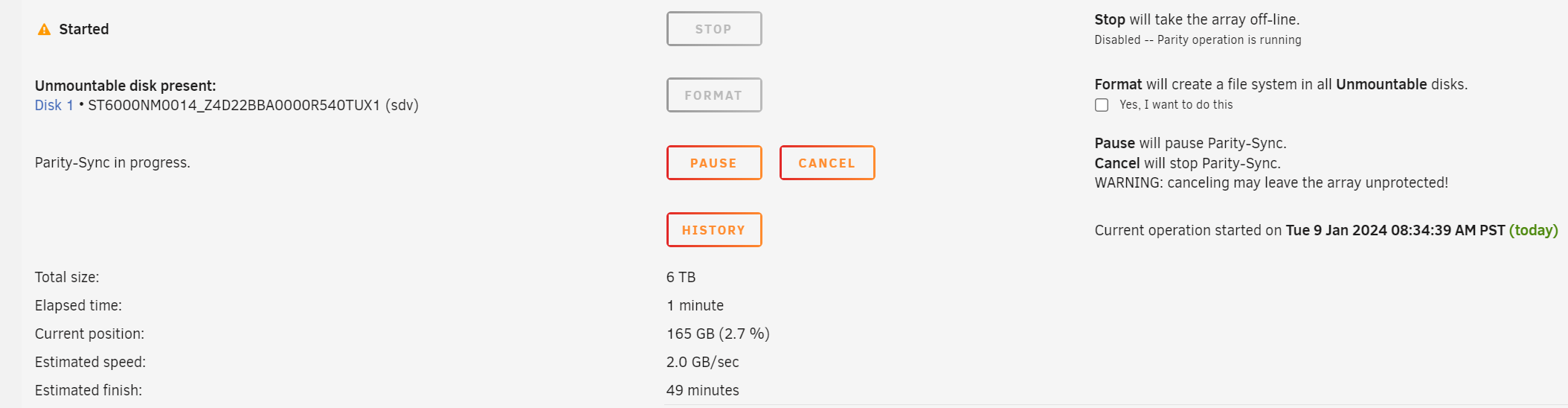

So, just started the array back up after removing the UPS' and restarting.
It has started a parity sync it says will take an hour, but says disk 1 is unmountable and needs to be formatted.
Edit: added diagnostics if of any use.
It doesn't say you NEED to format it. It will allow you to format if you check the box. DO NOT format any disk in the array that is supposed to have your data.
Format is a write operation. It writes an empty filesystem to the disk. Unraid treats this write operation exactly as it does any other, by updating parity so the array will be in sync. If you format a disk in the array, parity agrees the disk is empty so empty is the only thing parity could make it if you rebuild.

No way 6TB parity can be done in an hour. 12+ hours is more likely.
Not sure how you can have 2 disks disabled and the other parity invalid though.

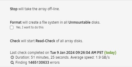

Normally it's 3 days for a full parity check.

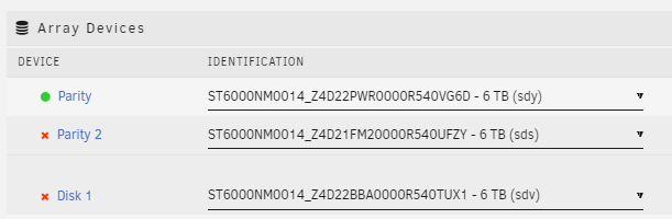

So, after this weird mini 1hr parity check just completed, parity disk 1 has come back online and appears fine, so I just have parity disk 2 and data disk 1 as disabled and contents emulated.
I'm going to swap disk 1 for a new disk and start the glorious 3 day parity check once again, but without the UPS concerns we should be good, I hope. Any concerns or comments on that approach before I start it?
The number of errors from this weird 1hr parity check is concerning though:
Thank you again as well!!

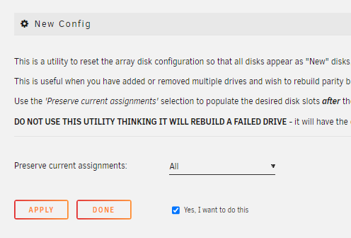

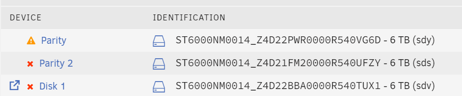

Just to confirm before I click "Apply" this is correct:
Also Disk 1 was not being emulated by parity when I just had the array started, so I assume the Parity 1 disk is no good per that error count.
Thanks!
Yes, click apply and then check "parity is already valid" before start the array.
If it was disabled then it was being emulated by parity1, which was almost certainly incorrect. So, the fact that is was showing as unmountable was referring to the emulated disk1.
