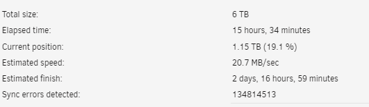

Current situation:
If it's still detecting a lot of sync errors, it may be faster to re-sync parity.

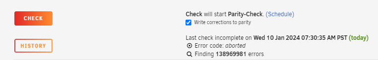

Just for clarity and not wanting to screw anything up...
Re-sync is clicking Check with "Write corrections to parity" checked?
To re-sync parity, instead of finishing the parity check, you'd need to stop the array, unassign both parity drives, start array, stop array, re-assign both parity drives, start array, a parity sync would begin from the beginning, but if you are getting a lot of sync errors, the sync speed should be much better than 20MB/s, assuming no bottlenecks, so it would be quicker.
