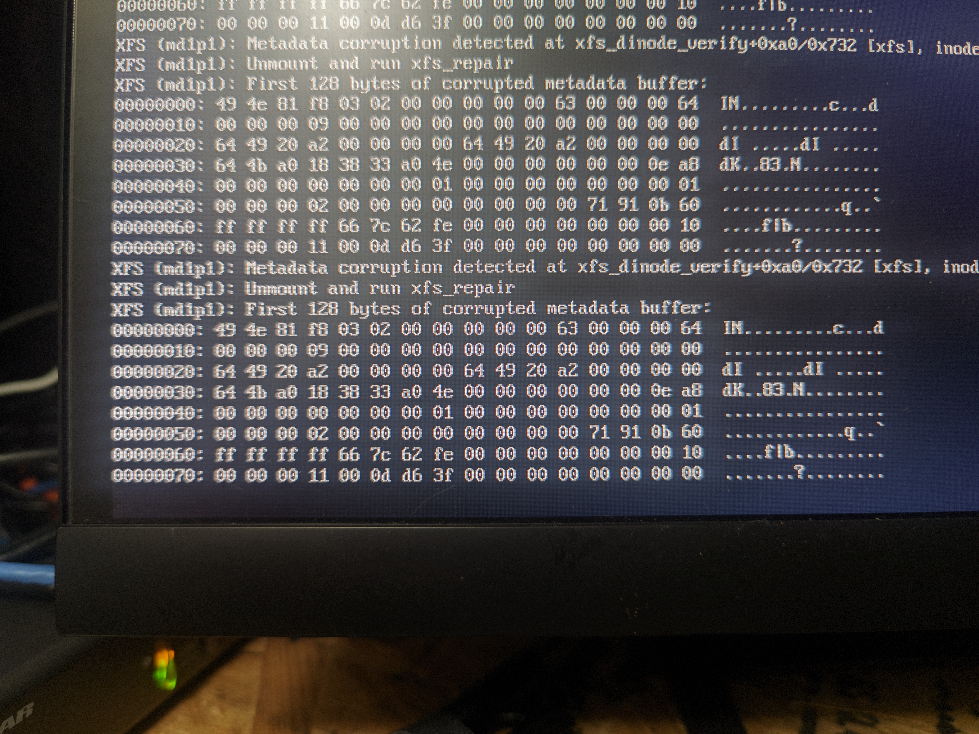

Hello Helpful People,
About two weeks ago I looked the the Main tab of the Unraid dashboard and found that Data Disk 1 had no supported file type and we could not write to that disk. The disk has been part of my array for years and had a majority of our data on it. I stopped the array and ran fsx_repair from Disk 1 Settings > File System Check and it repaired the partition. We were up and running. Now two weeks later I am getting some of the same warnings (although the file system is not preventing from writing to the disk at this point.)
I don't see any Smart errors but does anyone know any tests or diagnostics I can run to determine if this is a hardware problem with this drive before I "jump down the rabbit hole" too far?

That's usually only a filesystem problem, check filesystem on that disk, run it without -n.
Two weeks ago I ran the following:
xfs_repair -L /dev/md1
This "repaired" the file system but I am back here again. Is this the command that you are suggesting that I run again?
The device name can vary according to the Unraid release (and whether encryption is used).   It is better if you run it via the GUI as that will automatically select the correct device name.
I did actually run is in the GUI. I just removed the "-n" and replaced it with "-L" while in Maintenance Mode and hit the "Check" button. Is there something incorrect in the command that I ran or should this have resolved the issue so that I wouldn't have to run it again just two weeks later?
