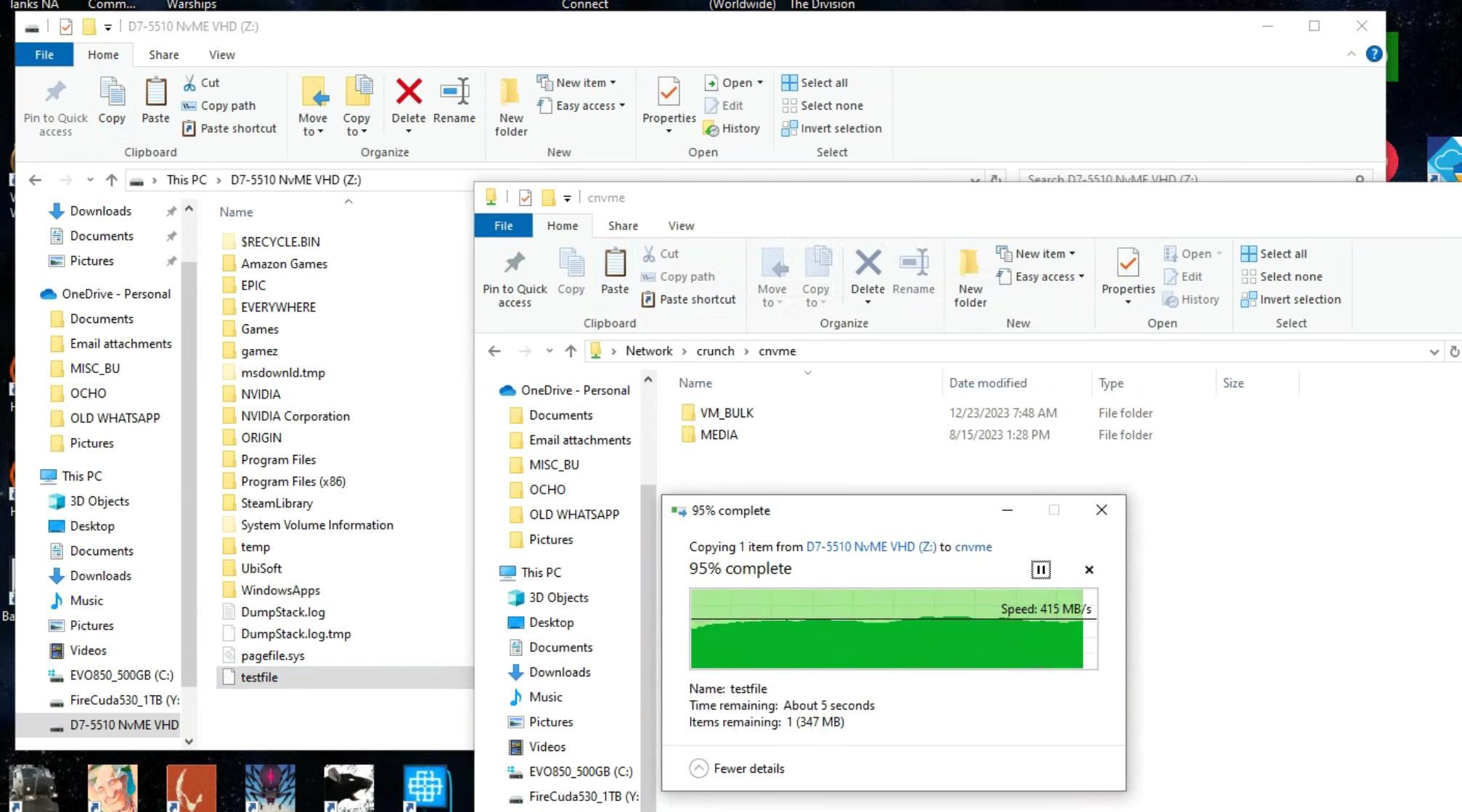

January 29, 20242 yr Author I have hit a bit of a speed limit on my setup iperf3 tests indicate 8+gb/s of available bandwidth between unraid and my test PC, but I cant transfer over SMB faster than 490-520 mb/s unraid v6.11.5 on EPYCD8-2T w/ 7551 eth0 10gb rj45 --> sfp+ @ mikrotik CRS305-1G-4S+ test share/disk = INTEL SSDPF2KX038TZ test pc = unraid VM w/ mobo eth1 passed through 24c 24gb memory disk = Seagate FireCuda 530 diagnostics attached crunch-diagnostics-20240129-1604.zip

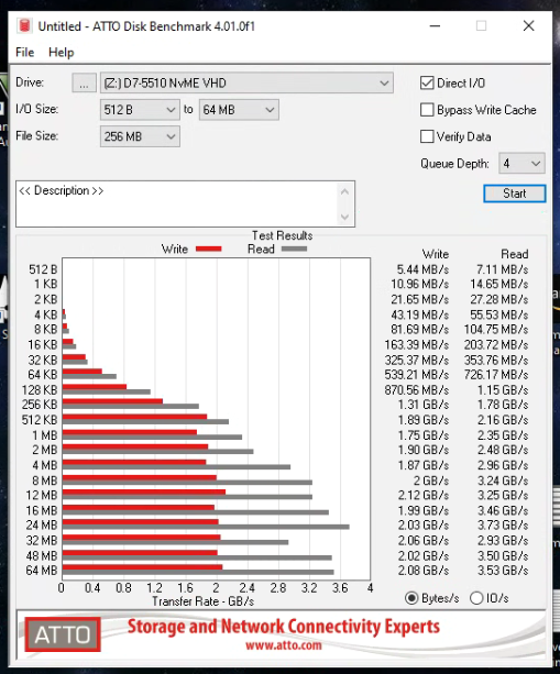

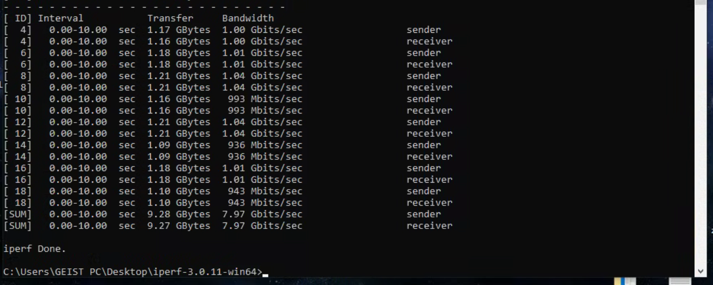

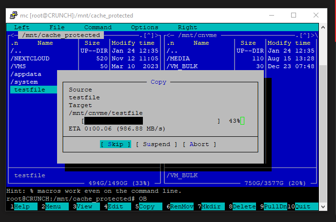

January 30, 20242 yr Author 3 hours ago, itimpi said: Are you transferring to a User Share or direct to the drive? Asking as the Fuse layer used to support User Shares can impose that sort of speed limit. If you are transferring to a User Share then if it is all one one device/pool so it can become an Exclusive share (which bypasses Fuse) you can get the same performance as transferring directly to the physical device. I have been doing my testing with both I have a EVO 860 SSD as my main cache disk...so current performance saturates that read/write I have an intel NVME disk installed for VM VHDs and can test full 10gbe bandwidth through that Copying a testfile from RAID1 "cache-protected" to nvme gets speeds I would expect from RAID1 SAS SSD --> NVME Benchmarking the VHD for the VM (which is on the nvme) gets results I expect iperf shows bandwidth is there But when I transfer to DISK share using SMB the speed doesnt translate I thought that it was a networking issue At first because originally my VM was coming out through br0 on unraid. I was able to pass through one of the 10ge ports from my motherboard directly to the VM and improved speed but not to where I think it should be Edited January 30, 20242 yr by therapist

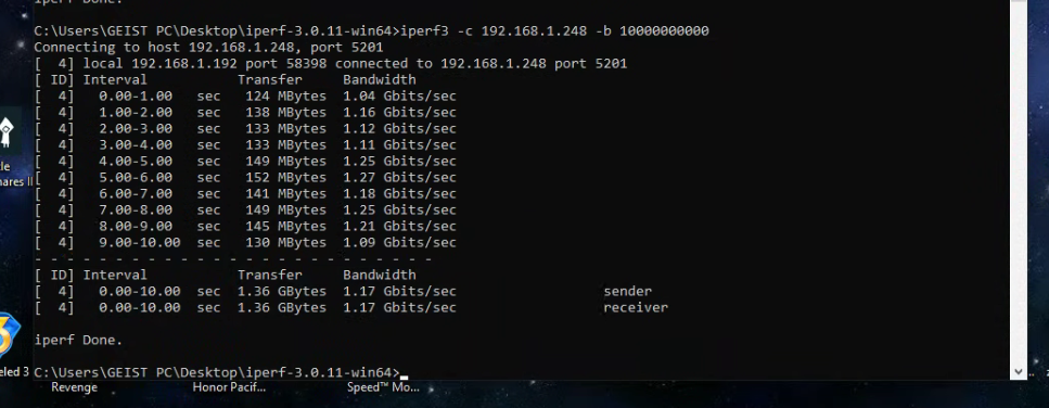

January 30, 20242 yr 7 hours ago, therapist said: iperf shows bandwidth is there This looks like a dual stream test, try single stream, that should get you the closest result to a single transfer.

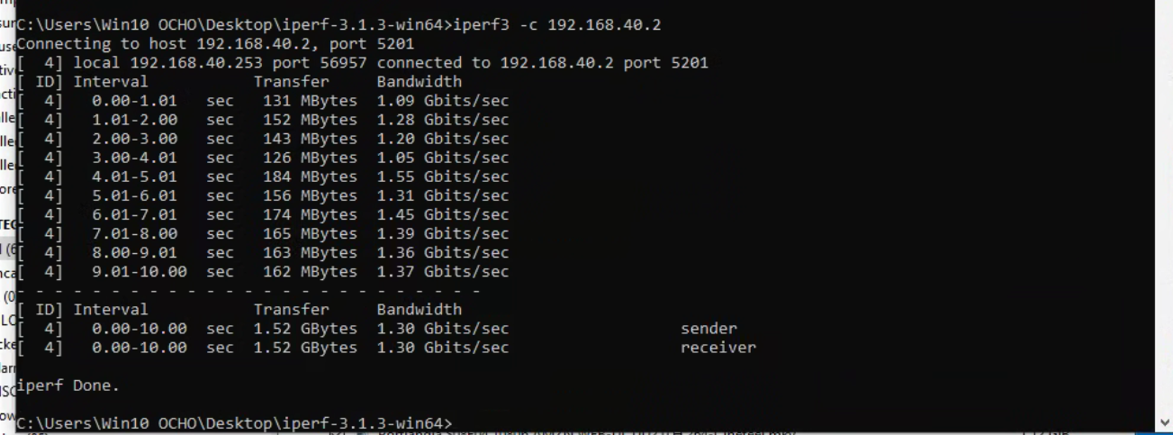

January 31, 20242 yr Author On 1/30/2024 at 3:21 AM, JorgeB said: This looks like a dual stream test, try single stream, that should get you the closest result to a single transfer. this is indicating nothing better than gigabit... all links are indicating 10gb any idea where to look into what i am doing wrong?
January 31, 20242 yr Low iperf results are usually related to NICs (or NIC driver/settings), cables, switch, client PC, etc

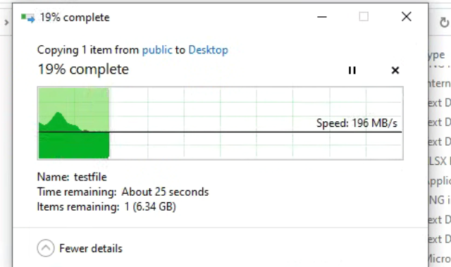

February 1, 20242 yr Author On 1/31/2024 at 1:54 PM, JorgeB said: Low iperf results are usually related to NICs (or NIC driver/settings), cables, switch, client PC, etc so i have a VM on this unraid box that is on a vlan (192.168.40.253) it connects to unraid SMB at 192.168.40.2 file transfer rates are close to reported bandwidth there are no wires, just the virtual 10gbe adapter and unraid i have reset the VM network settings to default, adjusted max rss to 6 to match cores on VM unraid has all default network settings except for buffers through tips & tweaks plugin...which shouldnt matter for a VM using br0.x, no? I get better than gigabit, but something isnt right since im not seeing anywhere near proper speeds
