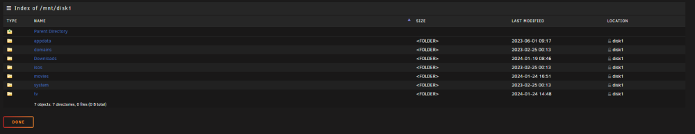

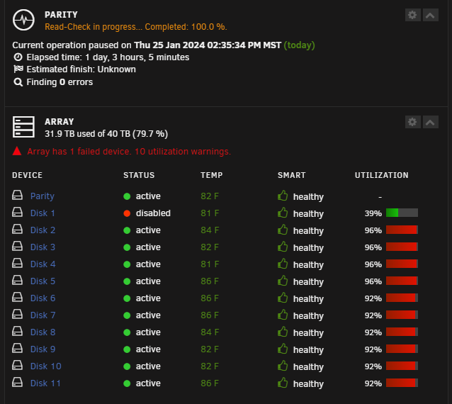

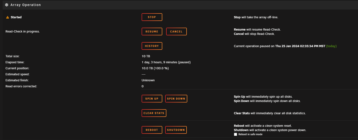

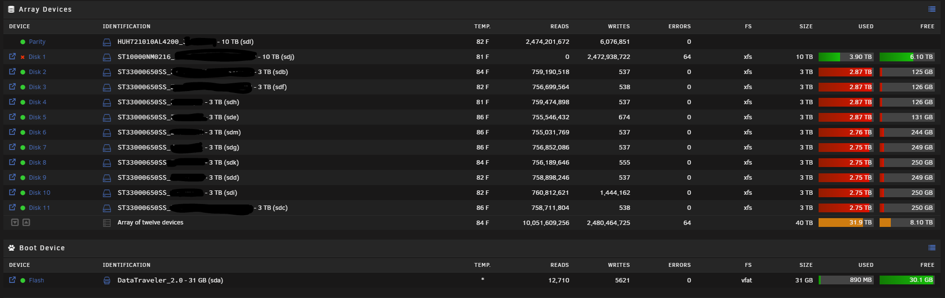

Here are a few screenshots, and the diag. It's still showing as "Device is disabled, contents emulated" after the rebuild. But all the folders are there

Just noticed 64 errors that I hadn't noticed before. Also in syslog, I just found this

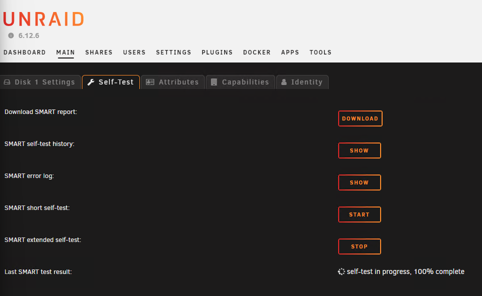

Both say they're at 100% complete, but they're also showing that they're still running. Should I just stop both, then run that command from terminal?
