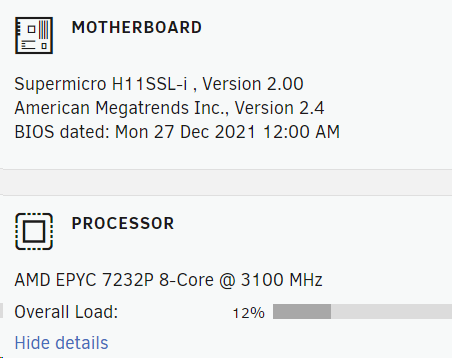

I don't have a problem recommending EPYC, I have one myself, and never had a crash or other stability issues:
I was referring to consumer CPUs, like Ryzen and Threadripper, those can have some stability issues with Unraid and Linux, though in most cases they can be fixed by using the recommended settings, still for the typical user, I think Intel is likely a better option.
