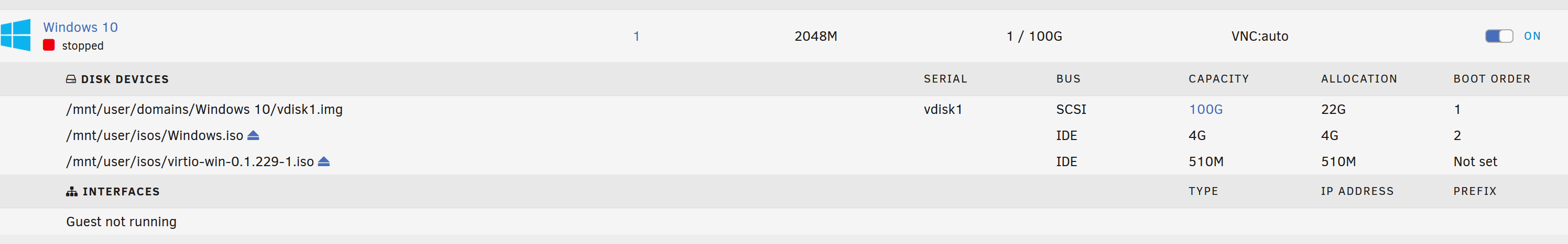

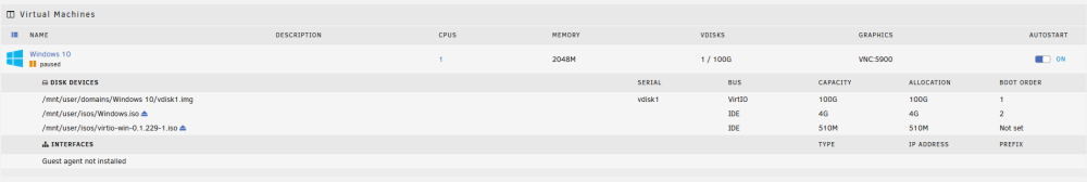

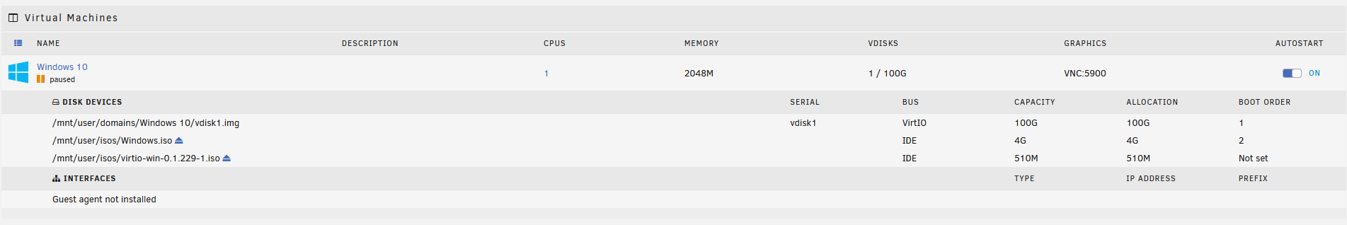

I'm running a server with an Unraid VM on it. After a couple of hours, the VM pauses and stops running a Helix Core host (file sharing and revision history service). I believe this is due to the vdisk reaching it's capacity (as shown in the screenshot below). When it pauses, I have to power cycle the server to get it running again.
1) Is there any easier way to get it off of the paused state?
2) How can I avoid getting to a paused state?
Thanks in advance for the help.

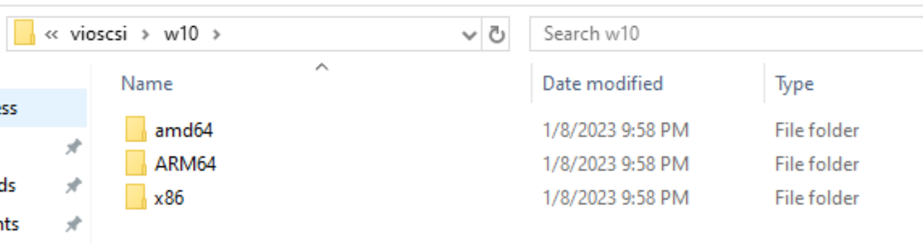

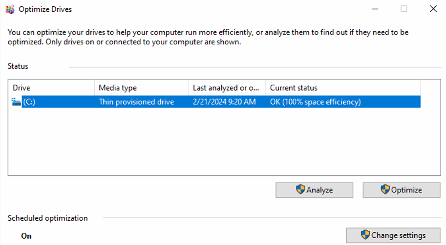

Thanks for the help! I think I'm on the right path for trimming the disk but I'm not sure where to find the SCSI driver. I navigated to E:\vioscsi\w10 but don't have a driver there. I assume my issue is in step 1 of the link you sent me "First we need to install the SCSI controller".

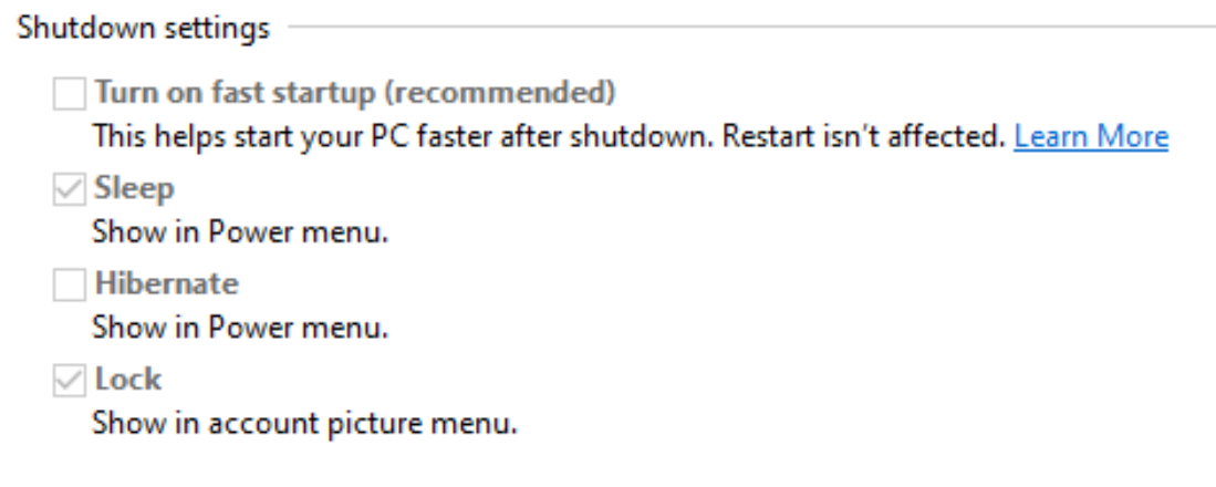

I tried moving on anyway with the steps as if an SCSI driver was already installed. When I tried to reboot, Windows would crash. I made sure beforehand have fast startup off to avoid that but still had problems.
Any guidance?

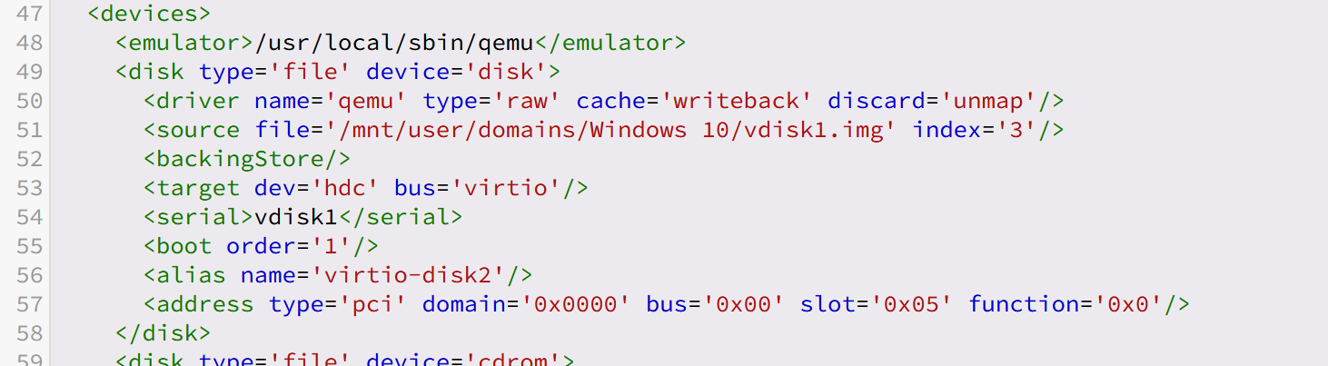

As of lately you don't need the SCSI driver, it's mentioned in the FAQ entry, just add the unmap=discard option, that should be enough.

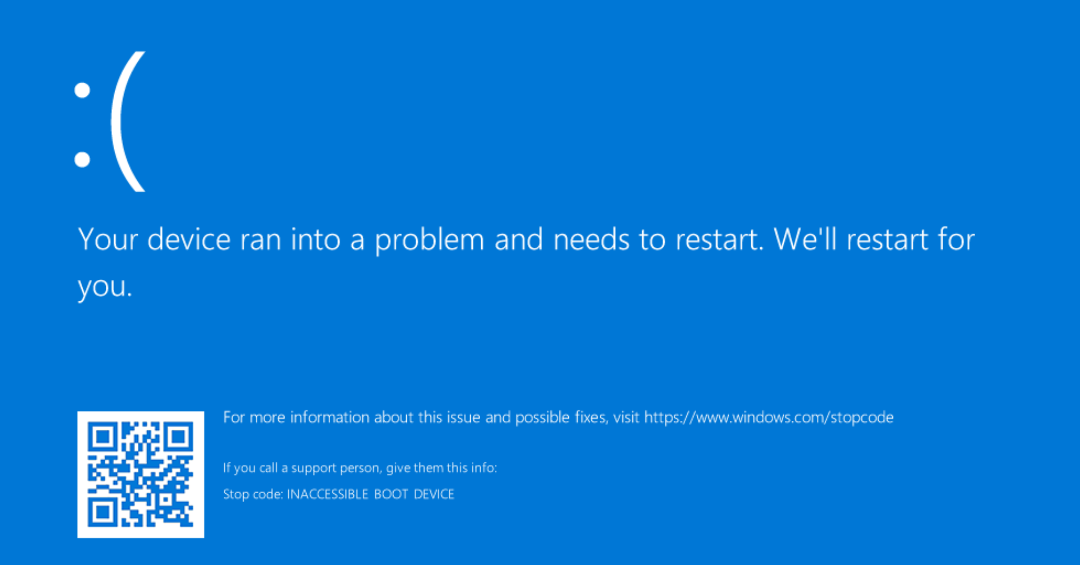

Windows still crashes whenever I try to run the VM after adding that. Specifically the stop code is "INACCESSIBLE BOOT DEVICE".
This is the current set up
Edited by lwintz
If you don't change the controller type you should not get that error, were you using virtio?
It's visible on your first screenshot, change back to virito, but leave the unmap=discard option

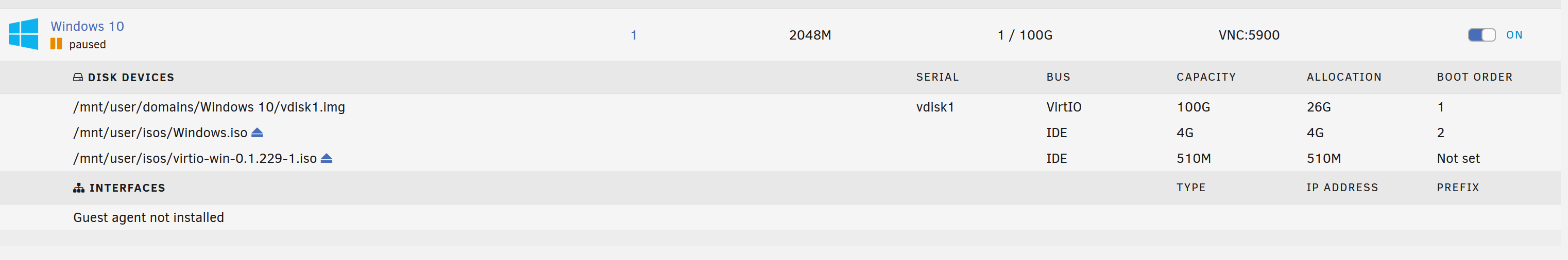

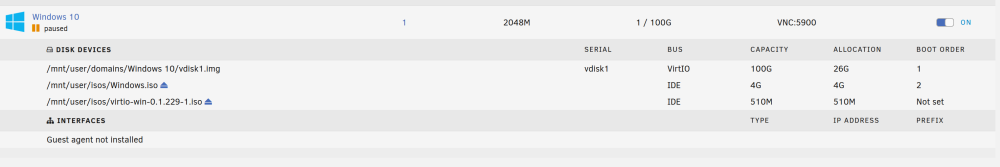

changed the bus for vdisk1 back to virtio with the unmap=discard. Had another capacity and allocation = 100G pause as described in my first screenshot. Also, just want to thank you again for helping.
EDIT
Started sending them again and am now stuck at this. The capacity is much larger than the allocation but it still paused itself automatically.
Edited by lwintz
