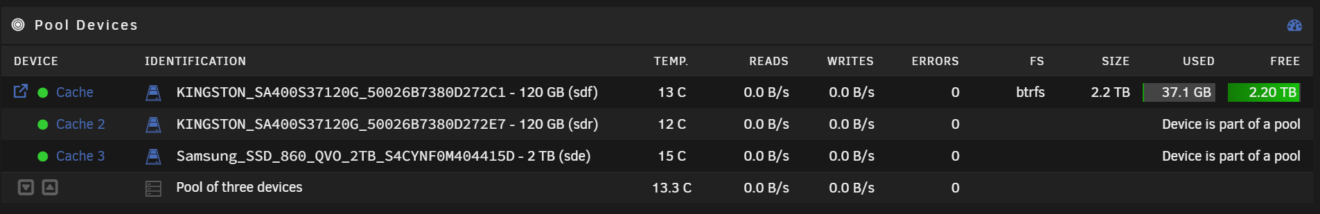

I don't really know where to start here.  when I first set up my unraid I remember getting confused with setting up the cache but got something that worked so moved on.
the time has come now to try to fix that mess as I need the sata ports.
I have 3 SSD's in my cache pool,  1x2tb and 2x 120Gb I plan to get rid of the 2x120Gb ones leaving the 2Tb one in the cache pool on its own to give me 2 extra ports for other things.

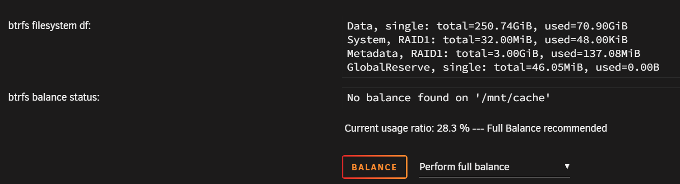

I'm not entirely sure how to do it though  from this it looks to me that I've somehow created a hybrid pool
is there a way without destroying anything to remove the cache completely and re create it with the one drive only?

I have repeated the removal of all drives, start array, stop array.  i figured out that if I reassign all the drives in the same places but before i start the array i can click the "cache" drive and I can change the file system type from "Auto" to "btrfs" and then choose "raid 1"  should I apply this or will i lose my data?
Link to comment
