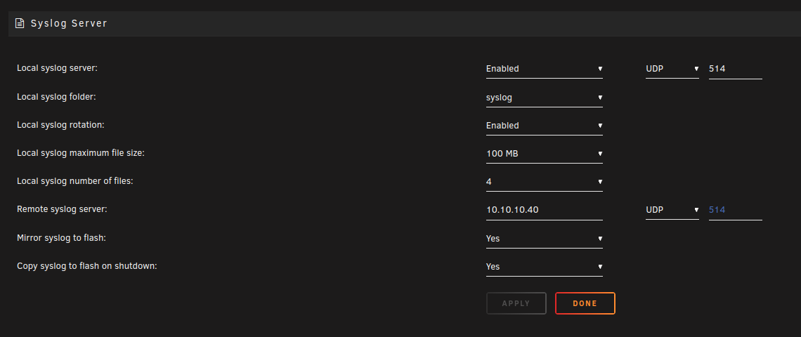

You can't ge the diagnostics but you can get the syslog.   Just setup the Syslog Server.   If you submit a syslog, try to give an approximate time when the reboot occurred.
Here's everything for today. The crash recovered around 11:45 (line 94)
For reference, here's the syslog configuration: image.thumb.png.ccbbc017897c98f11fabd700781542e7.png

Weird, I thought it did that automatically. I reduced the size from 100mb to 5mb
