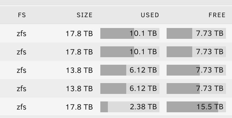

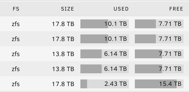

Hello all,
I have 3x 18TB disks and 2x 14TB disks in use right now. I'm slowly filling them up with data from an external share. The first disk filled up to about halfway as per my high water settings I'm using for all shares, but now that my fifth disk is starting to feel I've noticed that some additional data is being written to one of the more full disks, let's say going from 8.5 TB available down to 8.48, then the other disks that were at 8.5 will also all go down to 8.48 or so, then finally data starts flowing back to the nearly empty disk.
Wouldn't any new data for any share go directly to the nearly empty fifth disk if all of my shares are set to not exclude any drives? I'm trying to understand why high water doesn't seem to be totally followed.
Thanks.
Attached is an example. Yesterday, the top four disks were all over 8TB free and now they continue to go down. Even earlier this evening they were all around 7.9TB free.
Here are screenshots from around 30 minutes apart.

Adding screenshot x2

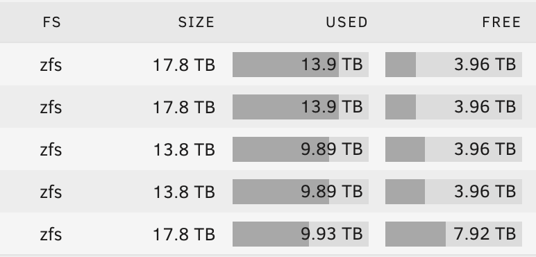

@JorgeB Wow thanks for reproducing, I didn't even catch the 1:2 ratio. Thanks for digging into this. The pattern is continuing as shown.
Edited by adamfl
I have confirmed it only happens with zfs, it works fine with two devices, with three (or more, most likely) it doesn't, it works correctly until the two first devices are below 50%, once they both get to 50% it starts doing the almost most free thing, keeping the last disk with twice of the free space of the other ones.
