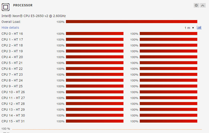

Weird... okay. moving on, I saw my CPU was stuck at 100% usage when Docker was running.
I stopped ALL containers one by one and CPU was still at 100%, which didn't make much sense, all containers in stopped state still had this problem.

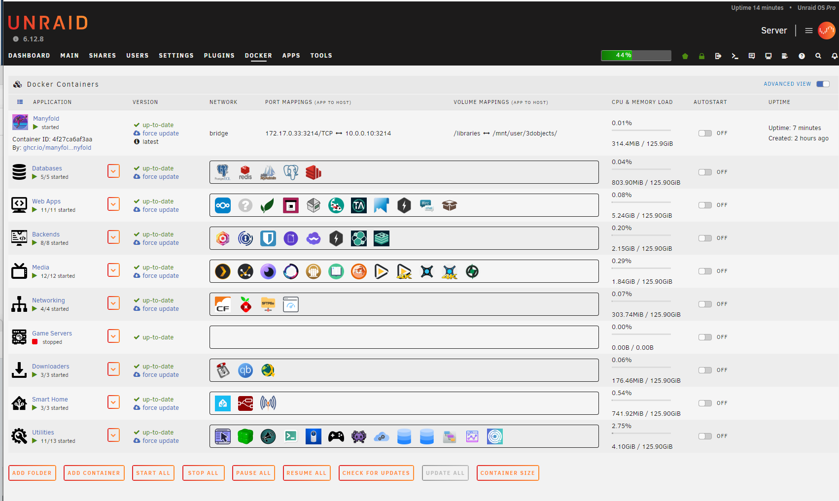

As you can see I'm stuck at 100%, but overall usage per container is very low.
Diagnostics and screenshots attached below.

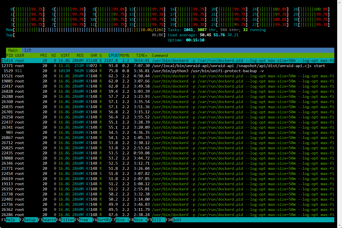

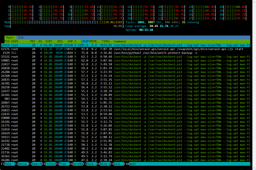

I left the server on overnight and woke up to much lower CPU usage, but I'm still wondering what could have caused this - the server became so sluggish it took an extremely long time to do anything.
Also btw the top command showed 0.0 wa (IOWait) during all of this, forgot to include that screenshot.
I suspect one of the containers, but difficult to confirm without trying one by one.

I left docker running and turned them all off one by one and watched my CPU but no changes, I ended up having every single container in a stopped state and CPU was still at 100% with dockerd being the culprit still. Very strange to me.
