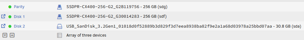

- I add rather small pendrive (32gb) formatted in ZFS (uncompressed and not encrypted)  to array (I suppose that brtfs will work as well):

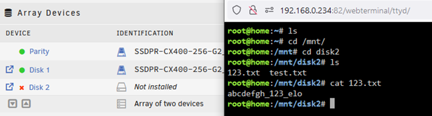

- I ran Unraid parity check with UNCHECKED Write corrections to parity which gives me 1 error during check.
- I stopped Array, removed disk from array, start array, and emulated 123.txt file worked well:
- I added once again the same pendrive to the array to rebuild it and everything worked as suspected.
