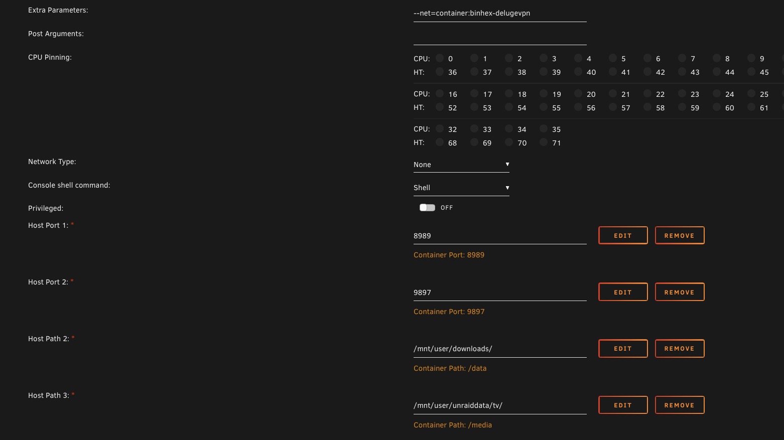

Can't access the UI for Sonarr when routing through Deluge
Today I tried to follow spaceinvaderone's instructions to route my traffic through my Deluge VPN.  I followed his instructions, but it seems they are pretty far out of date.  I saw Binhex had some information about forcing IP tables when using privoxy so I tried that as well.  I tried using a custom network, a bridge network, adding a proxy in Sonarr, and every combination I could think of one step at a time, testing, and then making another change and testing, and so on.  The traffic is getting routed through the VPN and the IP's are the same, but no UI when I use the host IP and the port I added to Deluge that Sonarr is using.
So I've now brought the configs back to the one's recommended by spaceinvaderone, checked it is routing correctly, and since I'm out of ideas, I've come here.  This doesn't seem like a very complex thing to do; is there no up to date guide as to how to configure this?

SONARR
docker run
  -d
  --name='binhex-sonarr'
  -e TZ="America/Chicago"
  -e HOST_OS="Unraid"
  -e HOST_HOSTNAME="Goathead"
  -e HOST_CONTAINERNAME="binhex-sonarr"
  -e 'UMASK'='000'
  -e 'PUID'='99'
  -e 'PGID'='100'
  -l net.unraid.docker.webui='http://[IP]:[PORT:8989]/'
  -l net.unraid.docker.icon='https://raw.githubusercontent.com/binhex/docker-templates/master/binhex/images/sonarr-icon.png'
  -v '/mnt/user/downloads/':'/data':'rw'
  -v '/mnt/user/unraiddata/tv/':'/media':'rw'
  -v '/mnt/user/appdata/binhex-sonarr':'/config':'rw'
  --net=container:binhex-delugevpn 'binhex/arch-sonarr'
269128ea2d045cb29a5ac558f4b3566c6366b4b8a491ec84795c4af972873348
The command finished successfully!
Edited by JonathanM
removed credentials
binhexe's FAQ, specifically Q24, details what is needed.
Since you posted your PIA credentials openly you need to change them ASAP.
Further discussion on this topic should be continued in the support thread for the container,
