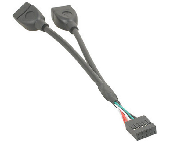

I am using this adapter for the unraid stick + the stick for the array -> both are connected to this adapter:

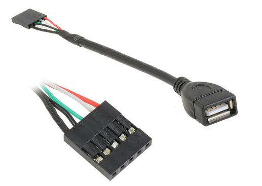

I just ordered a new adapter just for the array stick, maybe this will help:
okay, adapter arrived and I installed it. So Unraid drive is directly connected to the motherboard and the array drive is connected to the USB2.0 port -> IO shield.
After reboot the array drive needs stil to be reformated. Any ideas?
