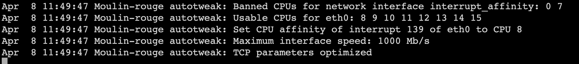

I'd like to provide some clarity on the two features currently not visible in the GUI:
- Modern NICs support hardware queues, which can improve network traffic processing by distributing it across multiple CPUs. The plugin is designed to optimize this by assigning different hardware queues (and their corresponding interrupts) to various CPUs. Additionally, for systems with hybrid CPUs, the plugin aims to allocate these to E-cores. The plugin also enables the Transmit Packet Steering (XPS) feature in the kernel to further enhance network performance.
- The other feature sets some TCP buffer size parameters based on the maximum physical interface speed detected in the system.
For detailed information about any setting within the plugin, you can always use the question mark icon to reveal the documentation.
Additionally the plugin provides detailed logging of its operations within the system log.
774609068_Screenshot2024-04-08at11_52_04.thumb.png.c207fcef1ba95d99e48a586eb69bf0e1.png
