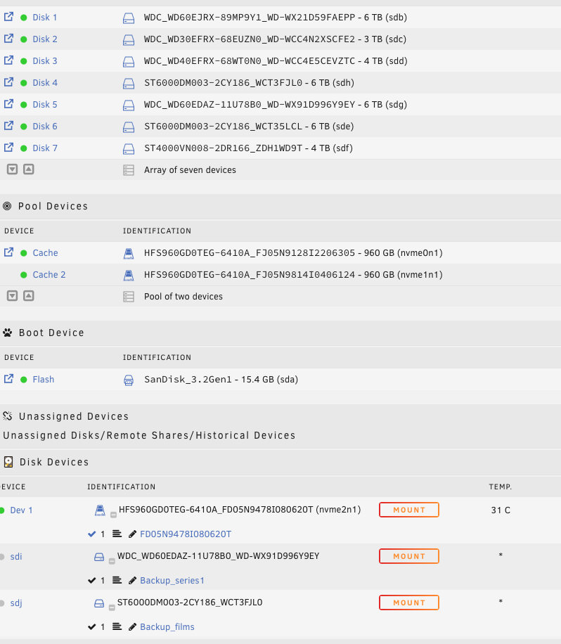

Recently i repurposed my main server into a backup server with a plus license.
The array has 7 disks with no parity. Cache pool is 2x1Tb ssd btrfs pool.
I have a strange issue (see the picture). 2 disks are visible both as array disks and unassigned devices.
I can't stop the array.
1 disk has read errors. For the other one with issue i don't know. Perhaps a connection.
Before repurposing the server disks had no problems. 2 disks are in a sas das (disks 6&7). The other ones are on internal sata ports.

Looks like an issue with the Intel SCU controller, unless all the disks using it share a power splitter or something, if you have another controller to connect those devices I would try it.
thanks. It looks like it's the right diag.
Changed the port to the ahci controller for theses 2 disks (they were the only ones on the scu controller).
No issue at booting and currently running diskspeed benchmark.
Never had a glitch in years with the scu controller. Luckily i don't need these 4 ports.
What drove you to scu in diags ?
I made the same deduction but only when i saw that the 2 drives were the only one attached to the scu.
I've seen issues with those controllers before, especially on older boards, and all affected disks were using it.
