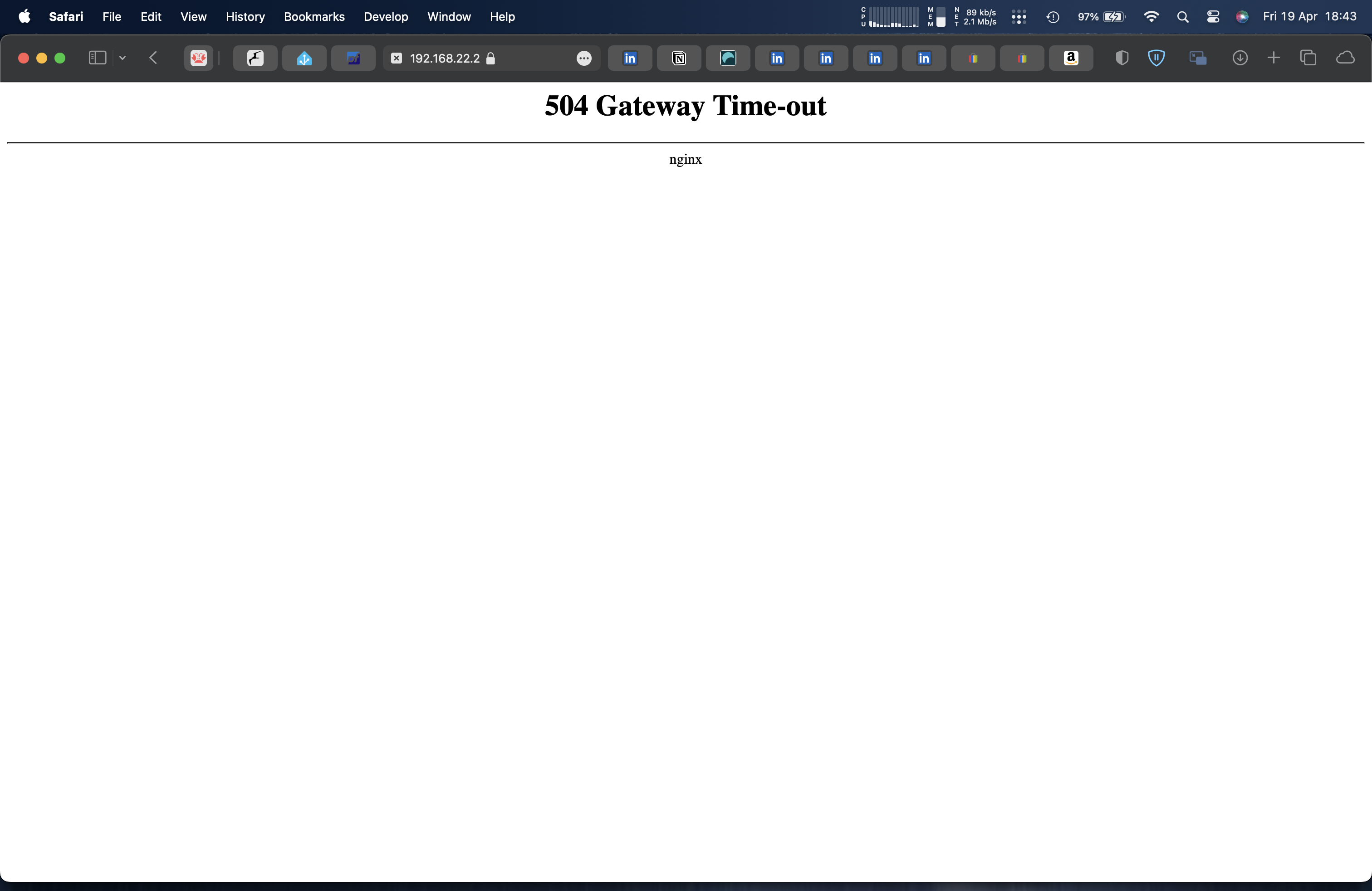

Main GUI NGINX crash. Any smart way to re-start it with a script?
Occasionally the main GUI nginx instance crashes.
I'd like to know if anyone has a solution for this.
Is there a script I can run to detect a crash and re-start the main GUI NGINX?
Other services are always working but no access to server.
I currently keep SSH turned off.
Currently new server build has no soft power button on my server to initiate a restart. Although have now bought one on amazon.

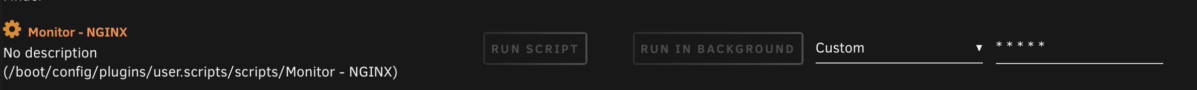

Ok here's a user script.
#!/bin/bash
NGINX_LOG="/var/log/nginx/error.log"
# Monitor NGINX error log for specific error messages
tail -n0 -F ${NGINX_LOG} | while read LINE; do
    if echo $LINE | grep -q "504 Gateway Time-out"; then
        echo "NGINX error detected: $LINE"
        echo "Restarting NGINX..."
        systemctl restart nginx
    fi
done

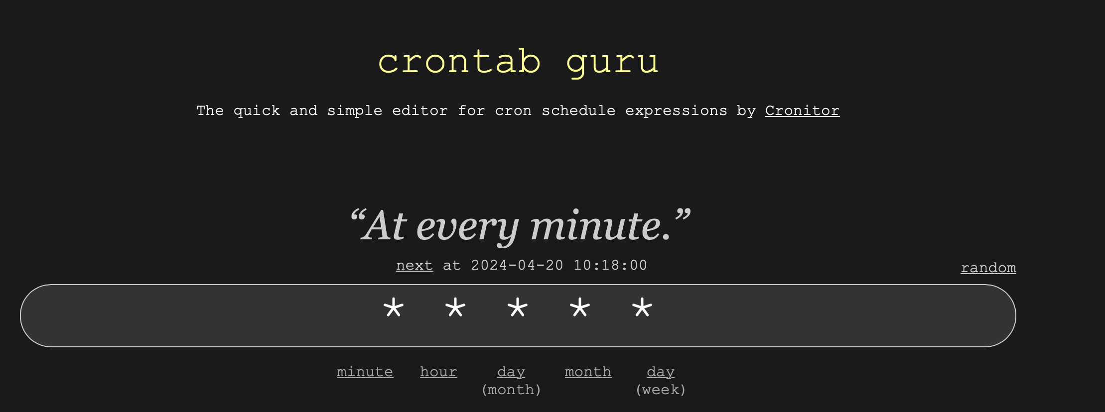

and schedules to run every minute with * * * * *
