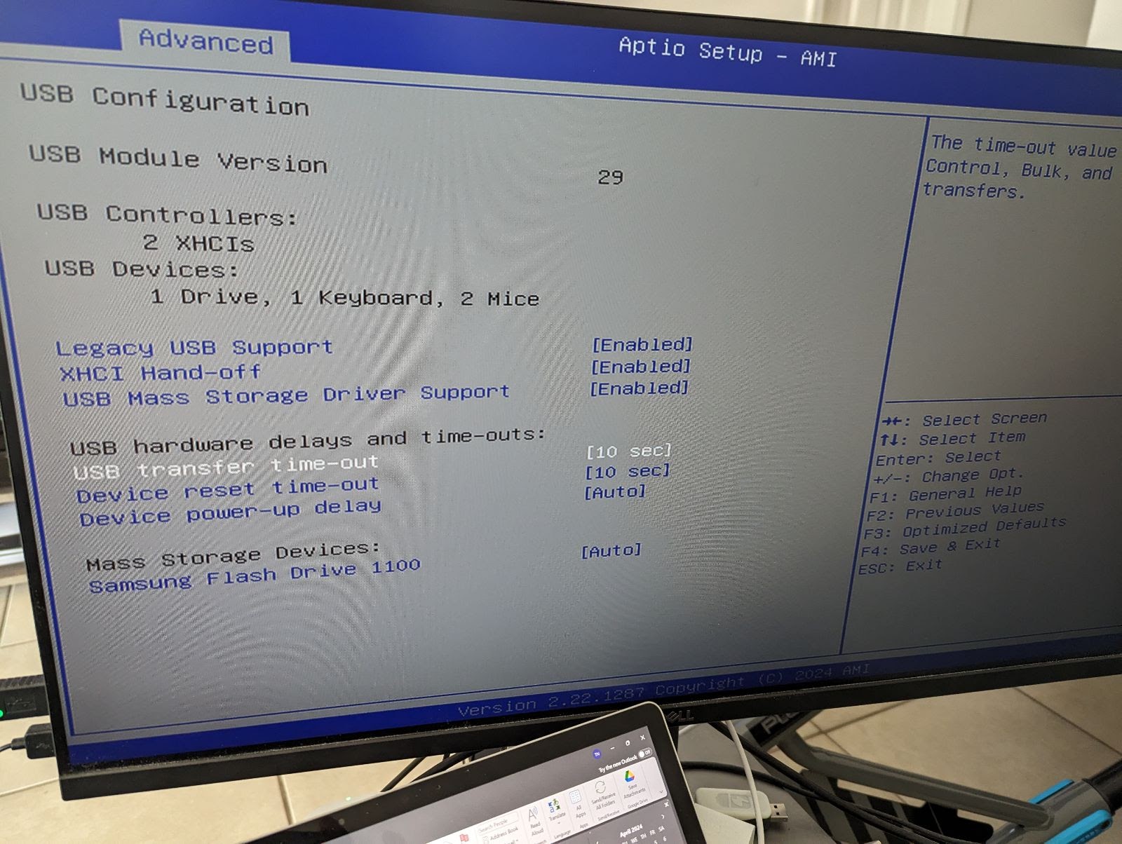

Hi All,
Thank you so much for your help and suggestions. I played around with THE BIOS settings as you all recommended and it turns out the culprit was the Bios setting "USB transfer time out.". By default, it was 20 seconds but I changed it to 10 seconds and somehow I am able to access the Webgui now....
I can't believe it was that little change that made the impact and was the source of my problem and headache. For my information, does anyone know what this usb transfer time out means and why it was the source of my trouble?
In any event, much appreciative to you for taking the time looking at issues and trying to help and thank you for pointing me in the right direction!
