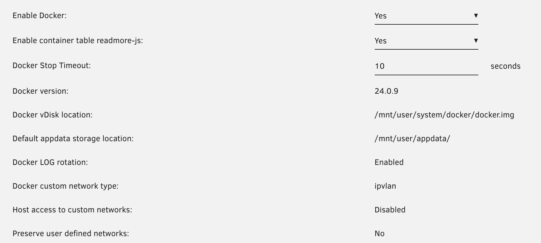

It does seems to still be using macvlan for br0.
For reference, here is my settings page:
Thanks JorgeB,
I followed the process to delete the docker image and recreate it, i am now seeing ipvlan in the output. This are now running again, ill report back as time goes by and we see if its stable or the problem persists.
