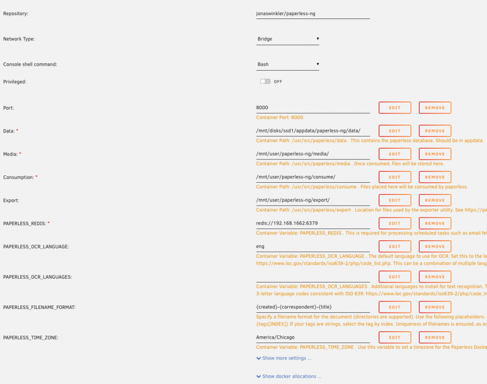

[Support] Paperless-ng Docker
I am not 100% sure about this since I don't really use it, and have only been using paperless-ng for a few days now, but the original version of paperless had a defined format for interpreting date, correspondent, title, tags, etc. from the filename. My guess is that paperless-ng uses this same logic. See here: https://paperless.readthedocs.io/en/latest/guesswork.html If you get your tags and corespondent text matching setup well you should not have to bother. It will find the info in the OCR text from the coument and set those fields along with the data automatically for you. Of course that doesn't always work - but its pretty good most of the time.
EDIT: I figured it out. It was exactly what it sounded like in the error... the file (.pdf) was missing. What I forgot is that some time ago I had an issue with a drive, and I messed up the replacement process. I ended up losing a number of files, including some from the paperless media directory. I assume the migration was failing because the file was referenced in the paperless DB but not there in the folder. I just put a "fummy" pdf in the folder with the appropriate name and started it again. It would then identify a different missing file. I repeated that process until I got all of the missing files replaced, and then the migration ran successfully! Thanks again for you work on this Docker. ---Leaving this for posterity, though I doubt anyone else will run into what I did--- Thanks for all of your hard work on this docker T0a. I am trying to migrated from an unraid based paperless container I have had for years (thepaperlessproject/paperless) and running into an issue. I may just be doing it entirely wrong.... I installed theredis container and then I made copies of my original papaerless appdata and user shares (with media, consume, & export dirs). When deploying the paperless-ng docker I pointed the appdata, consume, export, and media directories to those copies I made. When I start the docker I get this, and then the container stops: Paperless-ng docker container starting... Mapping UID and GID for paperless:paperless to 99:100 creating directory /tmp/paperless Apply database migrations... Operations to perform: Apply all migrations: admin, auth, authtoken, contenttypes, django_q, documents, paperless_mail, sessions Running migrations: Traceback (most recent call last): File "manage.py", line 11, in <module> execute_from_command_line(sys.argv) File "/usr/local/lib/python3.7/site-packages/django/core/management/__init__.py", line 401, in execute_from_command_line utility.execute() File "/usr/local/lib/python3.7/site-packages/django/core/management/__init__.py", line 395, in execute self.fetch_command(subcommand).run_from_argv(self.argv) File "/usr/local/lib/python3.7/site-packages/django/core/management/base.py", line 330, in run_from_argv self.execute(*args, **cmd_options) File "/usr/local/lib/python3.7/site-packages/django/core/management/base.py", line 371, in execute output = self.handle(*args, **options) File "/usr/local/lib/python3.7/site-packages/django/core/management/base.py", line 85, in wrapped res = handle_func(*args, **kwargs) File "/usr/local/lib/python3.7/site-packages/django/core/management/commands/migrate.py", line 245, in handle fake_initial=fake_initial, File "/usr/local/lib/python3.7/site-packages/django/db/migrations/executor.py", line 117, in migrate state = self._migrate_all_forwards(state, plan, full_plan, fake=fake, fake_initial=fake_initial) File "/usr/local/lib/python3.7/site-packages/django/db/migrations/executor.py", line 147, in _migrate_all_forwards state = self.apply_migration(state, migration, fake=fake, fake_initial=fake_initial) File "/usr/local/lib/python3.7/site-packages/django/db/migrations/executor.py", line 227, in apply_migration state = migration.apply(state, schema_editor) File "/usr/local/lib/python3.7/site-packages/django/db/migrations/migration.py", line 124, in apply operation.database_forwards(self.app_label, schema_editor, old_state, project_state) File "/usr/local/lib/python3.7/site-packages/django/db/migrations/operations/special.py", line 190, in database_forwards self.code(from_state.apps, schema_editor) File "/usr/src/paperless/src/documents/migrations/1003_mime_types.py", line 34, in add_mime_types f = open(source_path(d), "rb") FileNotFoundError: [Errno 2] No such file or directory: '/usr/src/paperless/src/../media/documents/originals/0001216.pdf' Applying documents.1003_mime_types... A snapshot of my docker settings is attached, and here are the directories: root@ur01:~# tree -d /mnt/user/paperless-ng/ /mnt/user/paperless-ng/ ├── consume ├── export ├── media │ └── documents │ ├── originals │ └── thumbnails └── temp 7 directories root@ur01:~# tree -d /mnt/disks/ssd1/appdata/paperless-ng/ /mnt/disks/ssd1/appdata/paperless-ng/ └── data └── index 2 directories root@ur01:~# Any idea what I am doing wrong? Thanks in advanced!
