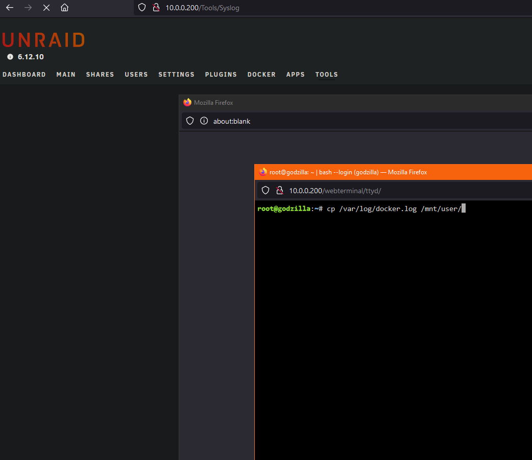

2. restart nextcloud container = Server Error
3. clicked on unraid gui >> tools to view syslog page only loads the frame/menu rest is empty and keeps loading
4. server pings
5. web terminal opens, I type "cd /var/us" <TAB>
6. cursor keeps blinking no autotap completions happens; CTRL+C or typing anyhting = nothing happens

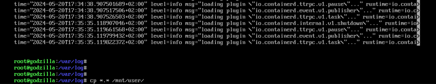

clock shows 19:31 at this moment (docker logs below per idrac I opened about 19:40)
7. opened iDrac where I am still logged in
8. top shows me nothing fancy. plex is doing its thing overall 1-8% CPU, list change like normal also iDrac Thermals 36°C
9. nano syslog shows me 2 mins after my freeze (timestamp: 19:33) that USB / HID device disconnects no clue tbh maybe my usb dongle from wifi keyboard timed out but it was 2 mins after freeze. Besides that about 10 mins before no entries
10. opened nano docker.log last entries 2h ago were i updated my dockers
11. still in idrac terminal I try to copy the logs typing "cp /var/user/log/*.* /mnt/user/" <TAB>
same freeze as before per webterminal. Cursor keeps blinking no further inputs get recognized.
12. had to hardreset per iDrac and that where the diagnostics come from.

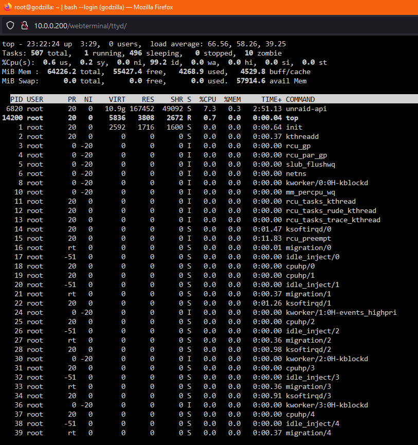

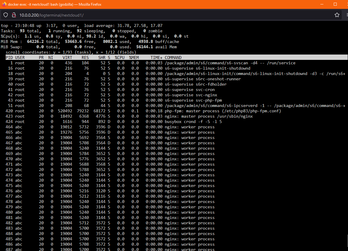

load average inside nextcloud LSIO docker: 32 rising
load average outside in unraid: 42 rising

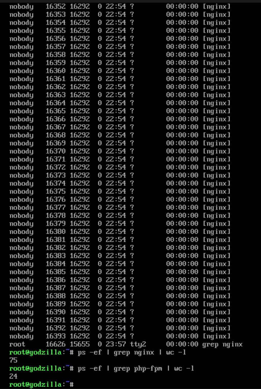

- suspended processes
- docker deamon killed with unraid load average of 66+

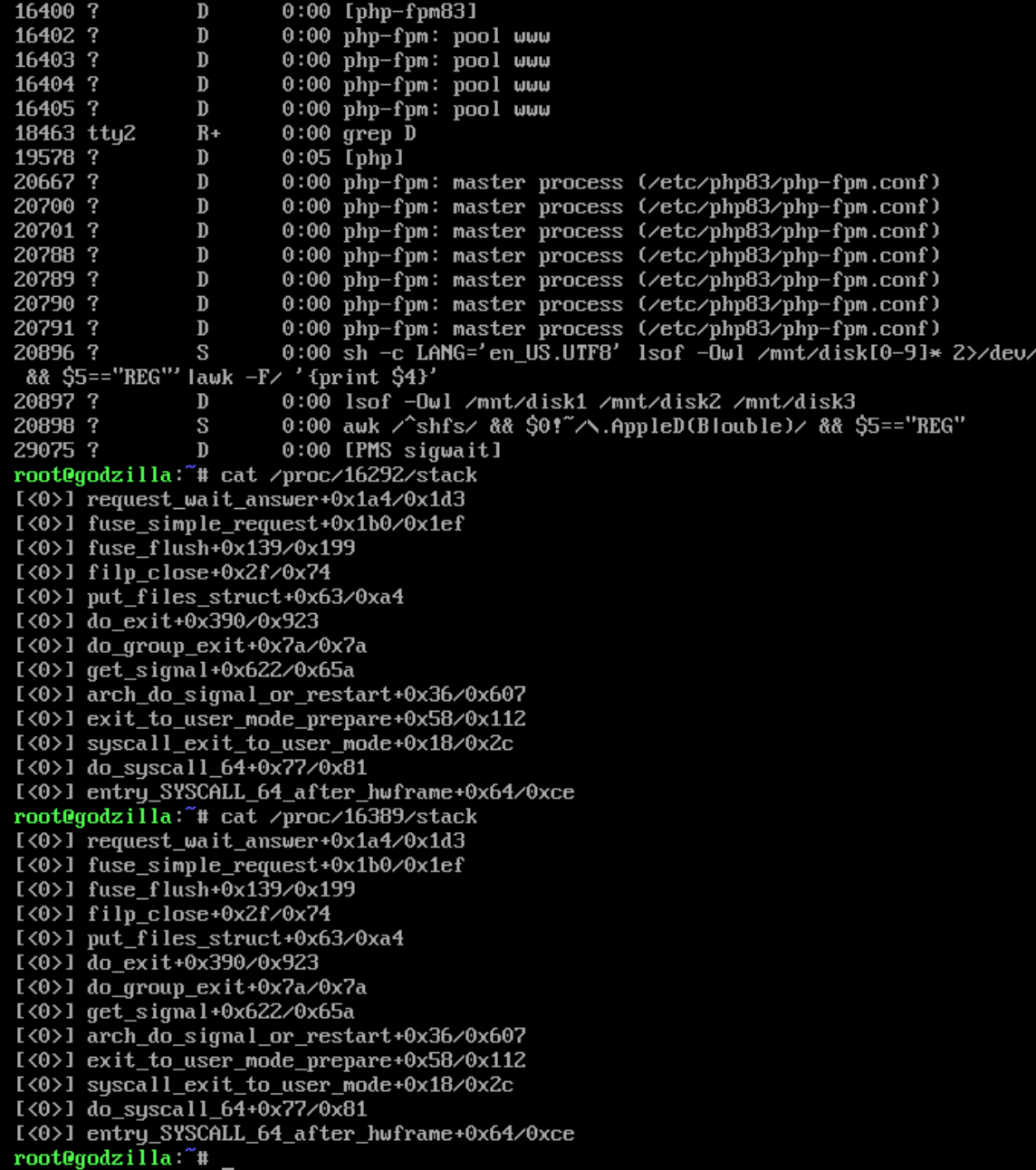

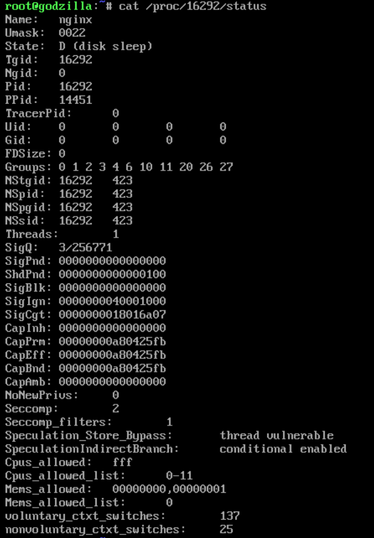

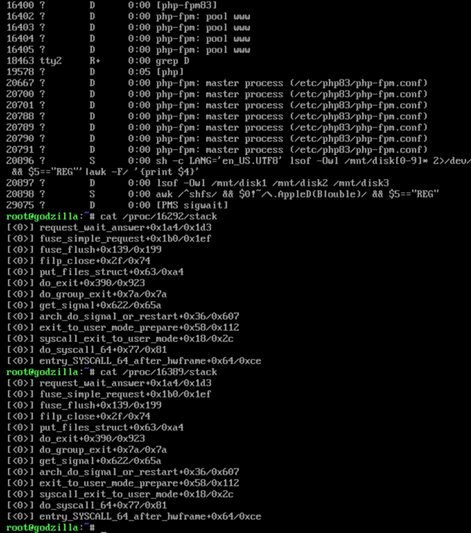

- nginx root process with 70+ sub process waiting for I/O
- php-fpm root process with 23 sub process waiting for I/O
- after reboot I paused parity check caused by my cold boot

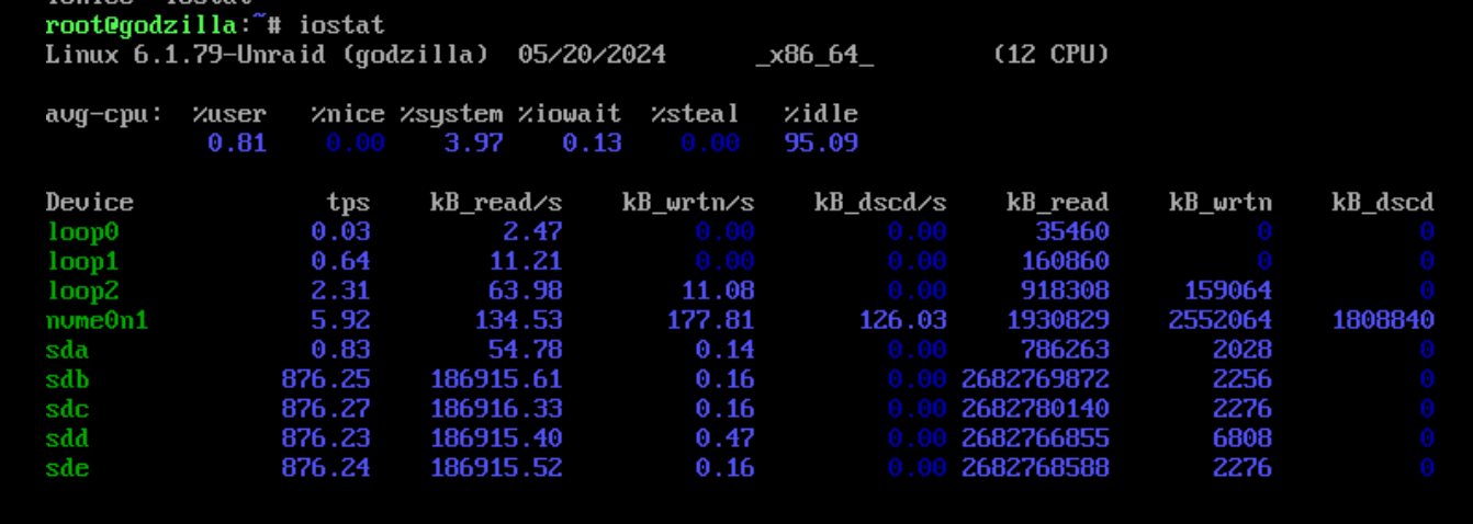

- istat showed 2.5TB on sda sdb ... from parity check I guess.

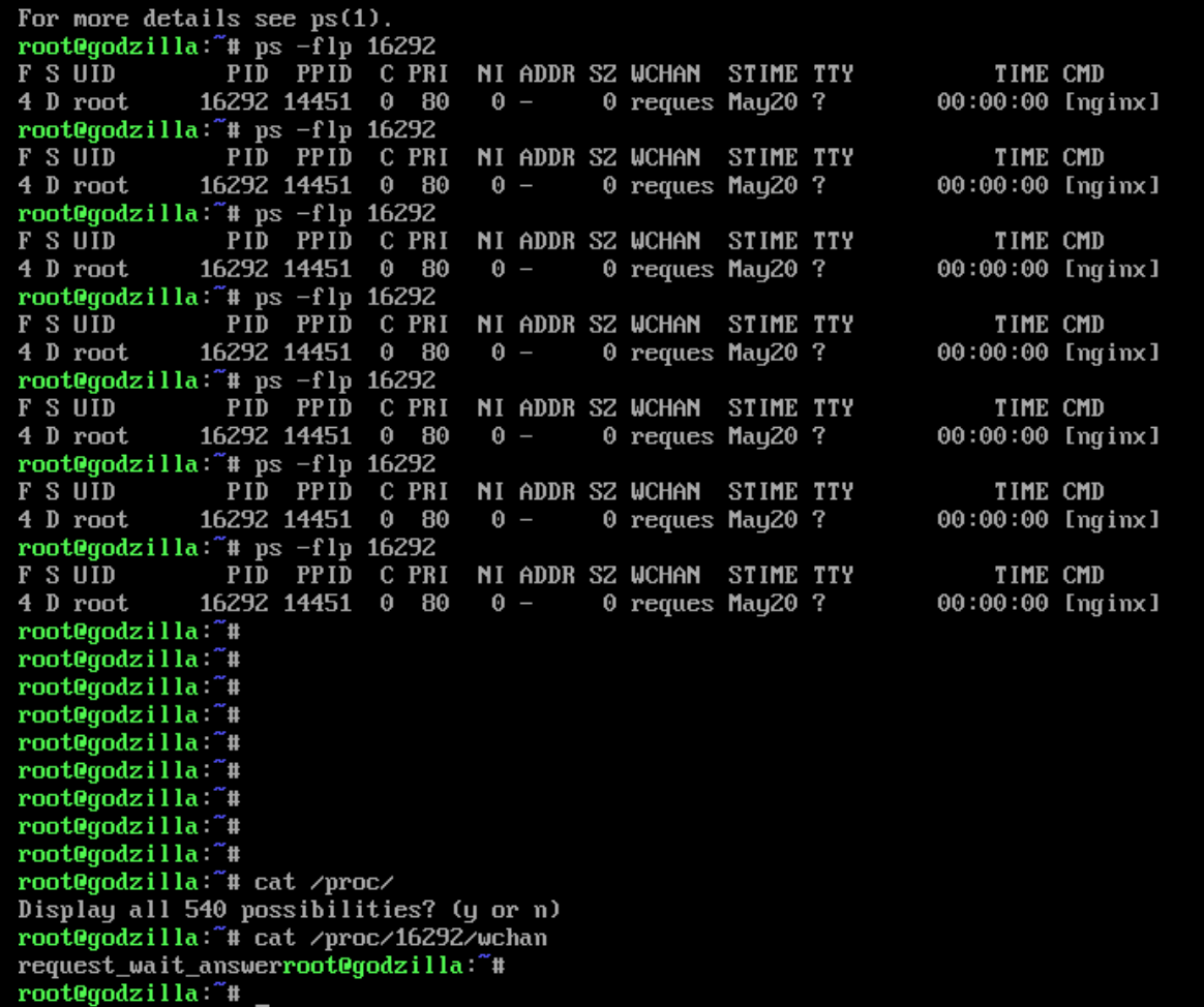

- any command towards array freezes = opened new tty*
- reboot hangs in Forcing shutdown since 15 mins
- oh and no: diagnostics did not work leaving it for 1h+ running in one tty.
- writing a file to /boot/ was no issue
a way more linux experienced friend guided me through a lot of stuff - see screens. Sorry but can not copy IDRAC remote screen.

Main issue is that nextcloud and swag docker are opening nginx processes again and again when communicating ,which all are waiting and nothing happens = load average rises.
In this SYSLOG nextcloud stopped responding pretty exact at 21:45:00.

What I found so far:
1. first issue I found was nginx worker process conf inside docker appdata was set to 56 - deleted is now 12 (6C/12T)
2. nginx processes are waiting indefinetly inside nexctloud & nginx after nextcloud gets started and used
3. nextcloud busybox crond is waiting indefinetly - still don't know why
4. nextcloud and swag have a huge amount of established connections

to close this topic for now:
a lot of processes between nextcloud-nginx and swag-nginx waiting for each other until everything is overwhelmed and unresponsive = CPU load avg rises into oblivion.
And they were not killable!
unraid CLI:
while [ 1 -eq 1 ]; do ps -ax | awk '{ print $1,"---", $3 }' | grep D | grep -v PID && sleep 2 && clear; done
to monitor waiting processes
PROCESS STATE CODES D uninterruptible sleep (usually IO)
I am trying do ditch nextcloud docker and all associated (postgres, swag, redis) and start anew with nextcloud-AIO. So not a specific fix since I have no clue why this happens. Also I want to change way too much around the whole infrastructure... switch, router, firewall etc. So I try nextcloud-AIO instead of fixing this (tried 15h+ I am not willing to invest more time since I do not see any light).
