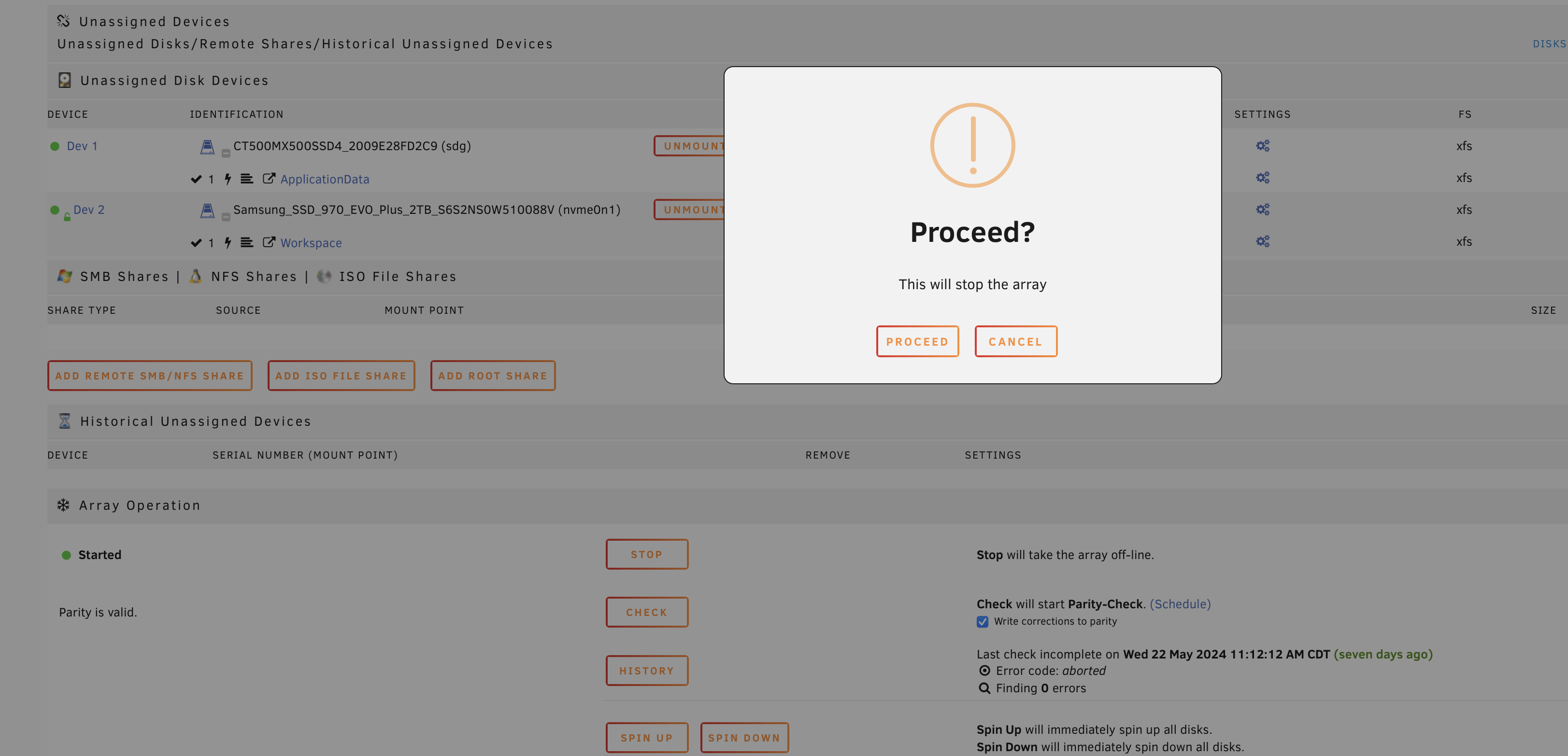

I am trying to stop the array in maintenance mode from GUI, but the proceed doesn't do anything. Is there option to stop it via SSH?
I was able to go to maintenance mode by rebooting the system to safe mode. I ran >> xfs_repair -v /dev/md2p1. Looks like it cleared reflink flags on inode during Phase 4. Not sure what it meant but the diagnostic in syslog no longer shows any issue. I will keep the system on for few days and see if the issue revisits. I will update again in few days with the progress. Thank you @itimpi

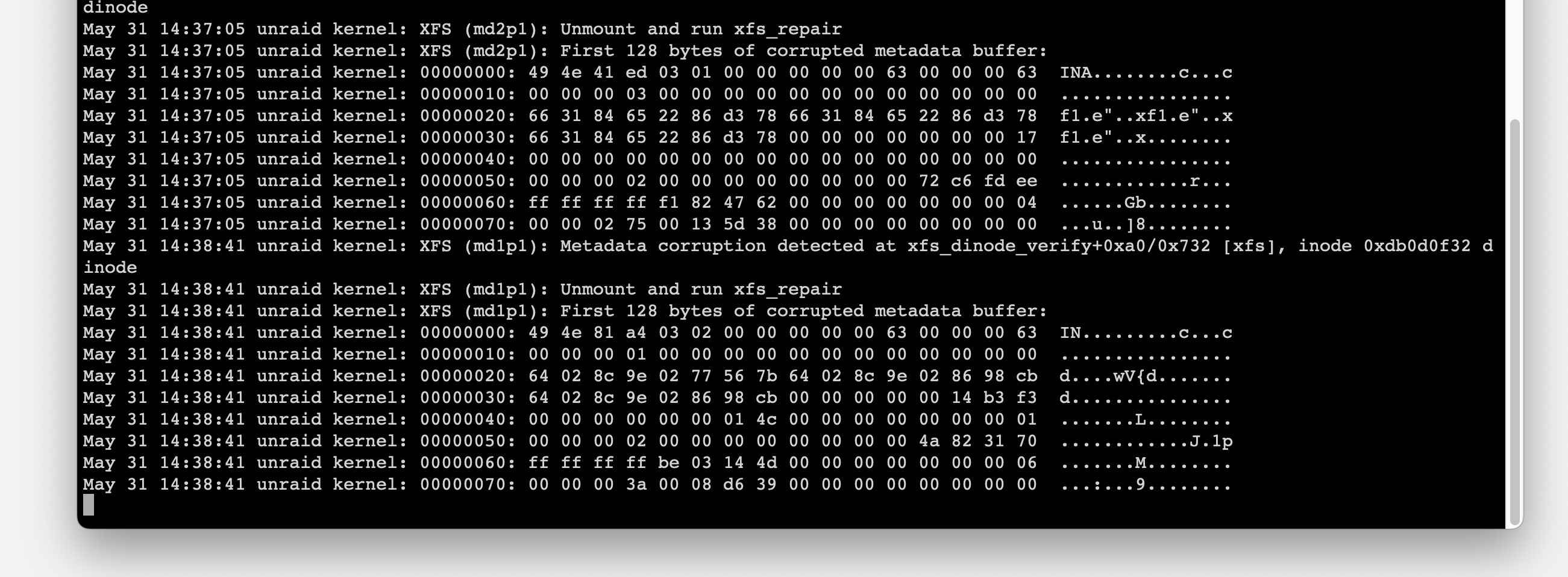

Now the xfs corruption shifted to disk 1 😢. Going to do same thing for disk 1.
In case you missed it there's also fs corruption on disk2.
I noticed that, so I ran xfs_repair for both disk 2 before and still see that. I could not find lost+found in disk root directory.
Am I using the right syntax:
xfs_repair -V -L /dev/md2p1
xfs_repair -V -L /dev/md1p1

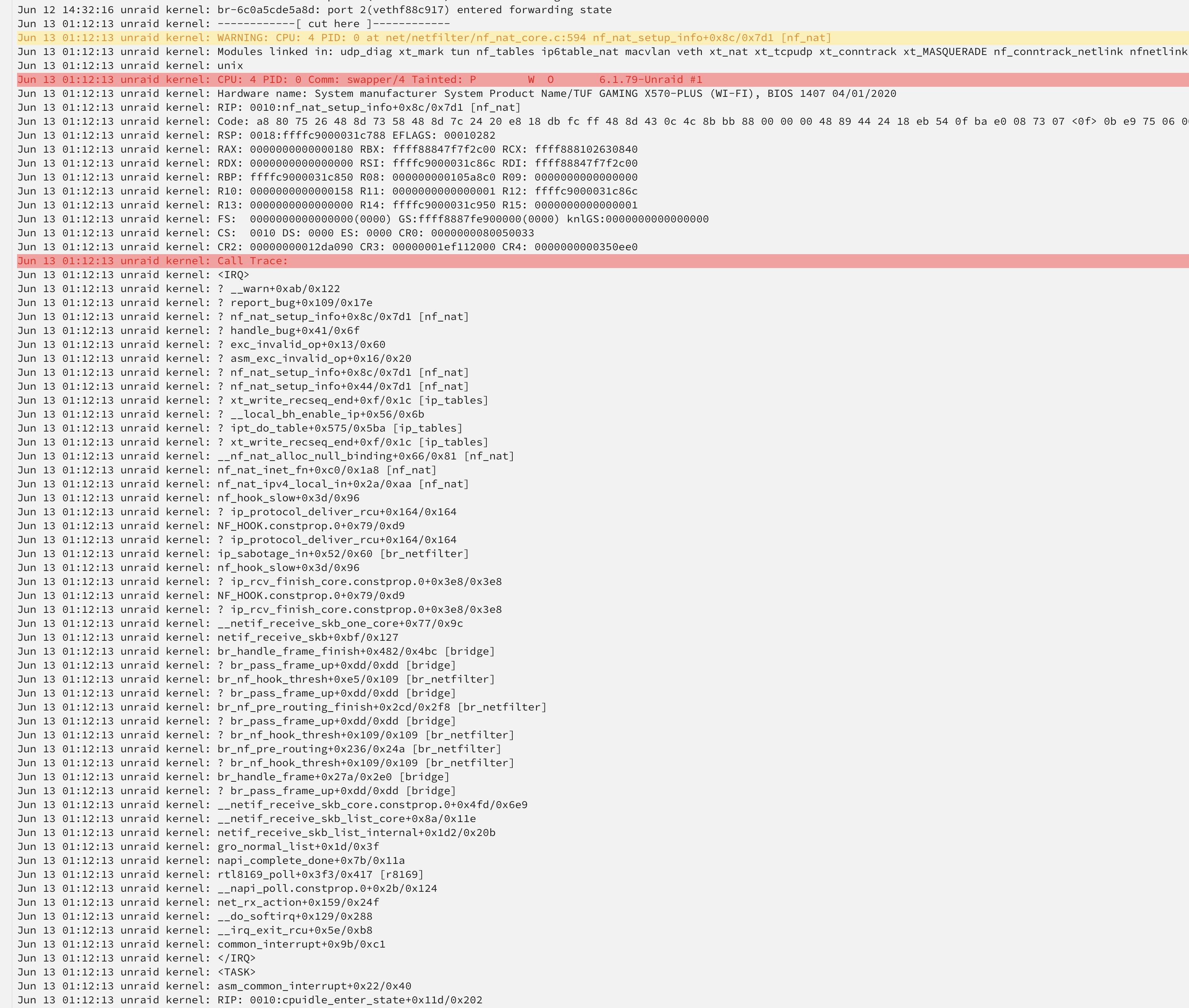

I am back, but server hasn't crashed 🤩..... yet. So I am in an aggressive monitoring mode. I am checking the syslog to see if I encounter any lines with red color or mention of error. I see there is some lines with kernel tainted in CPU 3 with some proccess ID lsof. I have no idea what it means, a quick google and my speculation suggests that the kernel is not in pristine condition. Can you check with your experienced eyes if you see any warnings or errors, that I need to worry? The diagnostics are attached.
unraid-diagnostics-20240605-2147.zip
There's a call trace, start by running memtest, or re-test with just one stick of RAM, if the same try the other one, that will basically rule out a RAM issue.

As suggested, I did memtest. I have two RAM sticks. I did the test again for individual RAMs and all tests are passed. It took long. What I did was after 6 successfull passes I stopped and exchanged the RAM and did memtest again for 6 passes. Is that the process, or should I let it continue? I don't know how many passes it needs to confirm that RAMs are fine. After that I rebooted the machine to unRAID and I see there are trace calls (like before) as attached. Any suggestions?
The point is that running memtest is only definitive if it finds errors.   What was suggested was that you run the server with less RAM sticks plugged in to see if you still get errors. not that you run memtest with less sticks plugged in.
Oh got it, I will give it another try with less RAM and run unraid for a while.
