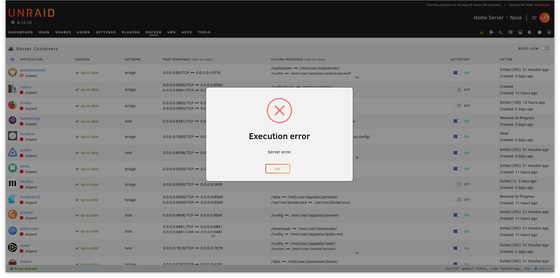

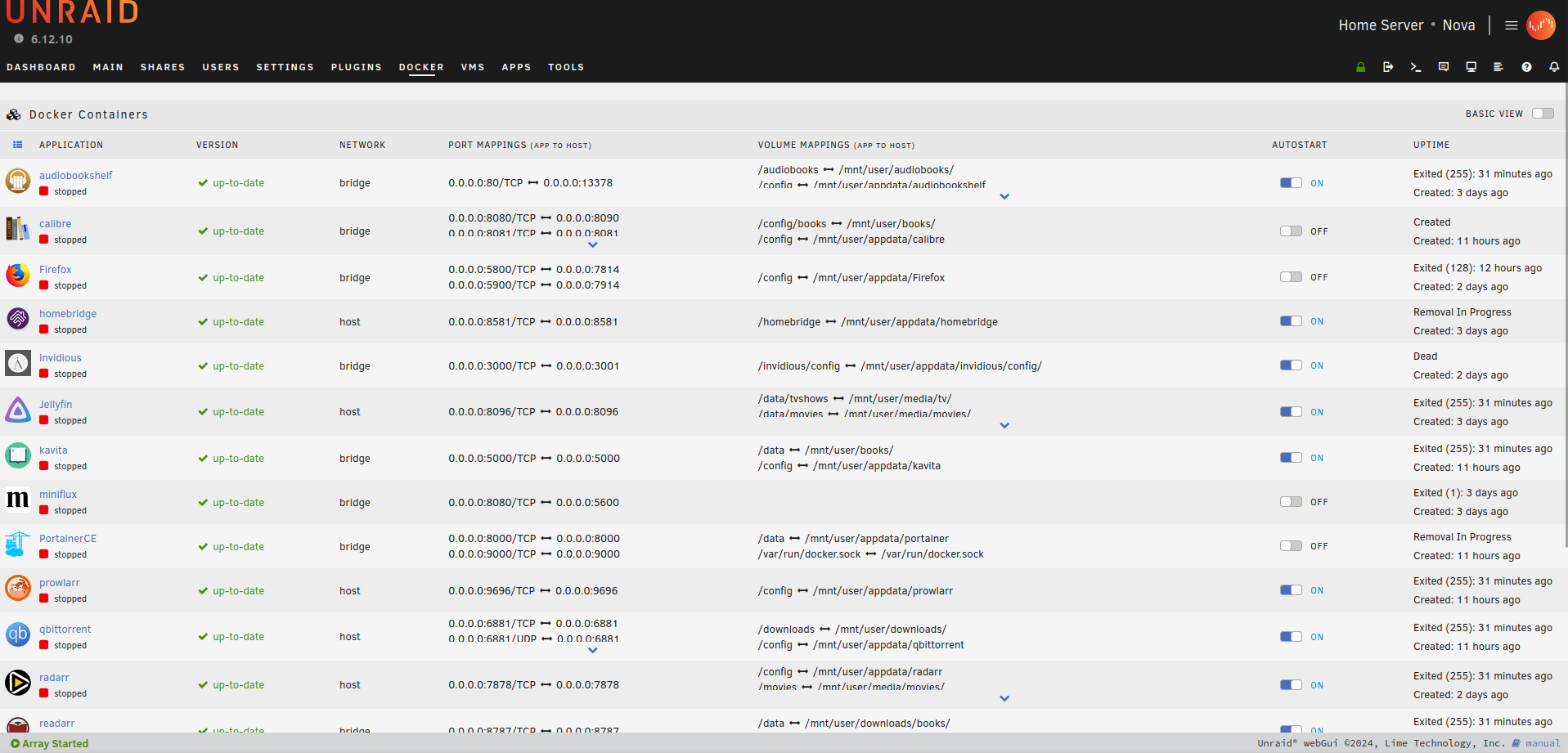

I have had several Docker containers setup and working for a few days until yesterday, when I decided to add a cache drive.

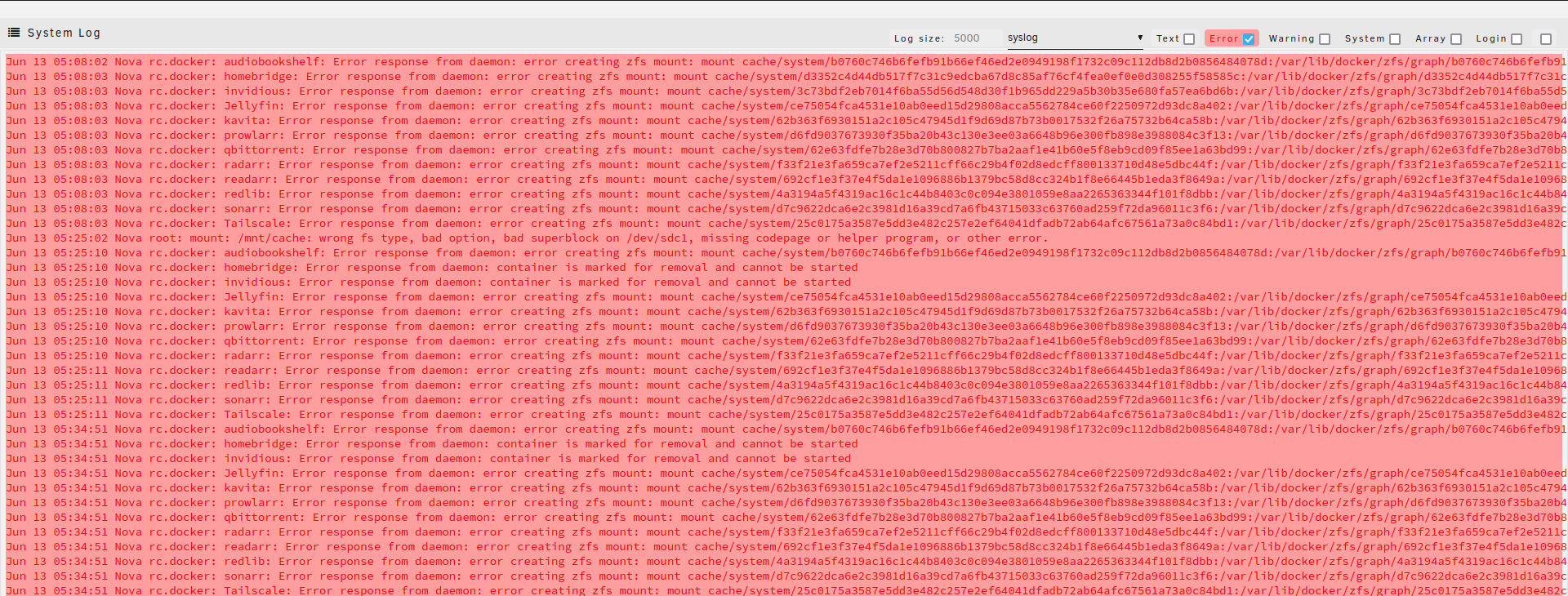

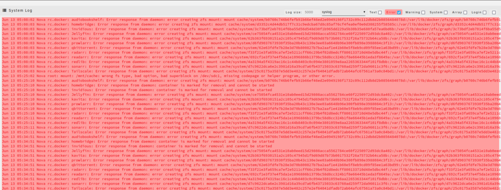

Things worked immediately after the drive was marked as cache. I think the problem may have started once the scheduled mover task happened somewhere around 3am. When I went to check on things this morning, I noticed all containers were stopped, despite them being set to auto start. I do have a screenshot of the system log and a couple more of the containers and errors I get when trying to start them.
Im hoping someone here understands what might have gone wrong and can help me figure out how to restore things back to normal.

Try changing to a docker image, docker folder sometimes has weird issues, and create re-install the containers from previous apps
https://docs.unraid.net/unraid-os/manual/docker-management/#re-create-the-docker-image-file
Then:
https://docs.unraid.net/unraid-os/manual/docker-management/#re-installing-docker-applications
Also see below if you have any custom docker networks:
https://docs.unraid.net/unraid-os/manual/docker-management/#docker-custom-networks

This was the solution, thank you very much.
