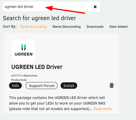

  • You have to wait until the new Unraid beta version is released. After it is released simply upgrade your Unraid system, reboot, go to the CA app and search for "ugreen led driver": and
  • Ah got it! Thanks for the clarification!   As said above, I still have to sort out a few things with the developer from the driver and a public release from the Uneaid beta so that we c
  • Just a little update, plugin is now done, now we just have to wait for a public beta so that you guys can test it:
and you will find the plugin.
Install the plugin and it should hopefully work.
Reason that I can't release is for 6.12.10 is that there are additional required dependencies which are only included in the next public beta.

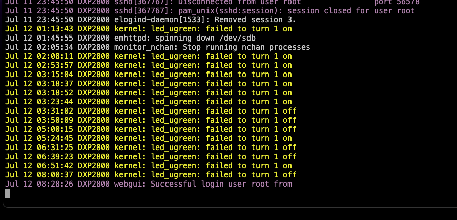

There is one more thing that I noticed this morning, after my disks had spin down the lights are still on, no off nor pulsing like in regular ugreen, also the logs have the following warnings.
Any ideas? Thanks
13 hours ago, Kraizel said:
Any ideas? Thanks
I already contacted the developer. Please create an Issue here, since my plugin is based on that repository.
This is expected for now, please also read that post:
