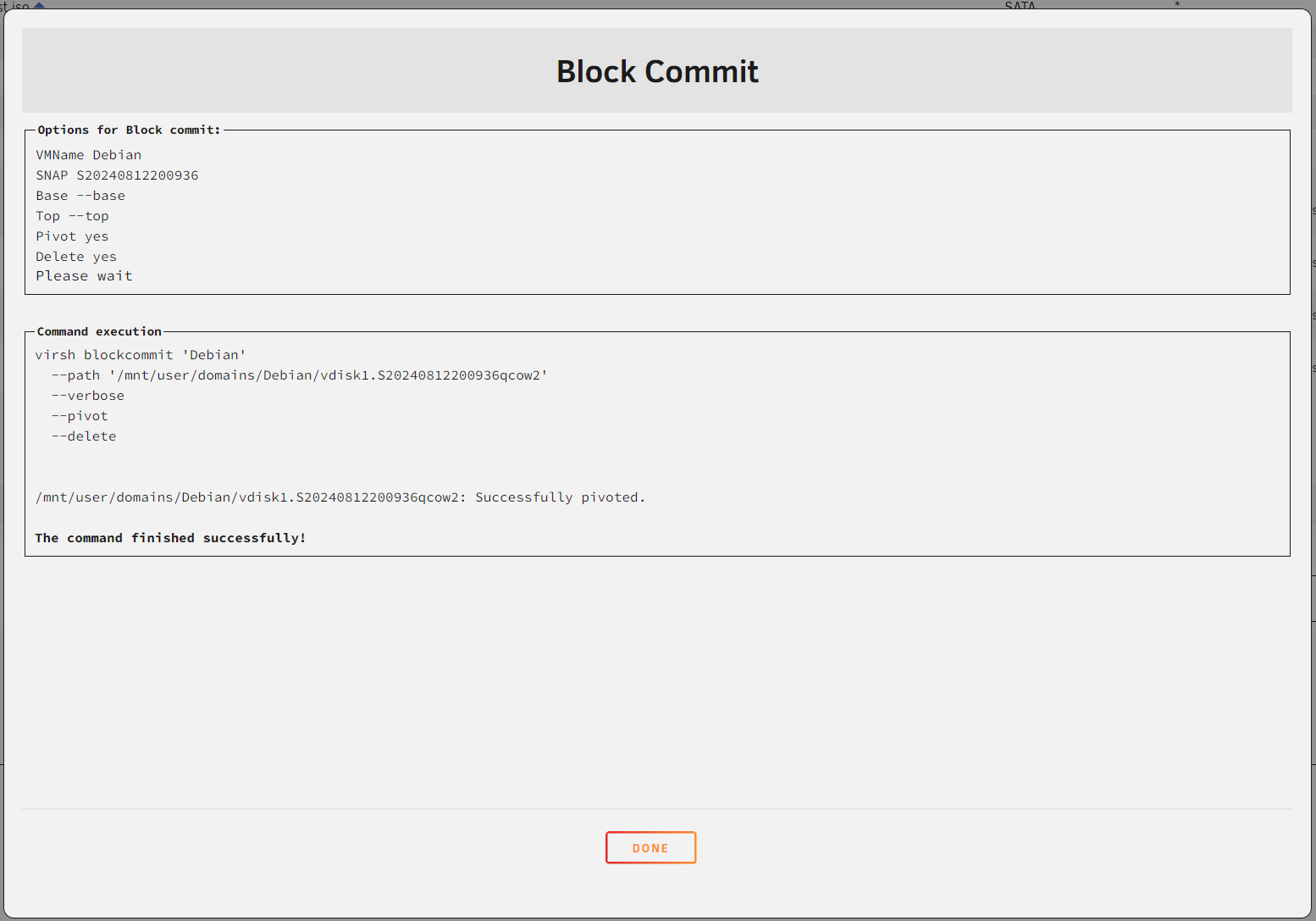

3 hours ago, bmartino1 said:
So my question is what does block commit and block Pull due and what is the use case.
Info on this post.

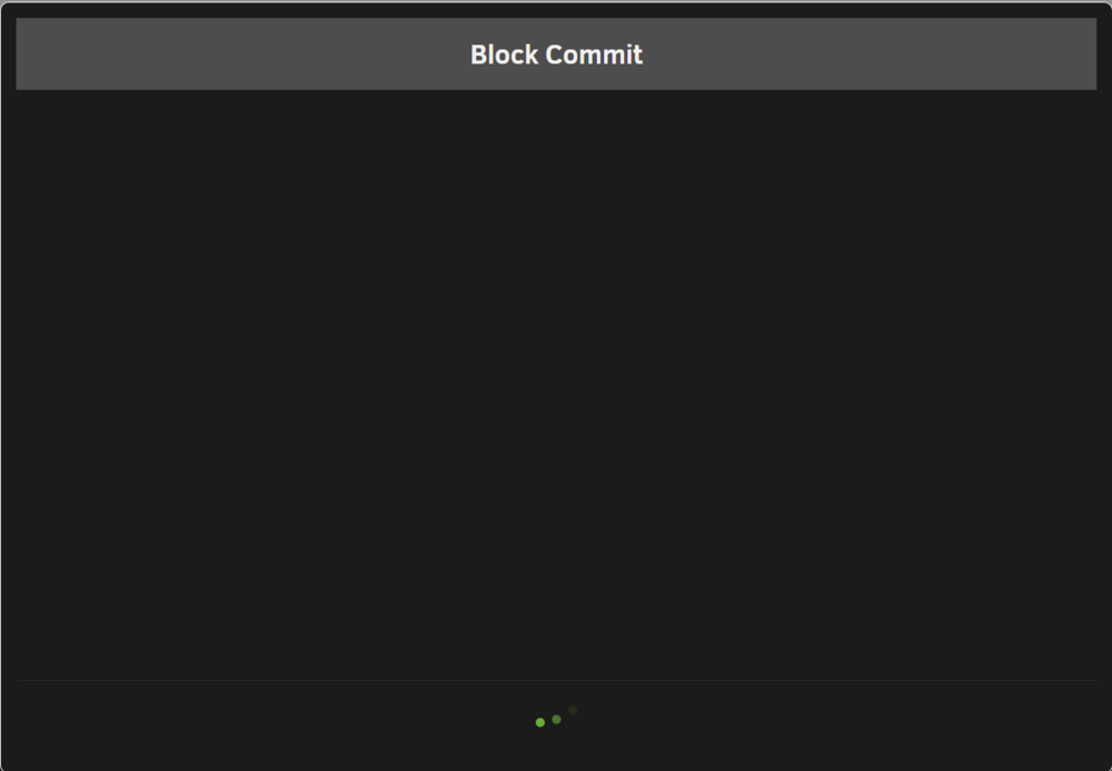

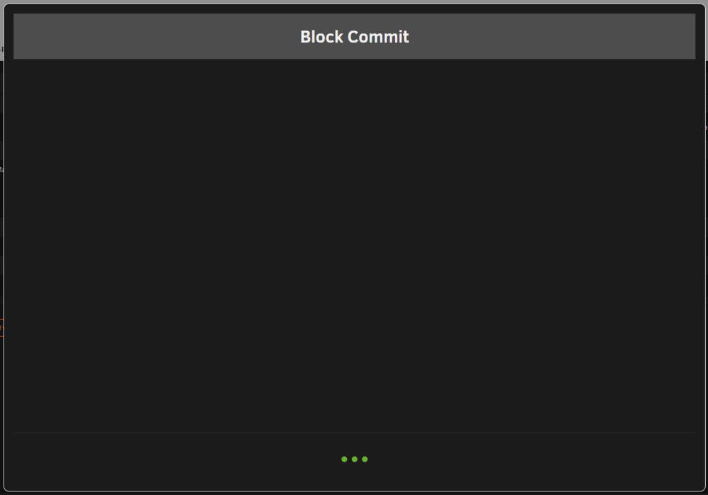

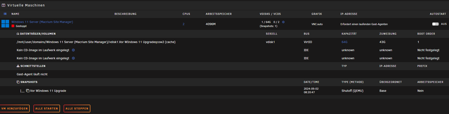

Hey guys, running unraid 7 beta 2 and made an snapshot of an windows 10 VM before upgrading to 11.
The upgrade went throught, and now i wanted to delete the snapshot and stay on the data the VM now is.
After reading threads the "Block commit" function is what i am wanting.
Started it, with the VM shutdown.
Sadly, the output window is empty, for over 15 minutes now (See picture).
The files disk files seems untouched:
Any hint's what i can do to merge those vdisk's?
Do i have to start the VM to get it merged?
(Dont want to mess it up :-)
Thank you
Edited by pOpYRaid
After half an hour my unraid was going to sleep.
File are unchanged.
Started the commit again, and again the window is empty (as on the first try).
Also the file are not changing (size and time stamp).
Please help?
Where are Log files for the commands launched?
thx
File are unchanged.
Please help?
thx
Should appear on from Page.
@SimonFin my case it's empty. It doesn't matter how often i start the commit:
Any hint's how i can proceed?
Maybe because my VM name and snapshot has spaces in it?
ok, i fixed it!
It was definitely the issue that i used KVM (domain) name with spaces!
I will call it a bug, you find articles on the net saying the frontend using libvirt should NOT allow KVM (domain) names with spaces.
I fixed it by doing the following:
  • Rename the maschine with the webgui to a name without spaces ("Windows11" in my case)
  • The snapshots seems to be gone and are not shown in webgui
    That's because the snapshotdb\{domain} folder is not renamed.
    Maybe that's another bug.
    I manually renamed it in directory "/etc/libvirt/qemu/snapshotdb/" from "Windows\ 11\ Server\ \(Macrium\ Site\ Manager\)" to "Windows11" (same as KVM name)
    After pressing F5 in the webgui on the VM tab, snapshots for this machine is shown again
  • Sadly "Block commit" does'nt work, it complains about missing base image
    Sure, the sanpshotdb has the wrong domain path in it.
  • I dirty/lazy fixed it by coping the new renamed domain folder to the old name.
    cd /mnt/cache/domains
    cp -r Windows11 "Windows 11 Server (Macrium Site Manager)"
  • After that the "Block commit" worked
  • Now you have to remove the New domain with "rm -R Windows11".
    Because the merged disk is at the old path.
    An than move the new vdisk back to the new KVM/domain name 'mv "Windows 11 Server (Macrium Site Manager)"/ Windows11'
    !! Attention !! Before you remove anything, be SURE that's the correct directory or make an backup.
    I have double checked the timestamps of vdisk1.img.
And yessss, it boots up!

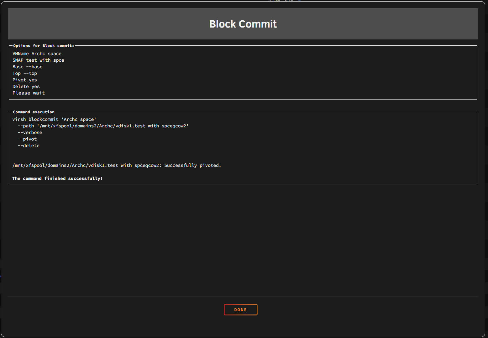

Will look at my code it maybe the snapshot with spaces i need to check.
@SimonF sorry, didn't know VM Engine is your code :)
Thanks for looking into it.
Works ok for me so far,
Can you confirm some details of names you used. I have tried with spaces all ok.

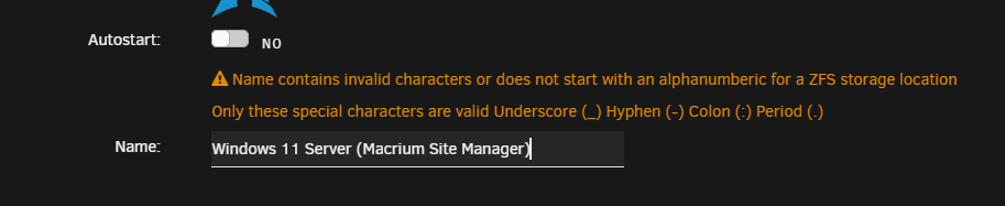

You running on a ZFS pool? This has been add to next release.

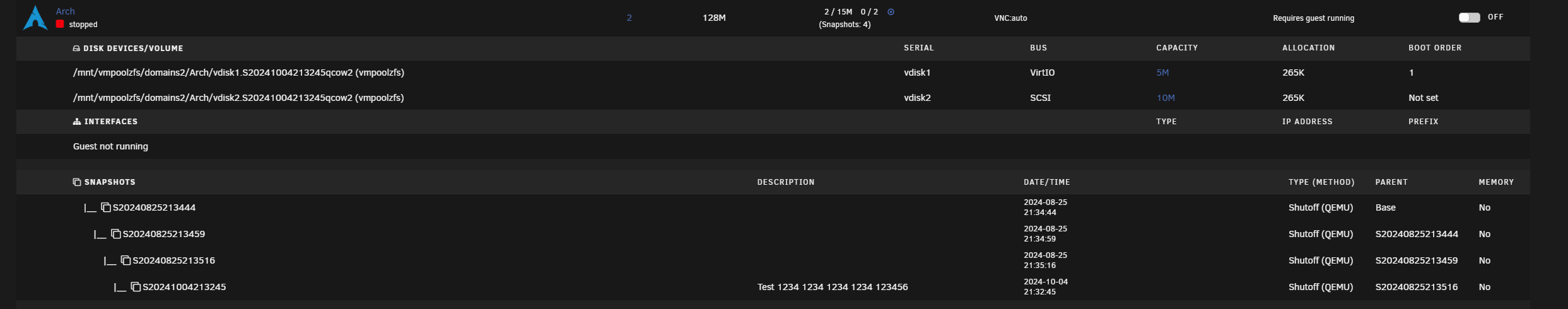

root@computenode:~# cat /etc/libvirt/qemu/snapshotdb/AAArch/snapshots.db
    "S20240820195913": {
        "name": "S20240820195913",
        "parent": "Base",
        "state": "shutoff",
        "desc": null,
        "memory": {
Nice, thanks a lot adding the character check!
No, I am running just an BTRFS JBOD Array with 2 disks and one parity disk.

Thx a lot, also for this change!
Will do something similar for rename

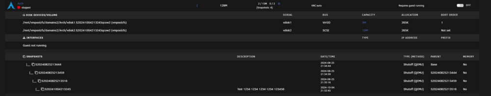

In poking around with the crashing VM issue, I deleted a few VM's and made some new ones. I am on a full ZFS system, and all VM's have/had snapshots taken. 2 x VM's that I deleted and removed still have remnants in /etc/libvirt/qemu/snapshotdb:
Is this expected and is it safe to manually delete them? Two of those folders no longer exist as a VM (so I assume the snap shots must be gone as well, right?).
Another thing, I noticed weird spacing issues on the VM snapshot names. I used regular spaces and parenthesis and got lots of white space it looks like.
And finally, while I have you 🙂 I'm sure you're already aware, but the ability to snapshot breaks if you enable clipboard functionality. I had previously found a bug report online for it somewhere, seems like someone picked it up and then it went silent.
Edited by cybrnook
Yes snapshots are in the domains path, it is safe to remove from the snapshotdb. I will check the code.

Side note, I modified manually the snapshots.db file for my EnGenius Fitcon VM as an example and removed the parenthesis as well as minimized my spacing to a single space in the "desc": and that brought the formatting back in. (Browser is Edge Chromium):
Maybe something as simple as wrapping in ' ' instead of " " ? 🤷‍♂️
Edited by cybrnook
If copy and paste is enabled you should get this error if you try to snapshot if running.
The same table format is used at the disks and may not be wide enough for description so starting working on new css for snapshot table.(WIP)
@SimonF for the clipboard error, yes agreed and I think I got an error/warning similar to that when I tried to make my first snap on a VM where I had clipboard functionality enabled (as I normally had done in the past, so didn't think much of it). The head scratcher I had was trying to decipher what the warning/error was telling me and equating it to having to disable the clipboard. That's where google came in handy. I didn't realize that warning was put in by you and not just a generic one being provided from the subsystem.
This is that link I found that pointed me to the clipboard. Seems it was a known issue, but perhaps abandoned for a fix? https://gitlab.com/qemu-project/qemu/-/issues/1380
For the spacing, would be greatly appreciated at least for verbose folks like myself who run in debug mode 🙂
Edited by cybrnook
