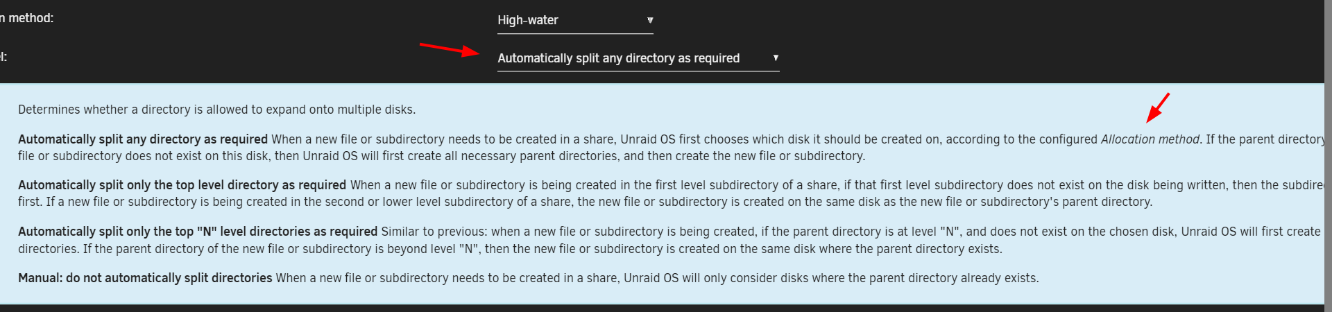

July 11, 20242 yr Hello! I have similar question as the original thread maker. I have complete rebuilt my server and my disk setup is following Disk 1 14TB Disk 2 10TB Disk 3 10TB Disk 4 10TB And I choose under High water, automatically split any directory as required. But I have same problem when I copied my files to the server it start with the largest disk and then it was 30% full it went to the next disk and filled 30% and so on. I know a long time ago I could fill the disks simultanously I mean it writes to all the disks at the same time and filled them equally. Becuase I need fast access to my files as I have my family using plex to watch movies. Thanks in advance for any help in this matter.

July 11, 20242 yr Hello! Many thanks for you answers. From my understanding of "automatically split any directory as required" that I thought it was written a little bit of data to every disk. I understand that will spin the disks as it is used and that consumes more energy but that´s a trade of that I´m willing to take. As Archonw mentioned in that case a cache drive is needed. I will look into that. Thanks again for all the help.
