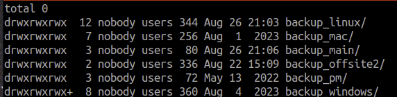

Post the output from:
ls -l /mnt/disk1
Here you go.
Those permissions are correct, except backup_windows, IIRC the + means there are additional ACL permissions, but I don't think Unraid supports that, though it may not be a problem.
