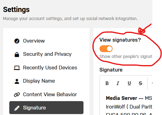

For example of what some folks use, turn on the signatures in the Forum posts as many of us list what we are using for our Unraid servers.  To display the signatures, click on your screen at the very top right of any forum page.  From the dropdown menu, pick "Account Settings".  Then look for "Signature" in the left hand block and click on it. Then toggle this switch:
