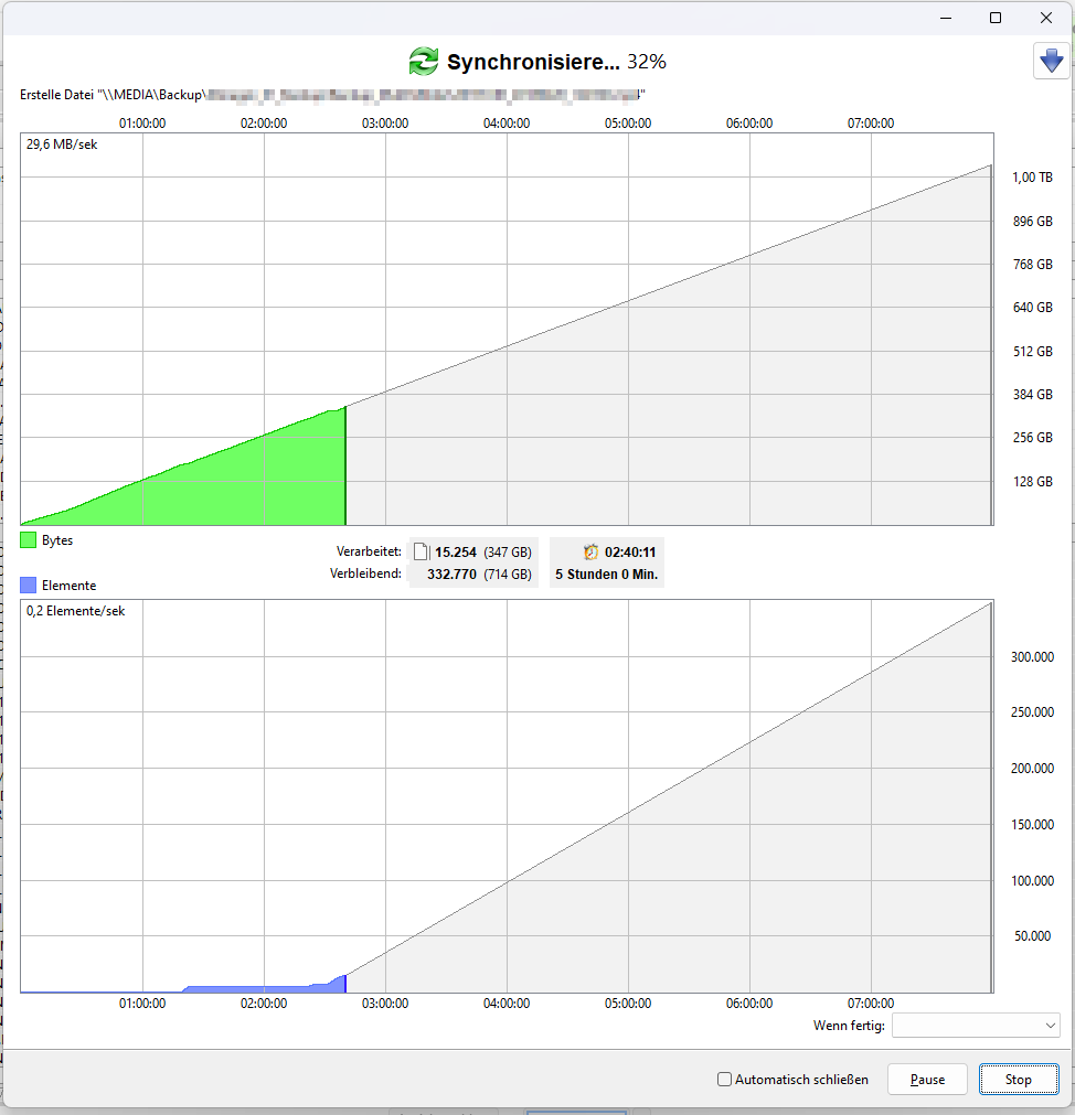

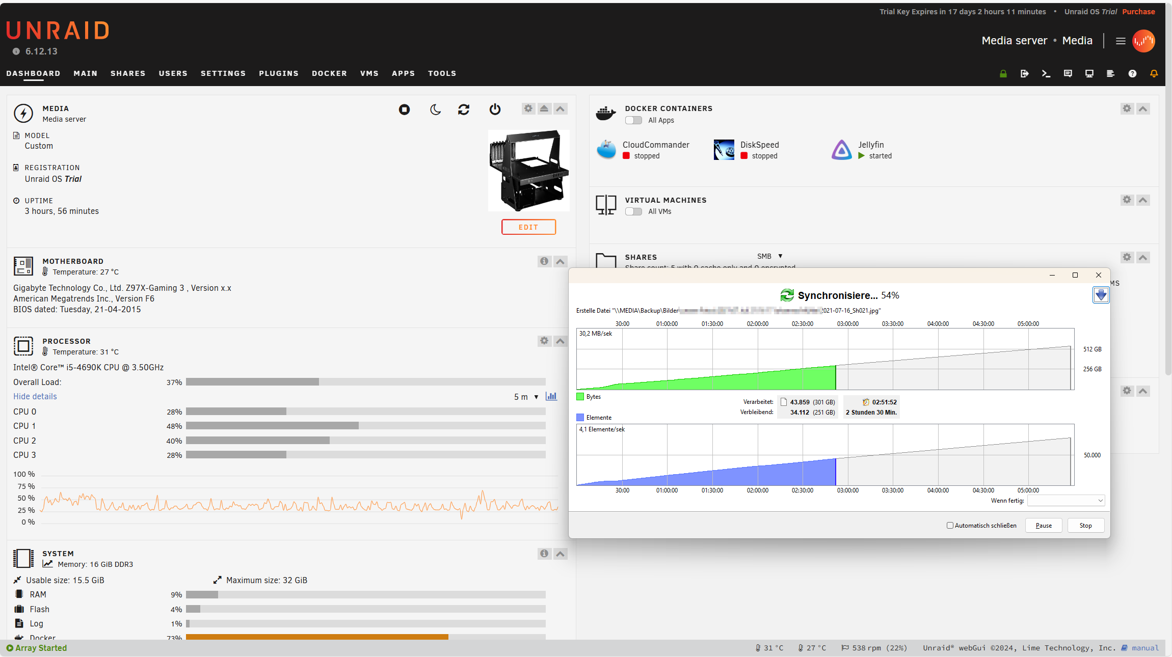

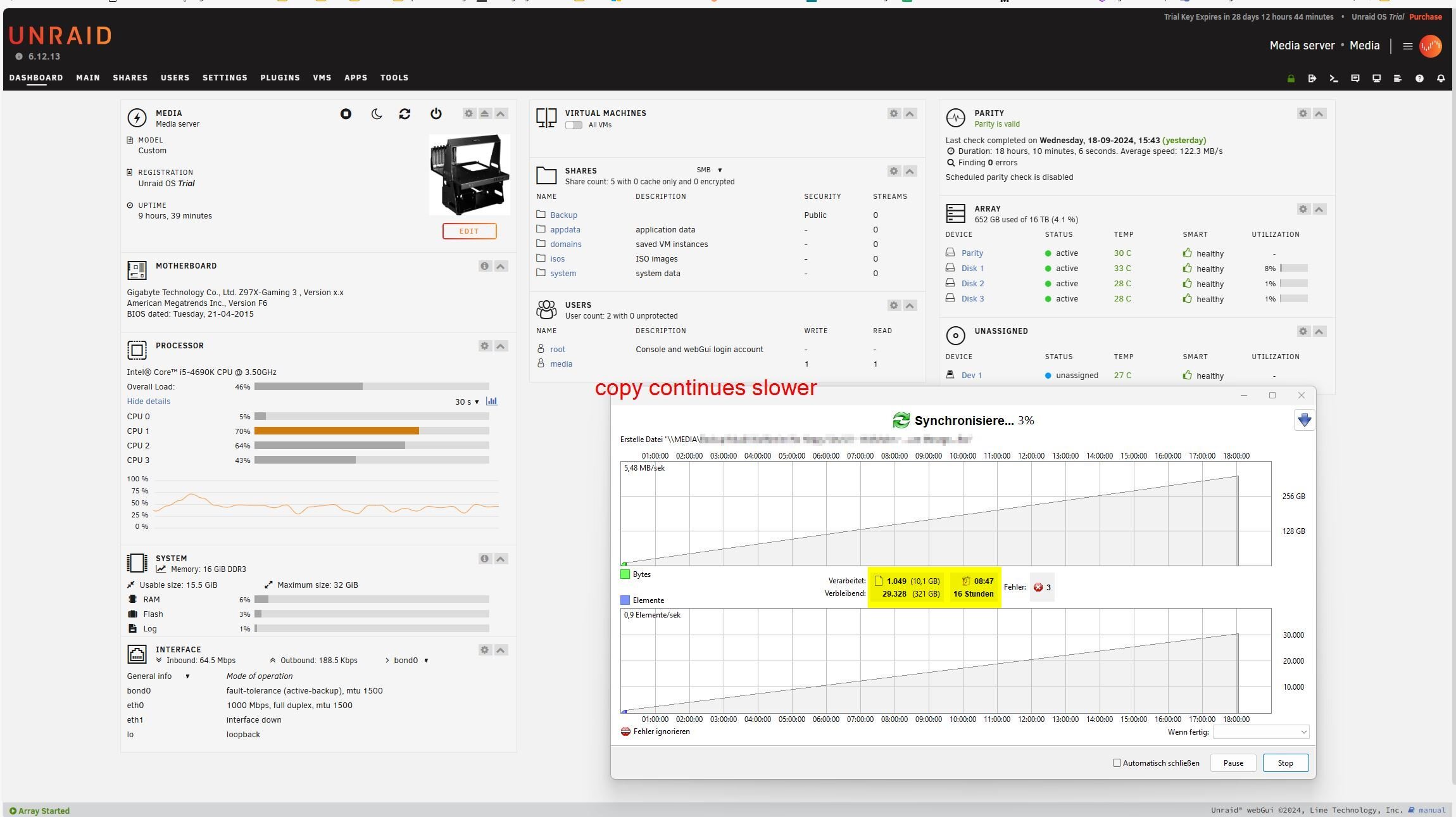

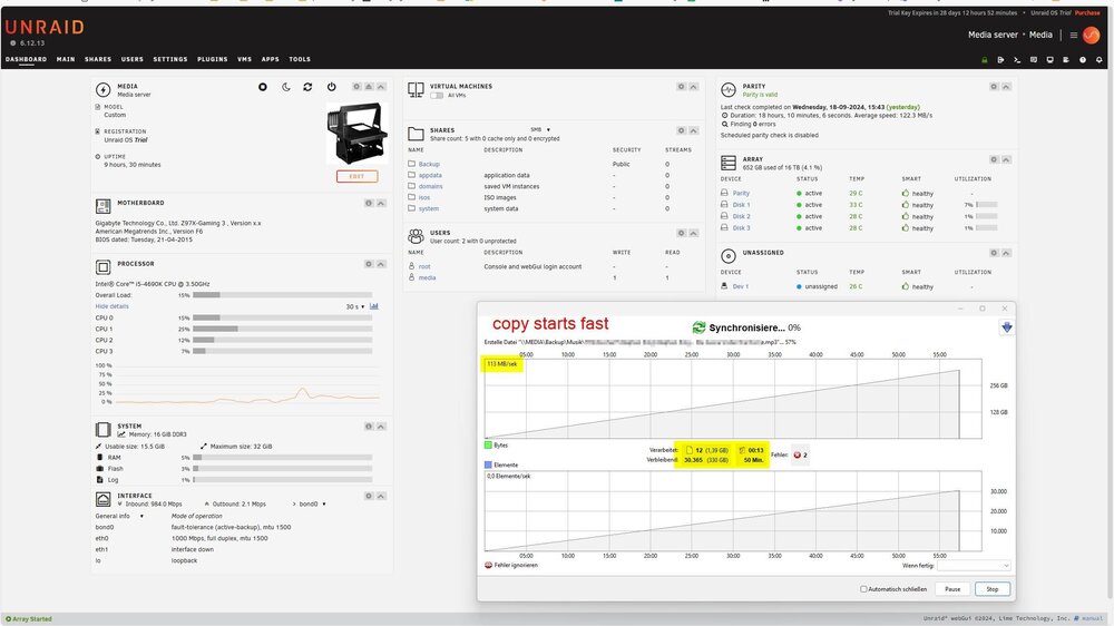

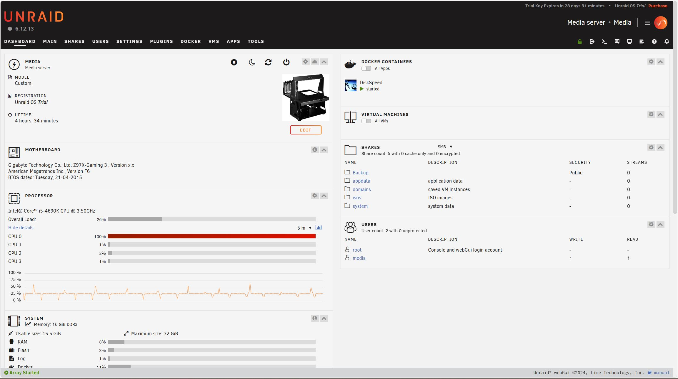

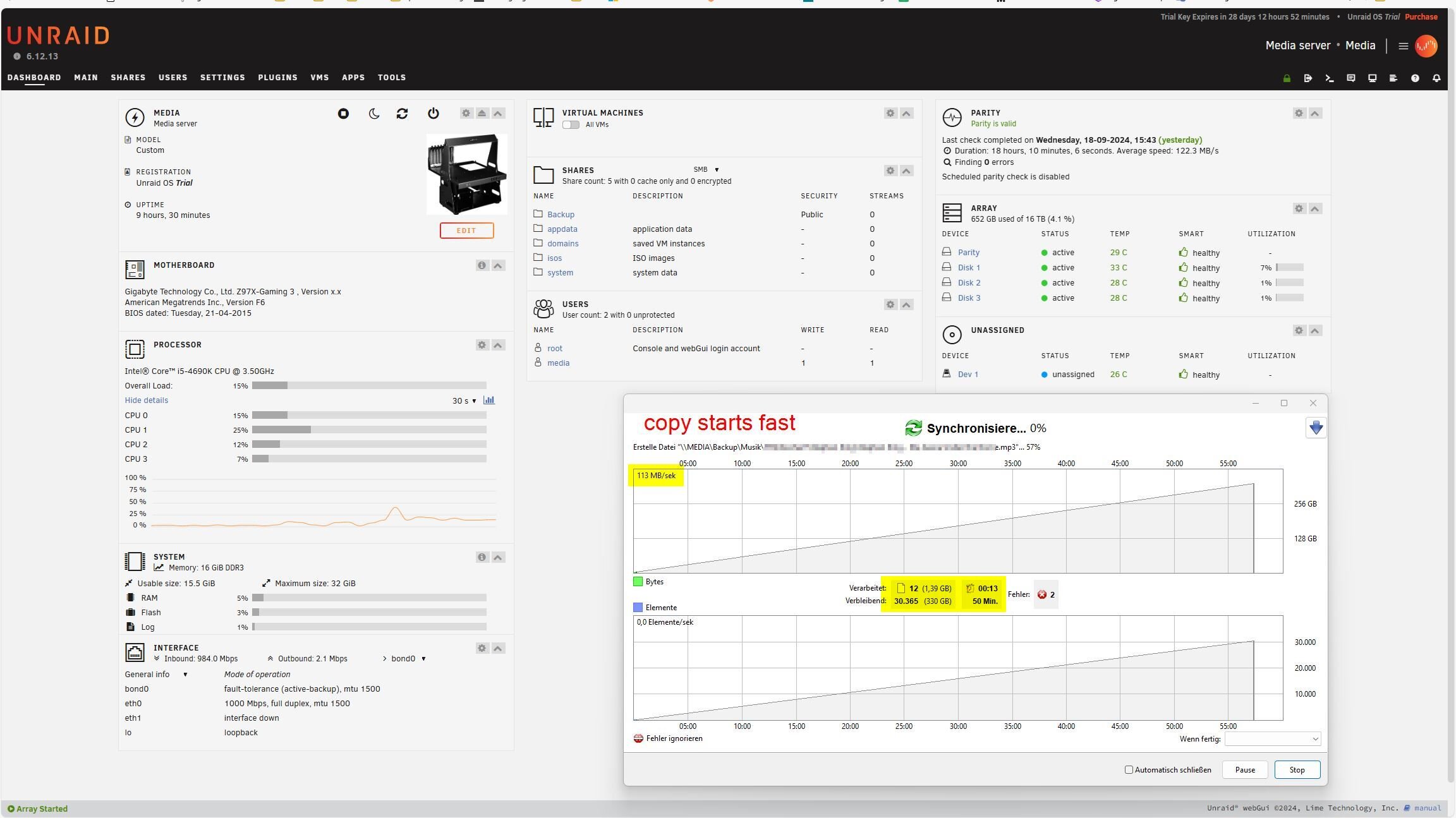

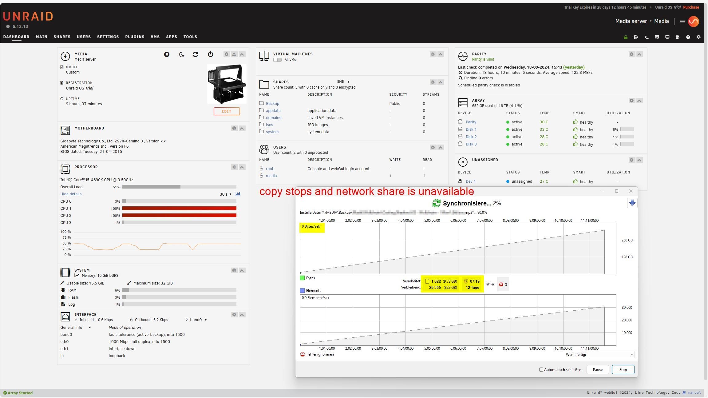

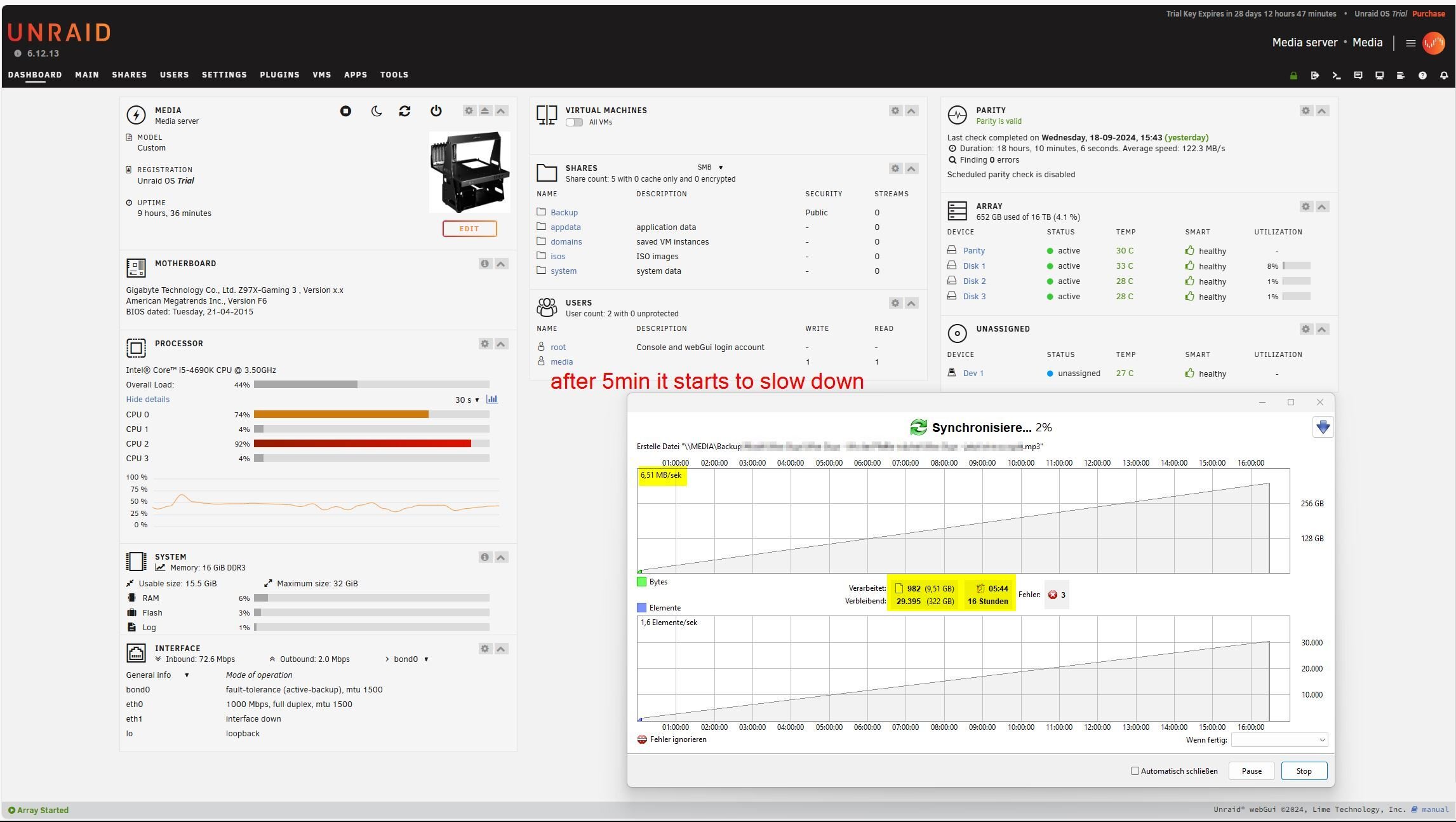

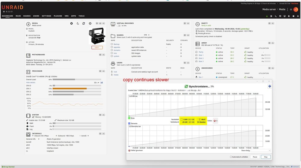

When I copy data to the share (via Windows 11 client samba share) the transfer rate starts at ~100 MB/sec. The CPU load is around 20% (according the dashboard). Around 2mins later the transfer rate drops significant down to below 10MB/sec and it even comes to stop. The CPU load on 1-3 CPU cores reaches 100% (it varies). Finally the complete system stucks, samba share disconnects, Dashboard reponds slow etc.

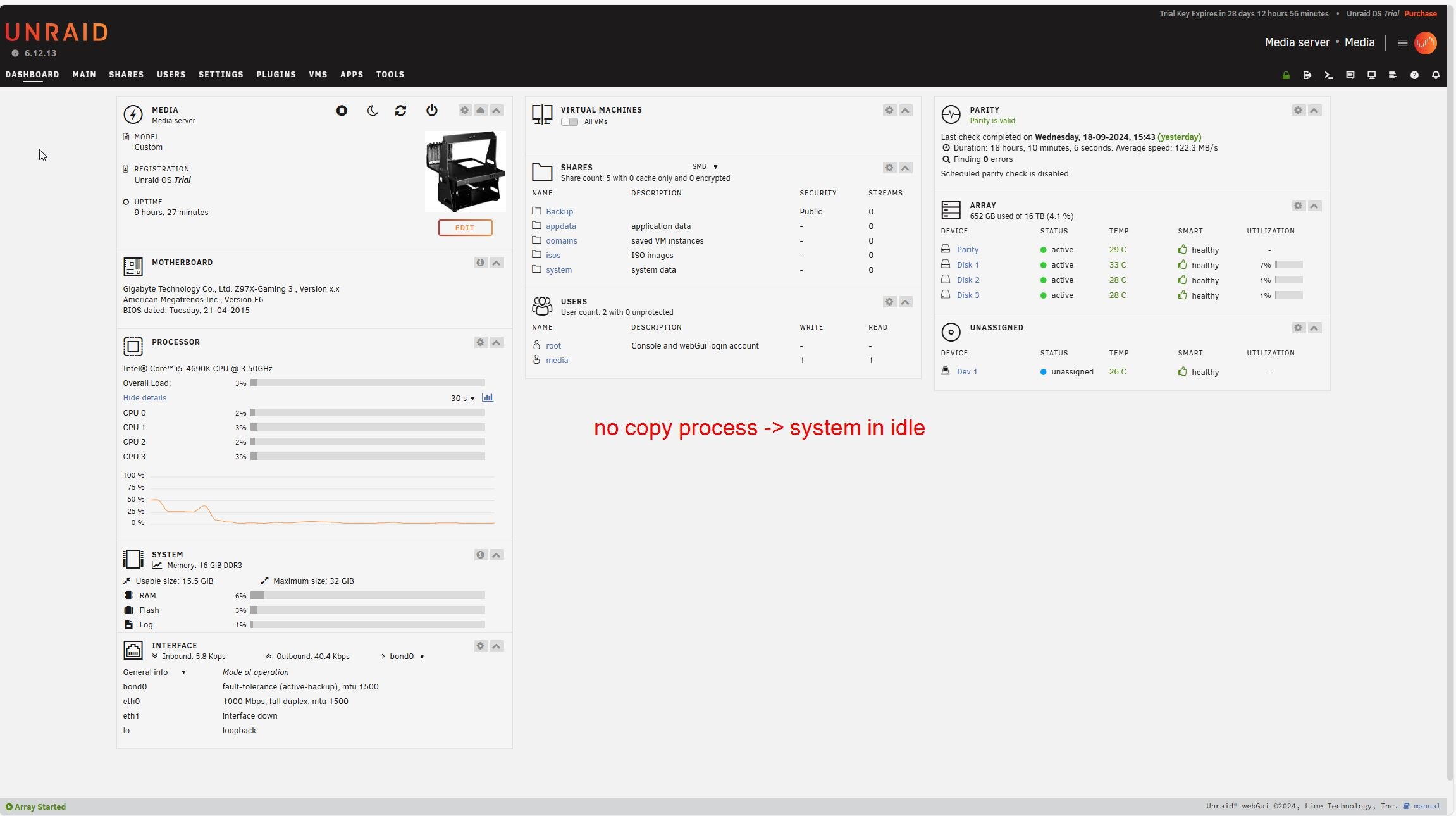

If I stop the copy process, the CPU load is back to idle (~7%).

Unraid5_copy_slower.thumb.jpg.f92e3137ec87d9e350f9c825808ce194.jpgUnraid4_copy_stops.thumb.jpg.11de7b01b293f87a6ad679d4ad876300.jpgUnraid3_copy_slower.thumb.jpg.8b12862aaf8587b2cc7e32cf17a127d6.jpgUnraid2_copy_start.thumb.jpg.6b8b140c866d2cfa73d35acbe7d6236e.jpgUnraid1_idle.thumb.jpg.fe65cbc7e58385676a59ffa347a278d0.jpg

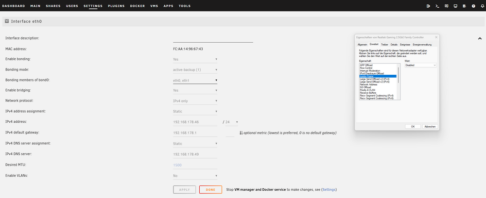

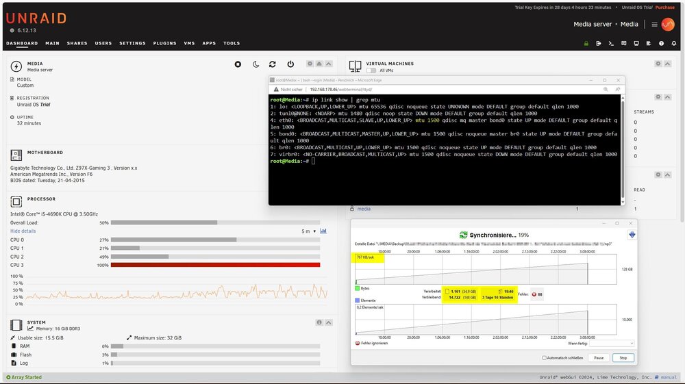

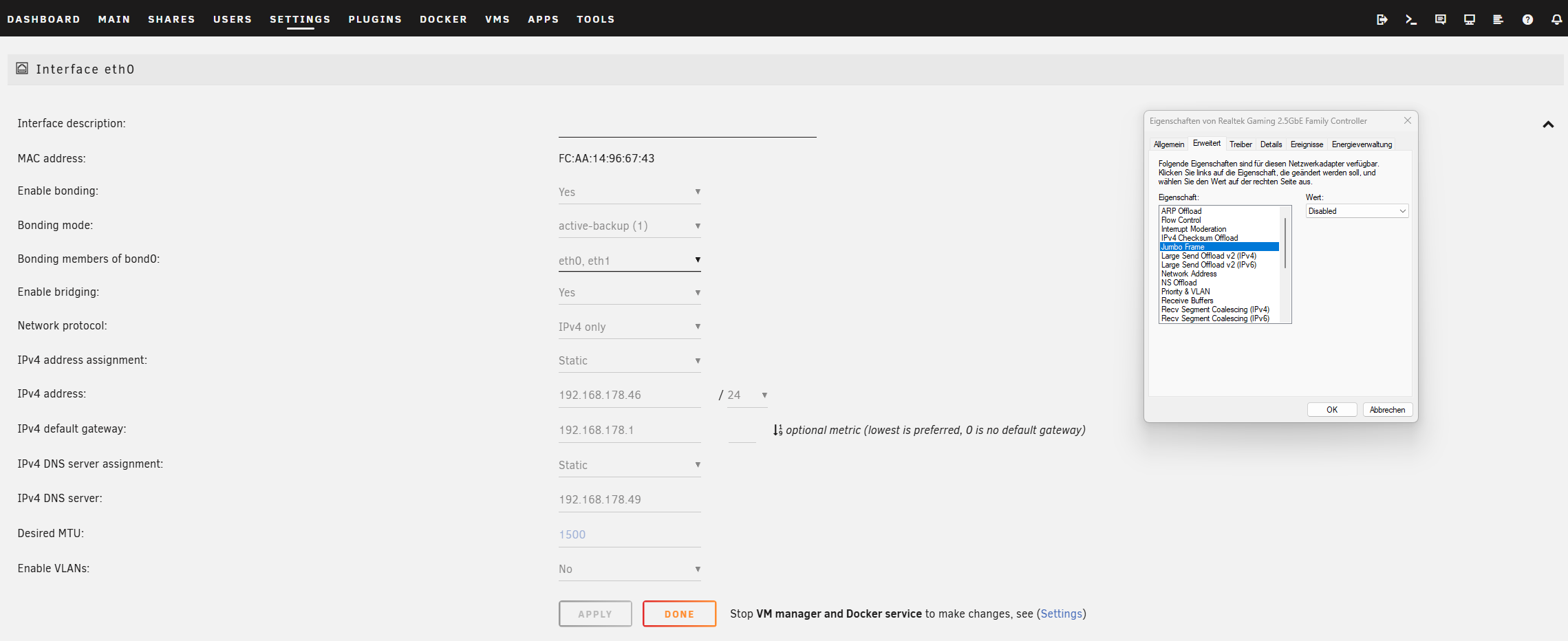

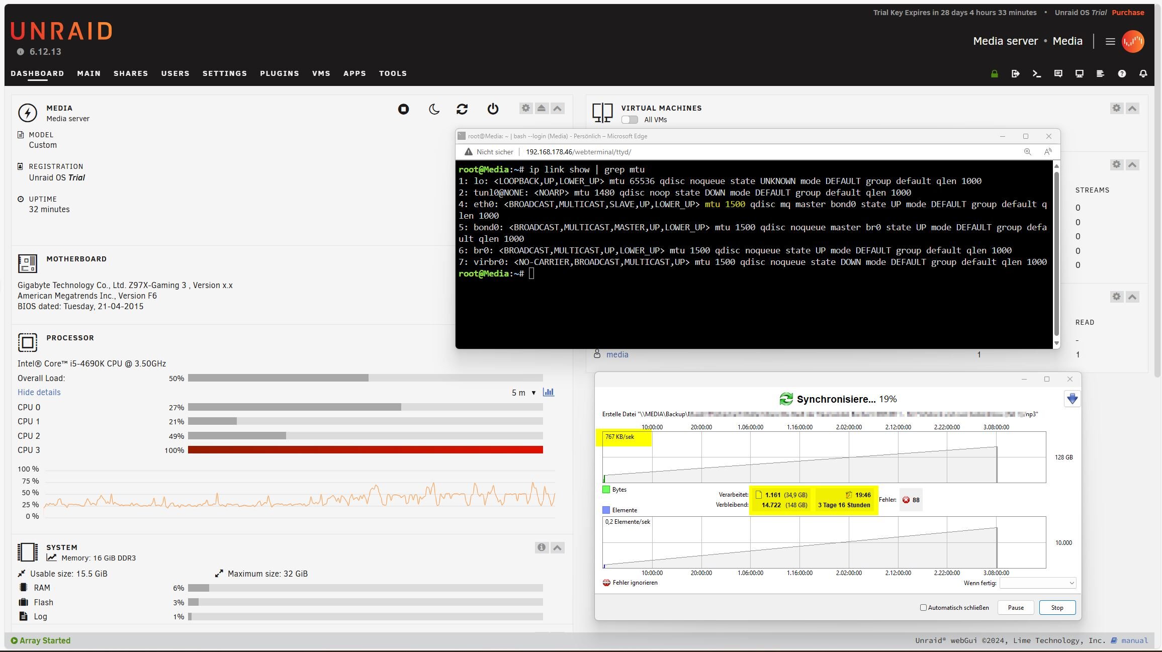

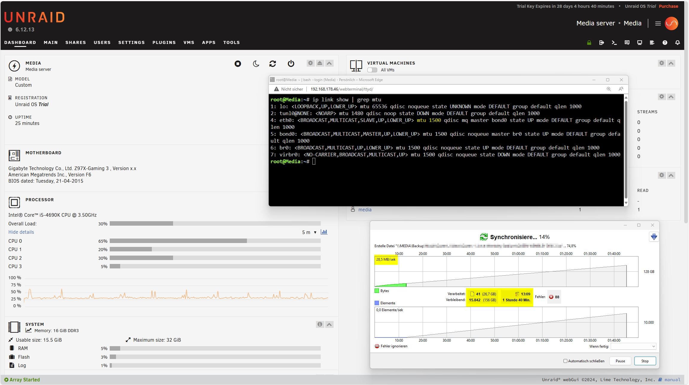

Turn off Jumbo frames on your NICs.  It is not necessary these days and offers no speed improvements.
I just checked, on my Windows 11 client, this option was not active. How to check if this is active on my homeserver?
This is in your log:
Sep 19 08:50:08 Media kernel: r8169 0000:05:00.0 eth1: RTL8125B, 00:e0:4c:01:2a:19, XID 641, IRQ 33
Sep 19 08:50:08 Media kernel: r8169 0000:05:00.0 eth1: jumbo features [frames: 9194 bytes, tx checksumming: ko]
I don't have any Realtek NICs, so I can't tell you how to fix this.
Ok, tested the following:
- re-checked Jumbo package setting on the Realtek LAN on my Windows 11 client (activated and deactivated again)
- removed the 2nd Realtek LAN card (2.5GBit) from server (currently not used)
- rebooted the server & windows 11 client

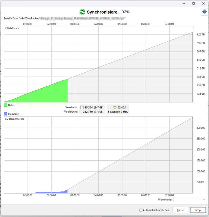

First 13min looked promising (~20MB/sec) but then shortly after, it droped again :(
See screenshots and new diagnosys...

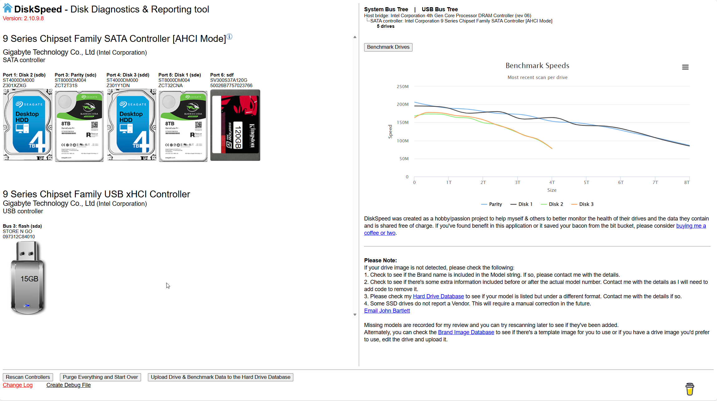

Install this and run the benchmarks, both drive and controller.
The result looks normal for me. Find it attached. Then benchmark finished without any issue. I also made a screenshot of the CPU load during the benchmark.
Thank you for any tipps.

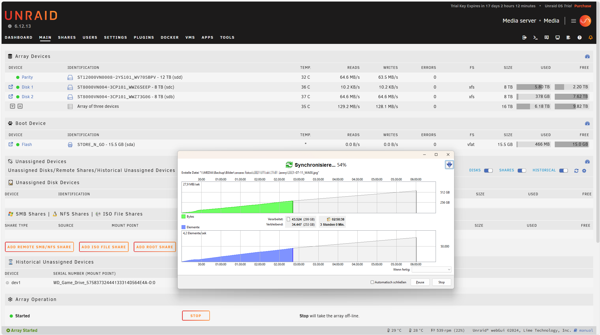

Sadly this is still a mystery for me. I still have this issue! The copy speed constantly drops when the CPU load hits 100%. I started copying 3,7 TB from external HDD which is attached to my unraid server. There is no other operation on the server (it just runs the docker Cloud Commander for copying). The server currently runs 24h/7d to finish this job (I'm still trying to fill my array with my data). If I'm lucky I get transfered 200 GB per day!
If anybody has any further advise how to check what exactly is causing this high CPU load, I would be very happy!
Thanks in advance!

CPU load is likely due to i/o wait, I do see you have SMR disks, and that is likely the reason for the slowdown during writes.
